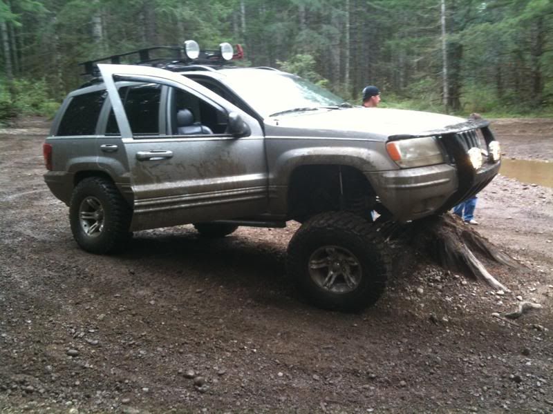

This is what happens when you flex too much. Light rub with 31's, I came off the gas when I heard the tire grinding against metal.
If I had 35's and not enough lift/trim/bumpstopping done the whole quarterpanel would have shredded. 33's would have probably done the same in that spot.

thanks to fraserbrown and kramerh!!!! the picture is exactly what i am afraid of. bumpstops go inside the spring. right? i did some looking at them and am willing to do that to get 35' on there. again 3.5 lift. what size bumpstops? and is this measurement in addition to stock bumpstops(that i have) or in place of overall height?

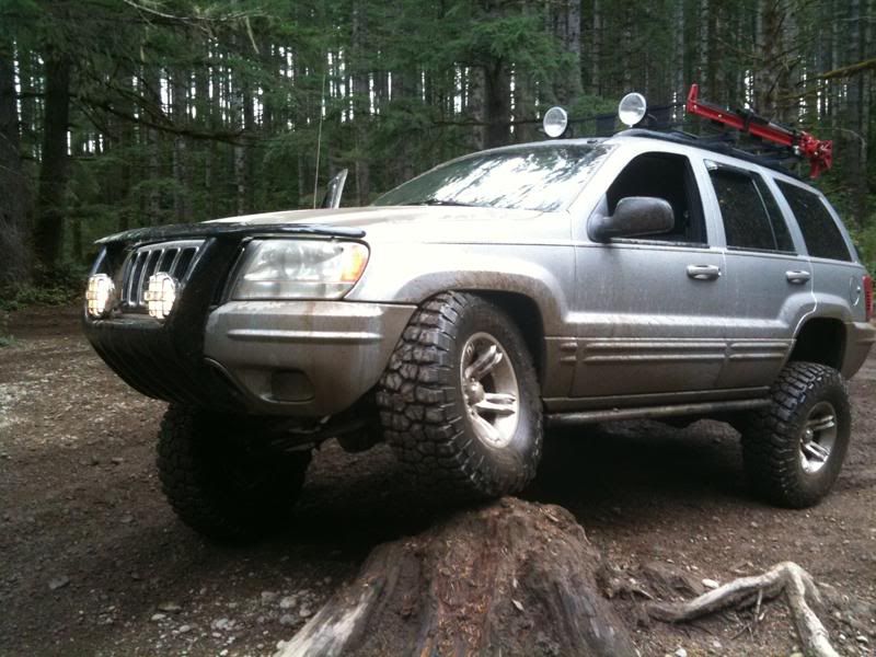

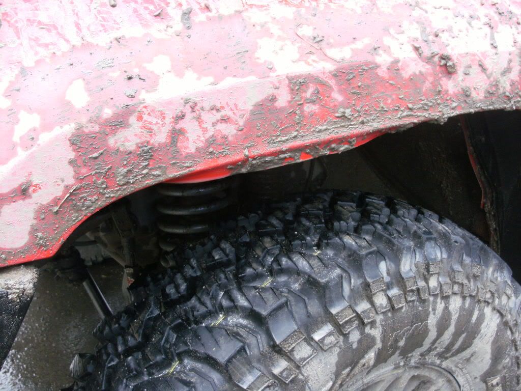

ronsaun, im telling you man, by reading your other post your looking to get good gas mileage and wanting 35's on 3.5 inches of lift, its an oxymoron haha. you could probably get away with some 33 10.50's but once again, you hit a curb and get any flex its going to bend the sheet metal like it did on mine and fraser's rigs. arlo is an 6" with long arms and is running 35's, just to put it in perspective.. here i am at 6" (spring and spacer) and i creased my fender due to bump stops being too short.
other side
