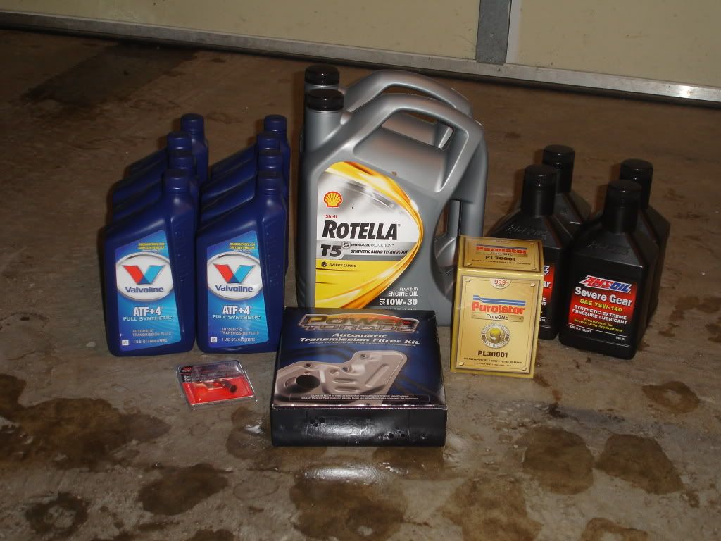

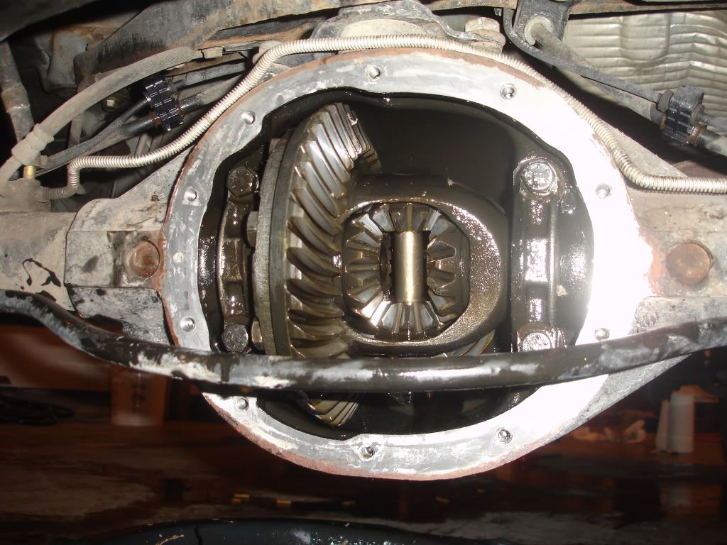

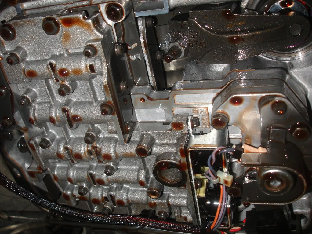

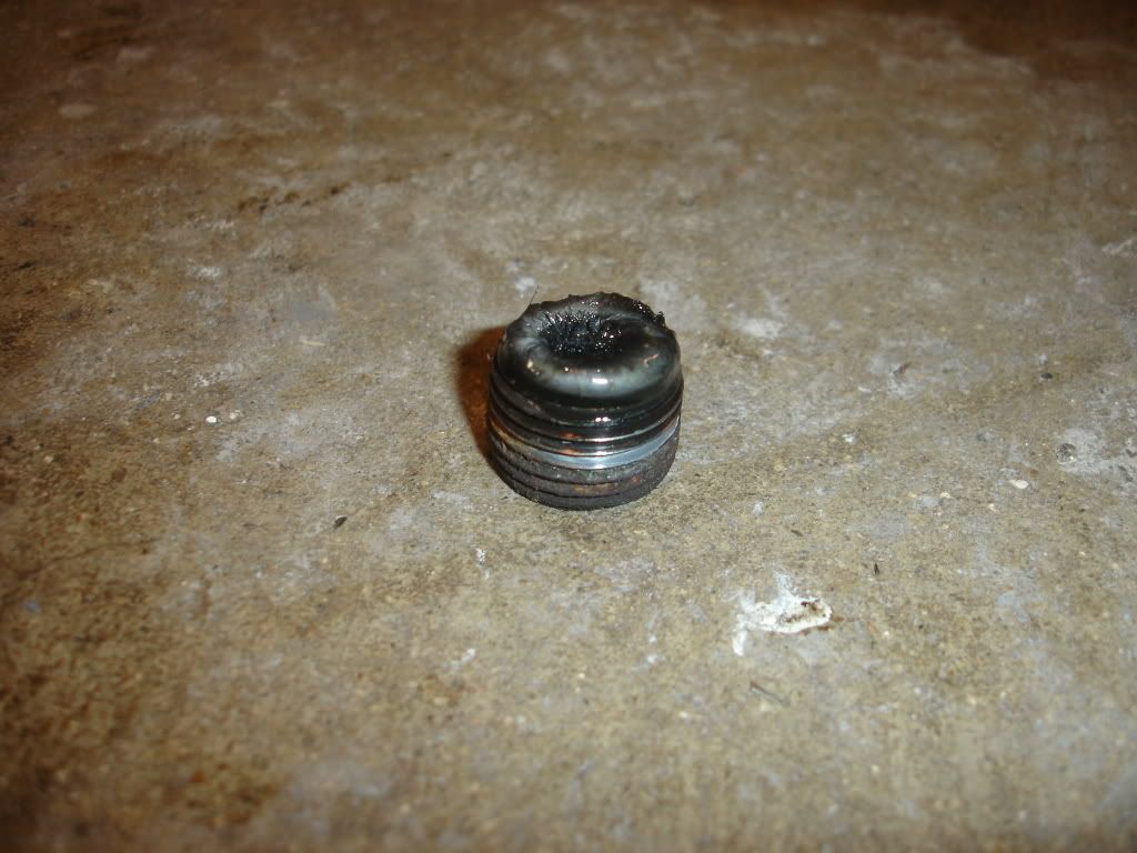

I recently changed all of my fluids. Everything turned out pretty good for over 90K on the clock and no record of any changes by the previous owner (apart from engine oil).
Dana 30 and the shavings on the magnet:
Dana 35C and the cover/magnet:

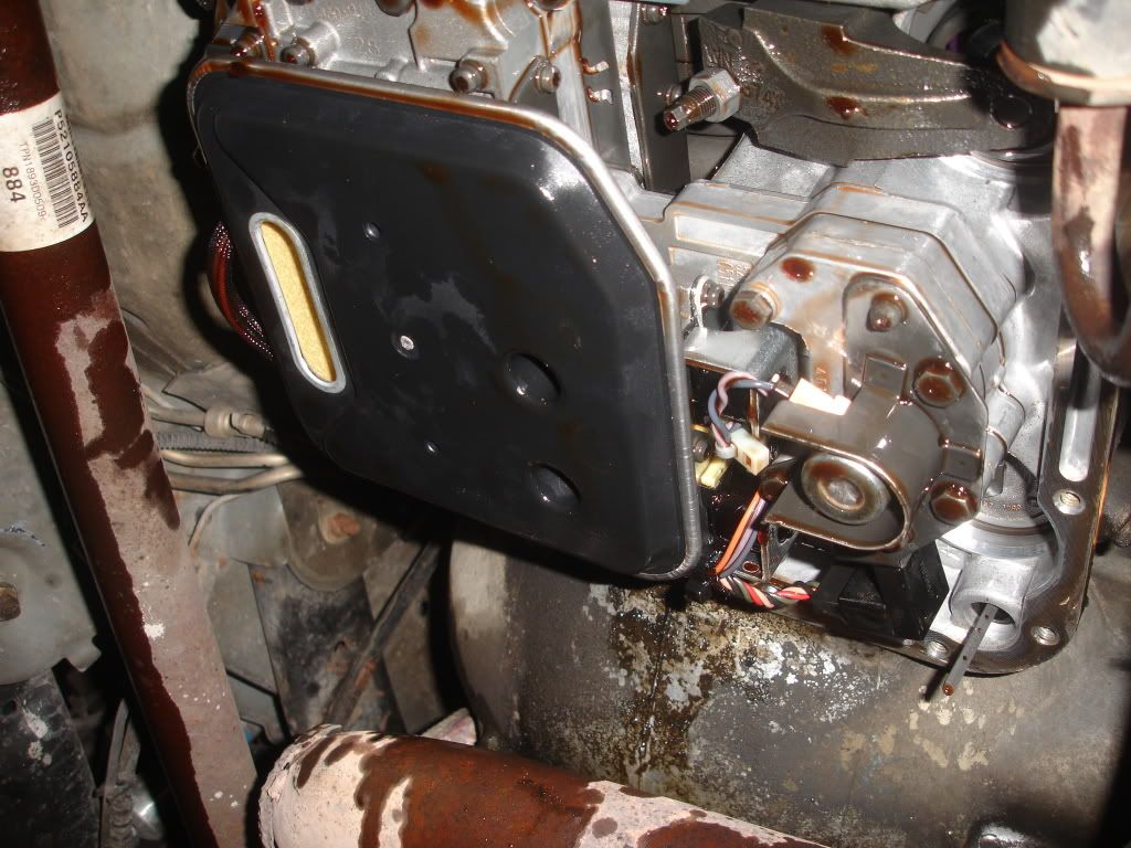

Transmission (42RE) without/with filter:
I changed the Transfer Case (242) fluid as well. Overall, changing all of the fluids really wasn't a bad project for those considering doing this on a Saturday afternoon. As long as you have some basic tools, doing it yourself can save you quite a bit of money.
Also, I'm going to note that the transmission fluid had never been changed. While it looked pretty good, I worry about throwing new fluid in, the new fluid breaking loose some gunk, and that gunk clogging the filter reducing the life of the transmission. Some people argue whether you should flush a transmission, change the fluid/filter, or just leave it be. I've decided to prevent any possible damage from a clogged filter by doing multiple changes over a short amount of time. For the first change, I bought a filter from O'Reilly Auto. In about 5k miles, I'm going to change the filter and fluid again, probably using another O'Reilly filter. The third time I change it, I'll pick up a dealer filter. By doing 3 changes spanned over 10-15k miles, I'll slowly replace the old fluid, catch the gunk in the new filter, and change the filter out before it clogs and prevents adequate fluid flow. I figure a few fluid changes now is cheaper than a new transmission later.

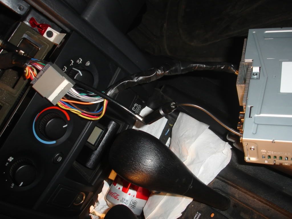

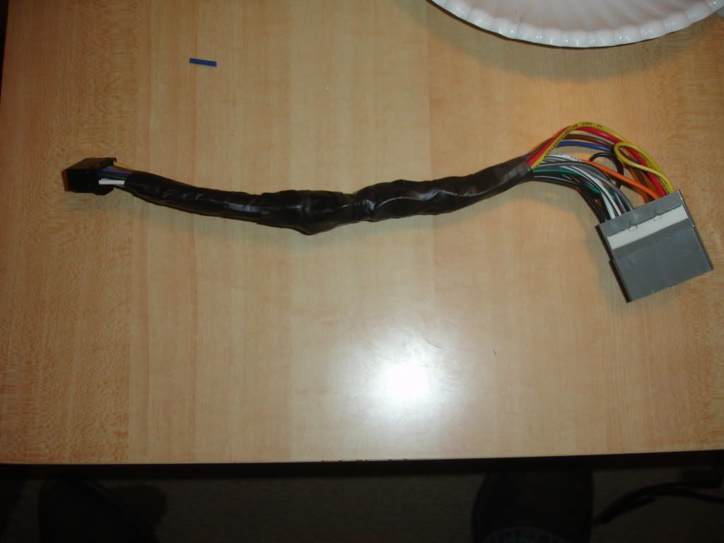

Kenwood KDC-348U CD Player Install
Here is a quick tid-bit on installing a CD Player the proper way. I chose Kenwood and ordered the wiring harness and antenna adapter from Crutchfield - excellent products, fair prices.

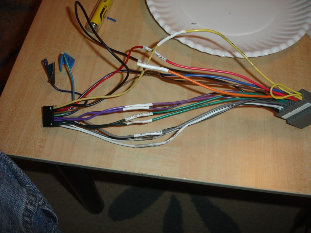

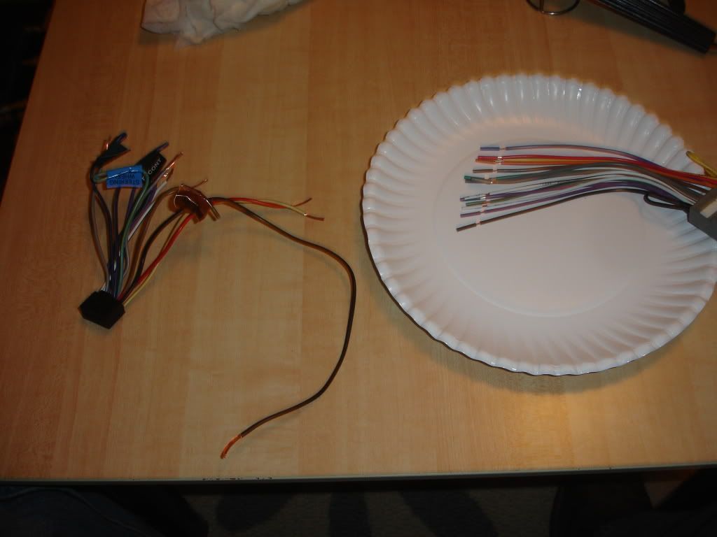

Here is a picture of the harness that came with the CD player (left) and the harness from Crutchfield (right):
The paper plate was used is an attempt to keep solder off the coffee table. I figured making the effort would help keep my fiance happy...

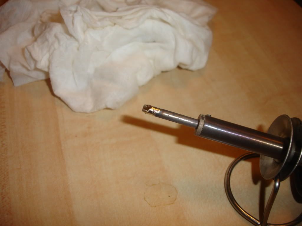

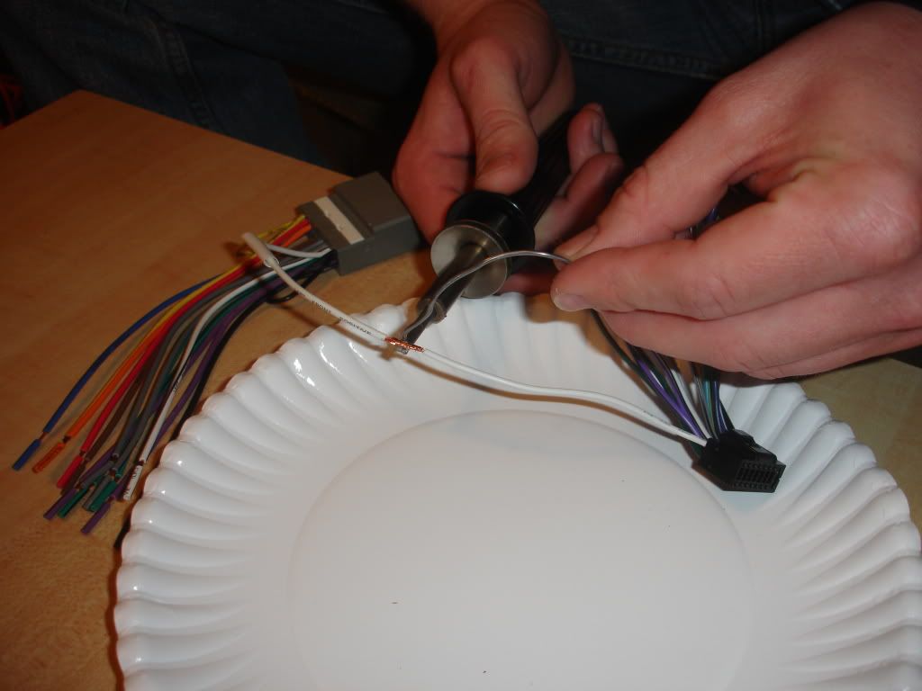

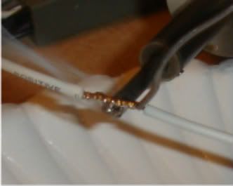

The CD player came with an instruction booklet that contained a wiring diagram. Crutchfield's wiring harness actually came with the wires labeled. It was extremely simple to match up the diagram with the labeled wires. Also, it turned out that the wiring colors matched up pretty closely as well.

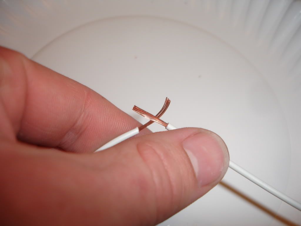

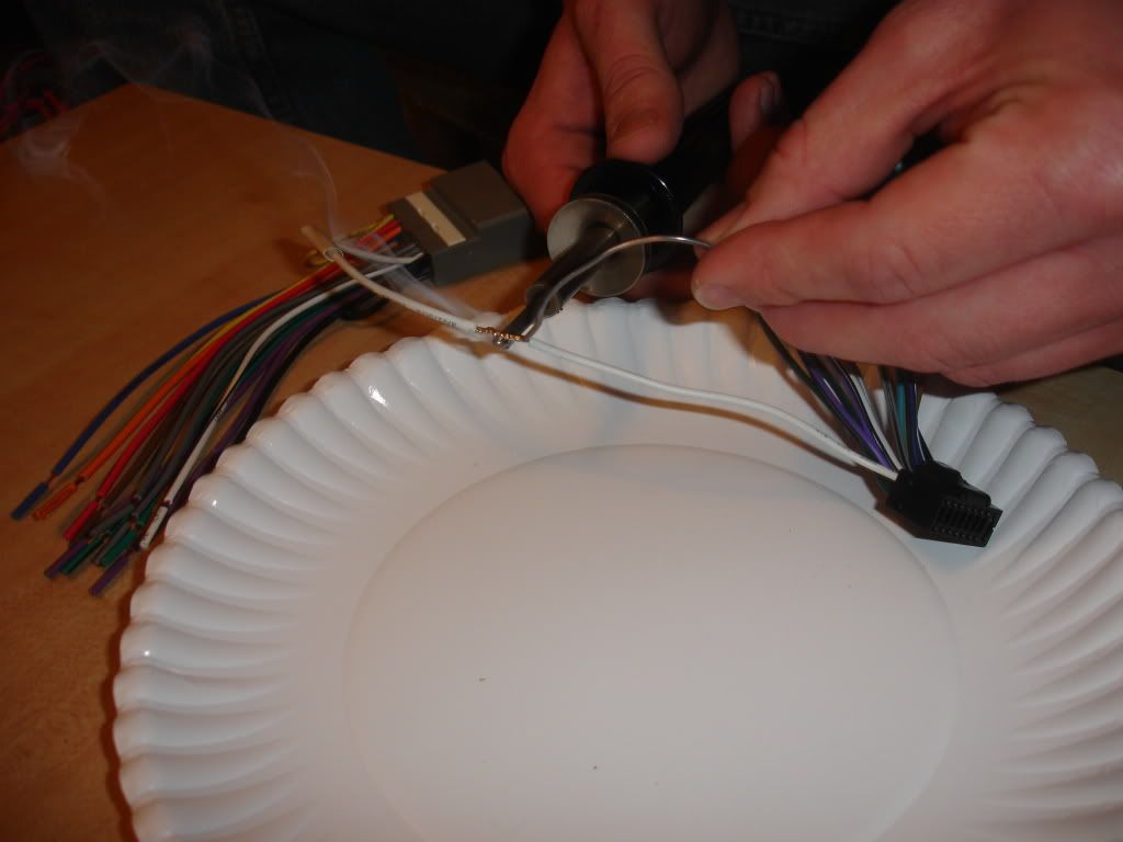

To solder properly, heat up your soldering iron and add a bit of solder to the tip. Dab off any extra on a damp cloth or sponge. The idea is you want to keep the tip shiny.
First, slide some heat shrink tubing onto one of the wires then cross the two wires at about 45 and twist them in opposite direction over themselves:

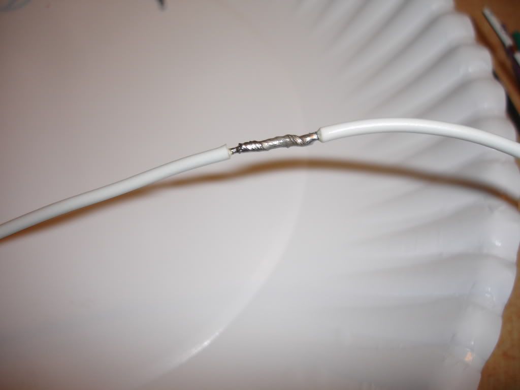

It should turn out looking something like this, which is actually a decently strong bond as it is:

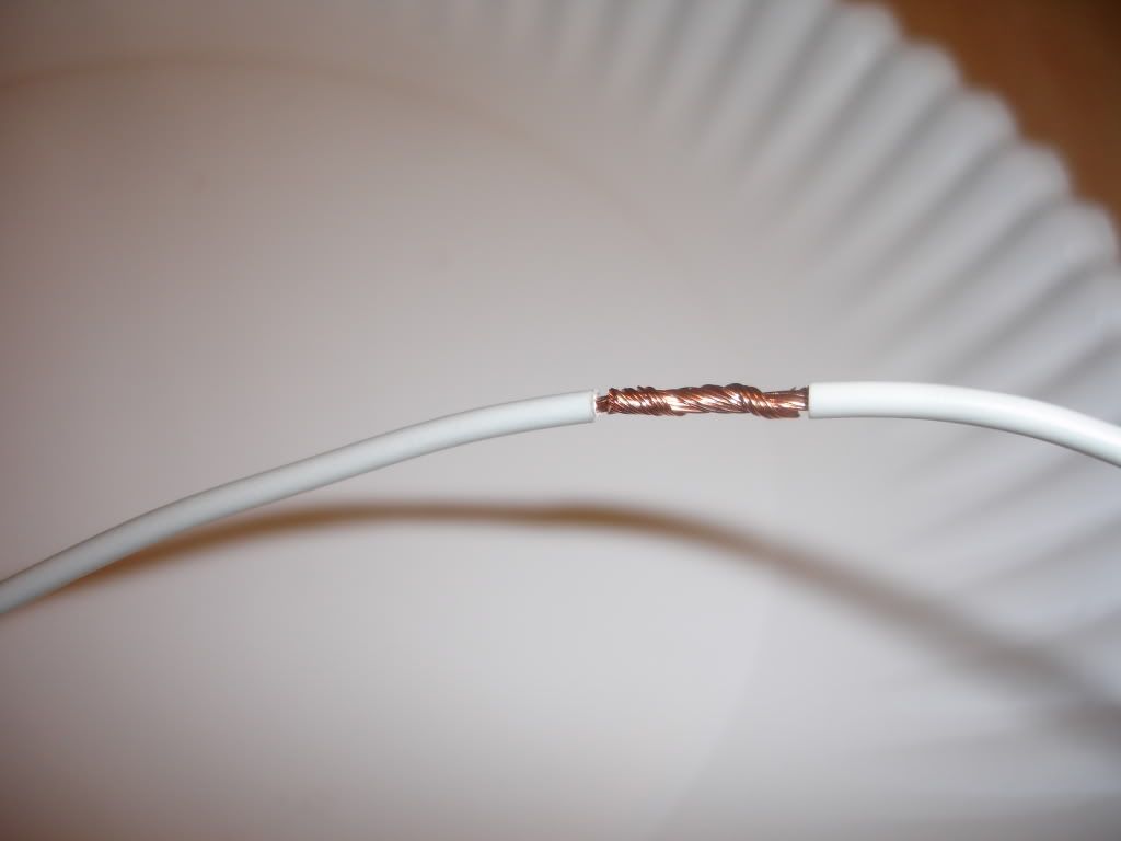

Next, solder away! Haha. It is actually just about that easy. What I did was I put the soldering iron tip on the bottom of the wires and started heating them a little. I dabbed my solder on the tip of the soldering iron until the solder started to seep into the wire. Once I saw that happening, I knew the wires were hot so I quickly dabbed the solder against the top of the wires while still applying heat. You want to act quick just so you don't melt the wire casing. Sure, you may accidentally curl the casing a little but try to avoid heating the wire so much that the casing actually melts. After a few wires, you should get the hang of it.
Here's a closeup of the last pic. Sorry it's so blurry:

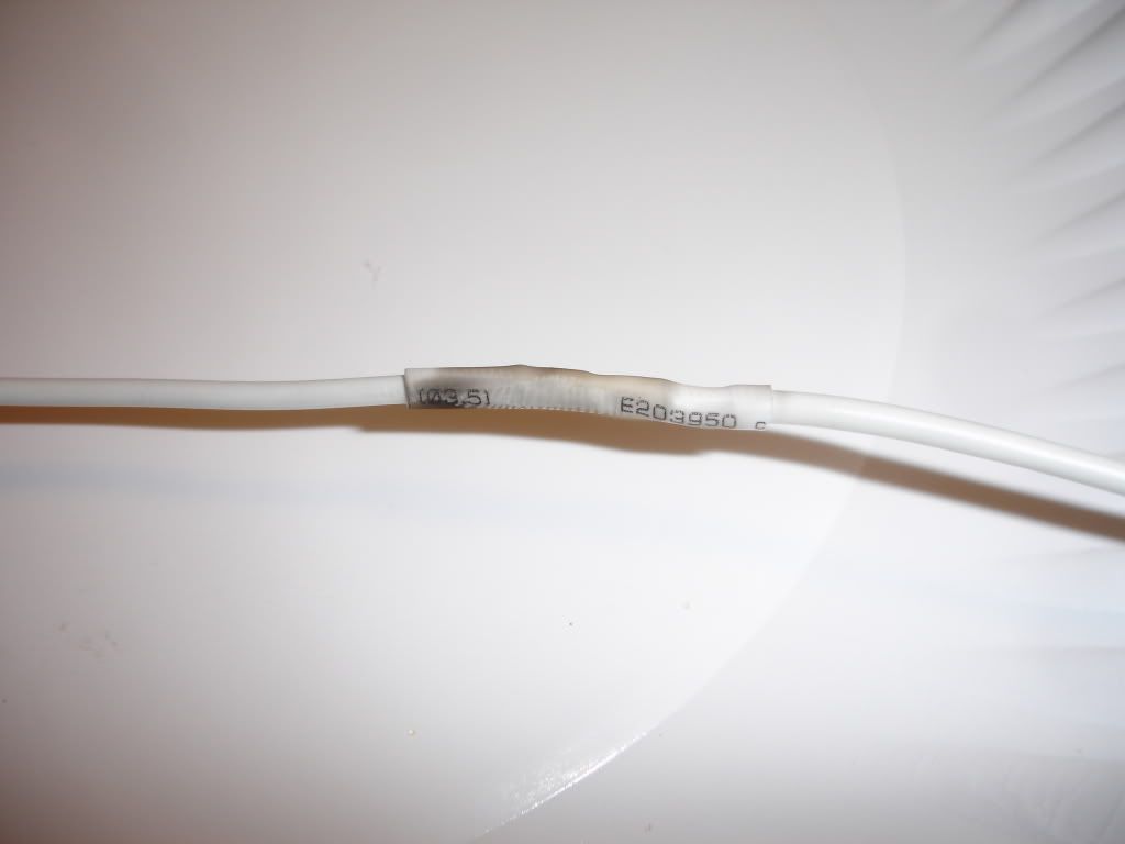

And the finished solder:

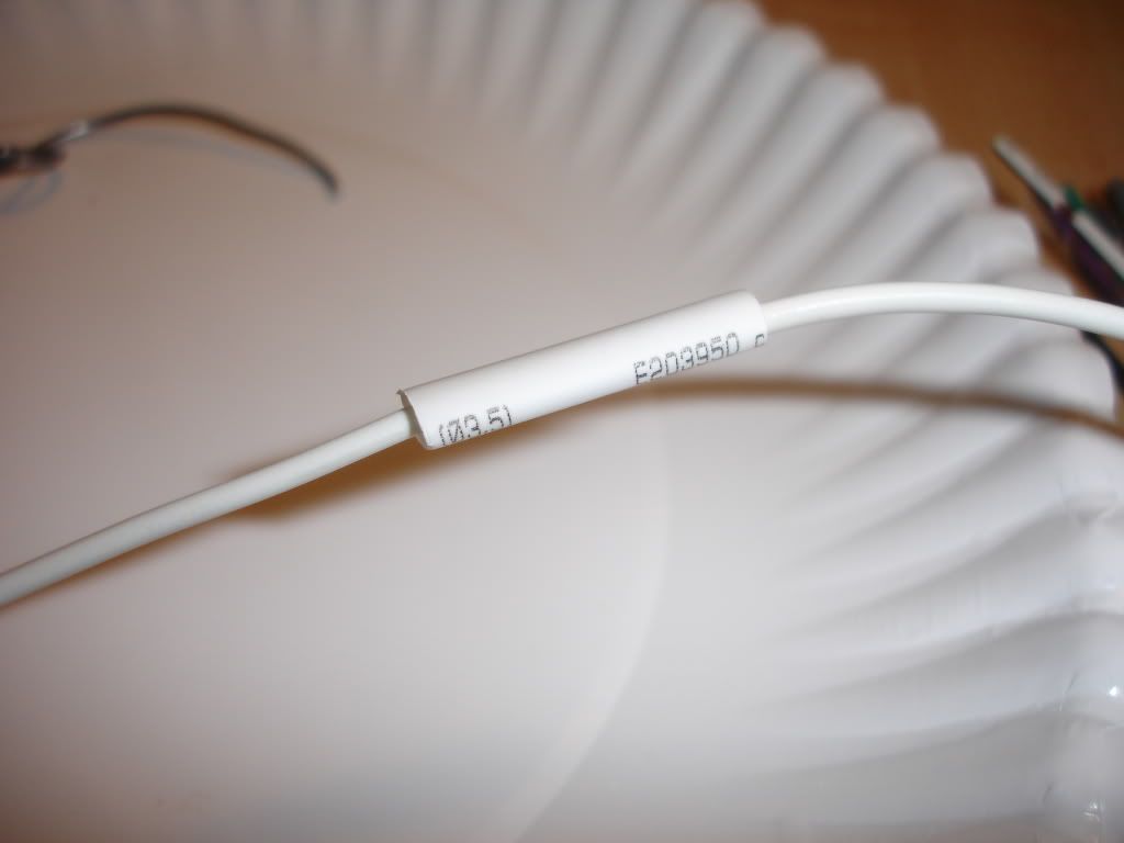

Now you can slide your heat shrink over the solder and heat it up.
I used a lighter and got a little too close on this one, hence the charred look.
And here is the harness all soldered up:
I couldn't find my nice little zip ties so I used some 33. I hate doing that but I wanted my soldered harness to be secure:
Finally, here is the new harness and the antenna adapter connecting the factory setup to the new cd player:
And the finished product:

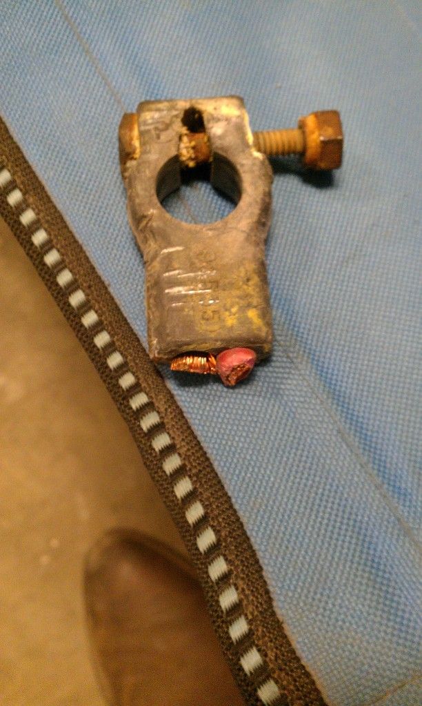

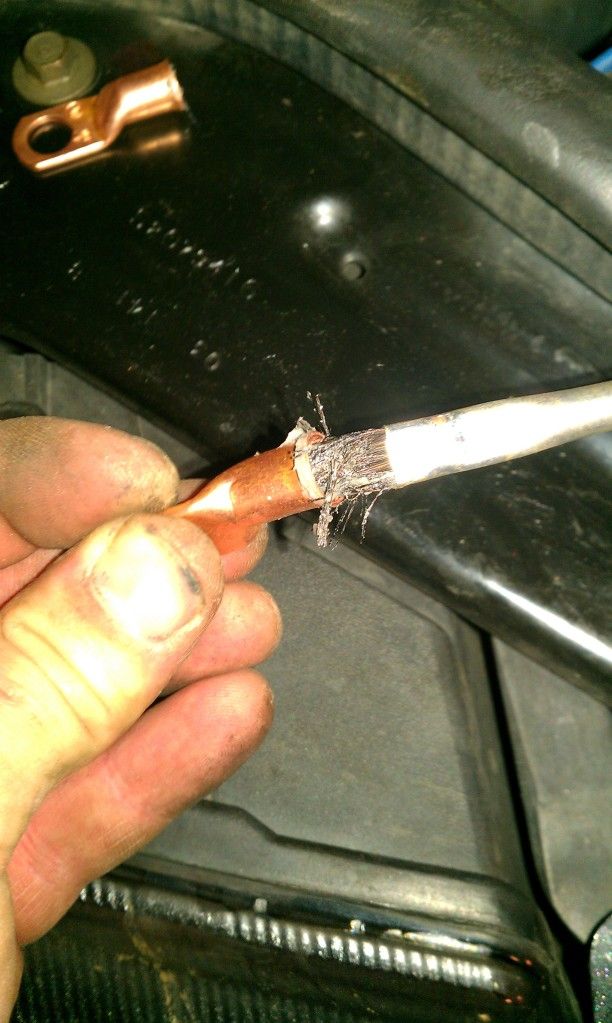

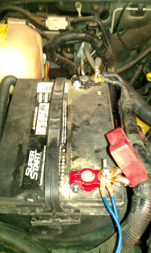

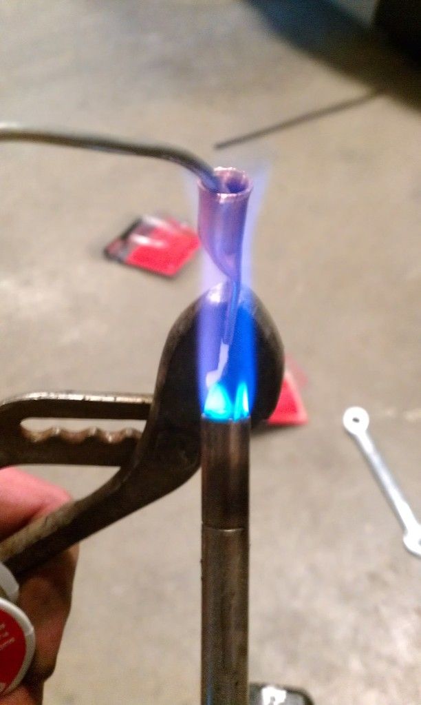

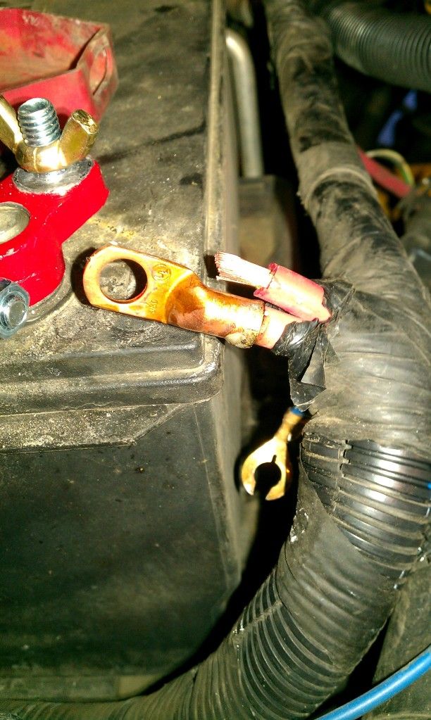

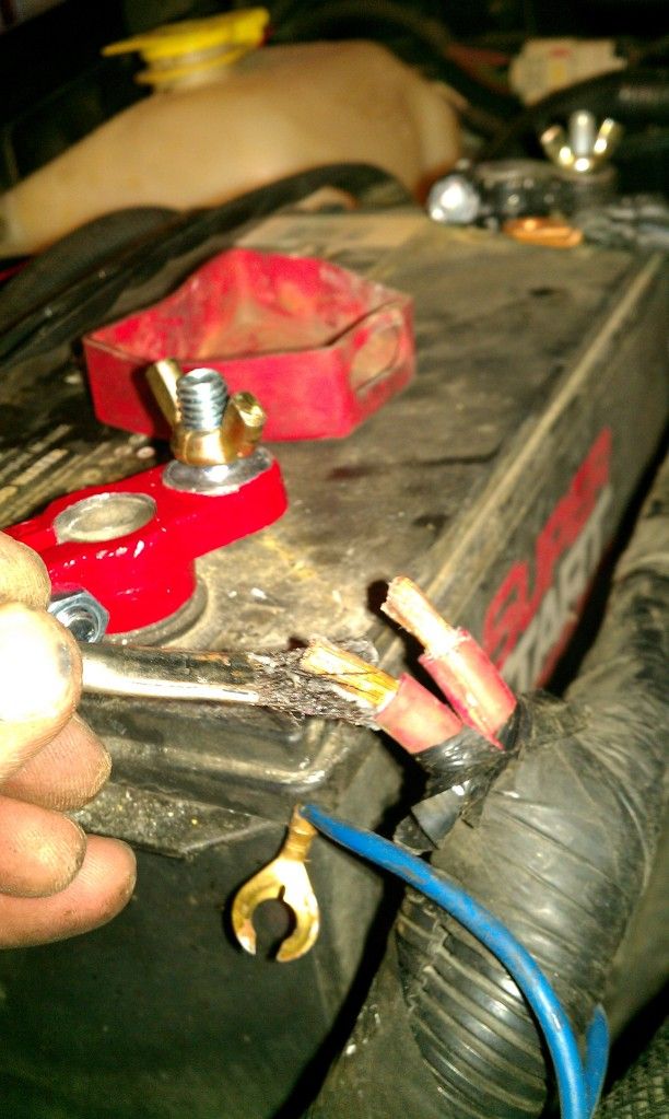

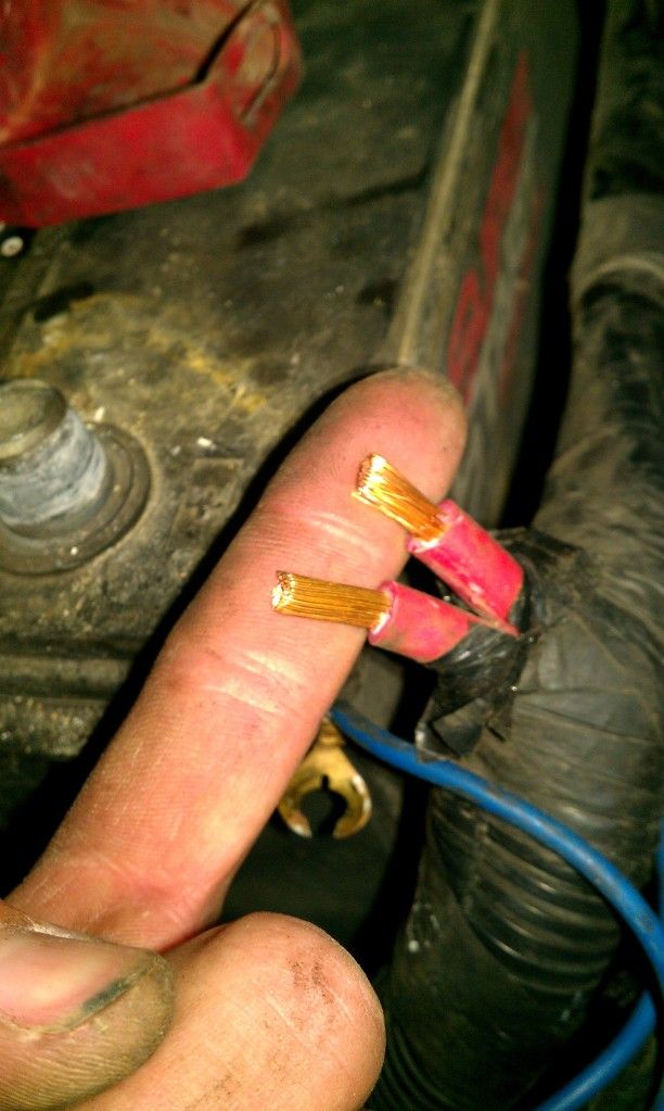

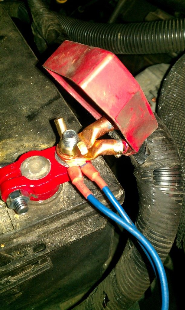

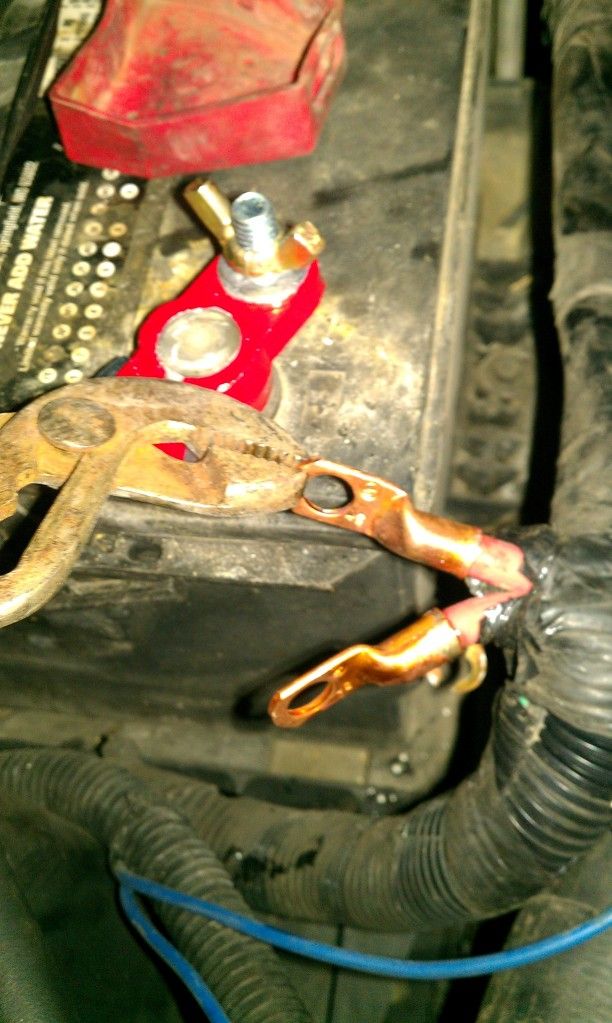

I finally got around to finishing the battery terminals. I started this process a long time ago. I replaced the negative side and realized I grabbed the wrong size battery cable lugs for the positive side. By the time I grabbed the correct size for the positive side, other projects had developed.
I snapped pictures as I always do and since there have been a lot of questions recently about how to do this, I figured I'd show you how I go about it:
First of all, I bought these from O'Reilly Auto Parts:
4 - 6 gauge with 3/8" Stud Hole - $3.29 per box of 2
Marine Battery Terminals - 5/16" Negative Stud and 3/8" Positive Stud - $5.49 for the set
For the negative side, I used solder lugs which can be a pain to find and wasn't much easier than the method I used for the positive side. The following method I used for installing the positive side works pretty well...
Alright, clearly, you need to chop off the old terminal. I cut it close to allow myself extra wire to work with:
Next, trim back the covering on the wires. I trimmed them back probably about 3/8" to 1/2":
Once trimmed, I applied flux to the bare copper:
I cleaned the inside of the lugs with a copper tube fitting brush (circular wire brush) and then fluxed the inside of the lugs:
Now would be a good time to slip some heat shrink over the wires...
Here's where it gets tricky without a spare set of hands (especially when trying to take a picture as well. You'll want to work quickly but if you end up moving too slow, you can fix any issues that arise.
Hold the copper lug with a pair of pliers. Heat the bottom of the 'bowl' with a torch and hold solder inside of the lug. I held it until the solder melted and almost filled the lug:
Now that the lug is full, you'll need to heat the wire. Do this gently. You don't want to be torching everything under the hood. You also don't want to melt the casing on the wire. The best method I've found (because you need to keep the lug hot as well) is to heat the wire while also holding the lug (with the pliers) at the edge of the flame. Once the wire is heated (and the solder in the lug is in liquid form), bend the wire down and cram it into the lug (wire down, 'bowl' of the lug up as to not spill out the solder). Hold it here for 30 seconds or so:
As you can see, I don't have heat shrink on my wires. I didn't have the correct size on hand. Fortunately, the lugs aren't too large so I can slip some over the top and heat shrink it down as soon as I pick some more up.
Slip the cover back over the wires and install:
Installing lugs in this fashion ensures a solid connection. The heat shrink (yeah, yeah, still have to finish the positive side) helps seal the connection from the elements.
I've done my fair share of soldering and have dabbled a bit in copper plumbing work. For me, this took me between 15 - 30 minutes for one side including taking pictures. I could easily do all 4 lugs in under an hour (assuming all parts were pre-purchased). For someone new to soldering, it's quite simple. If the solder hardens up on you once it's in the lug, simply re-heat it. All in all, a 'newbie' should be able to do this in a couple hours.
Hope this helps!
