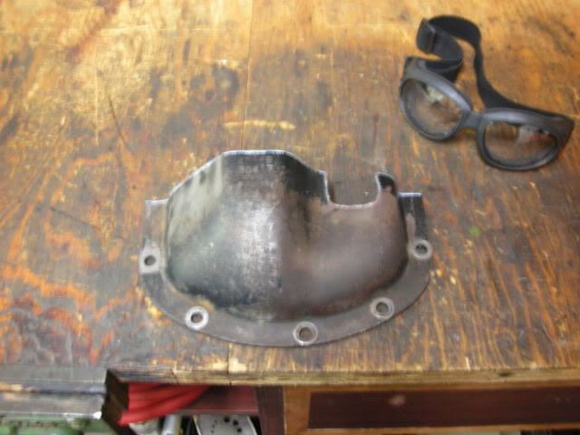

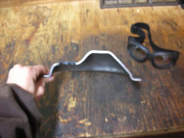

so you take the band saw and cut it just above the fill plug(5" front bottom of cover) then remove a U around the plug bung(i used plasma for that)
as you can see its fairly thick
then to space it out from the diff itself weld the nuts to your skid and bore out the threads with drill and slap a coat of rustoleum on there and its ready to go

ok i know its a little delayed but this has been by far one of the weirdest winters we've had here in a long time and its been down right miserable cold wet and windy but today was sorta nice so i figured id get this thing together and heres what the finished product looked like
bolts- 5/16x1 1 1/4" w/ flat and lock washers
overall im happy with it and it sits maybe a 1/4" away from the actual diff cover and like i said earlier i know its no comparison to a HD cover but its not ment to be as i dont see the need in spending that kind of money on a diff i can replace for the same cost this was built for the guy with a budget in mind and it will serve its purpose
