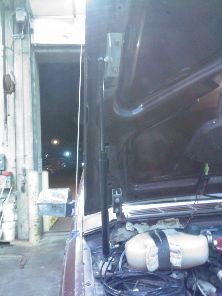

Finally got back to one of the early projects, got an old hatch strut set up on the hood. Much better.

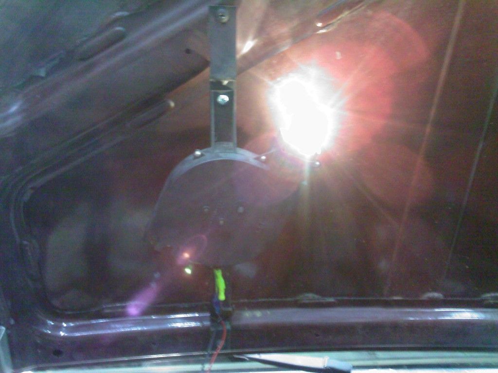

The underhood light got snarled probably a year ago, so I took it out. Last night I drilled out the rivets, un-snarled it and bolted it back together with #4 bolts. Had to re-wire the ground to get it working right.

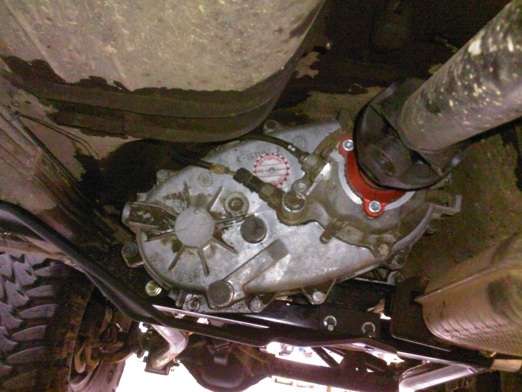

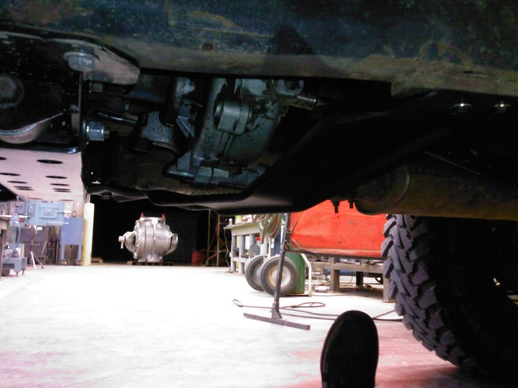

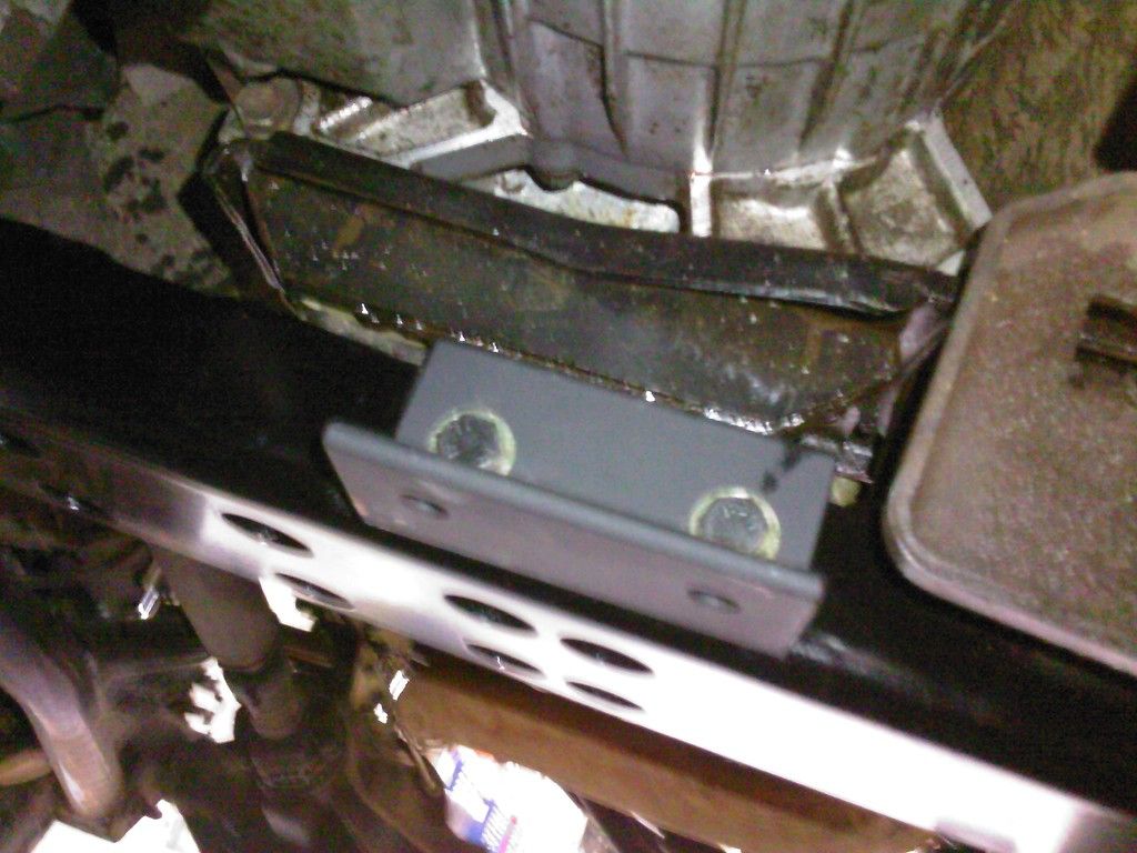

When I installed my lomngarms I lost the t-case skid as there was no place on the crossmember to attach it to. So, this...
2"X2"X1/4" angle. Drilled & tapped 3/8" holes in the IRO crossmember, bolted angle to it & bolted skid to the angle. A little hard to see, but at I feel much better about the t-case living through the next rock-garden.
