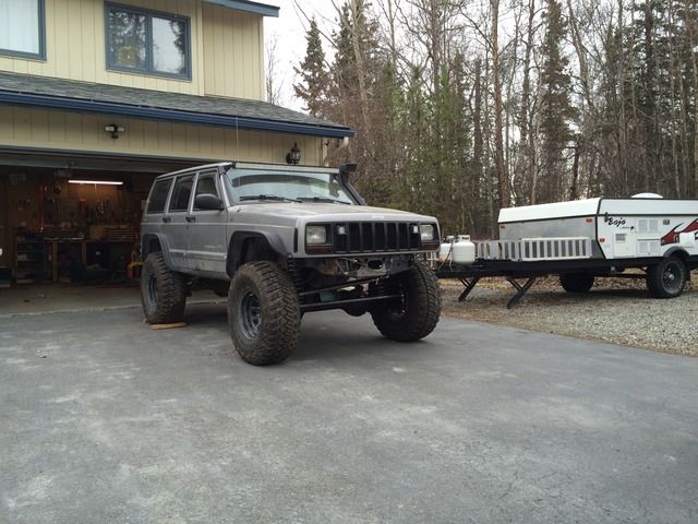

Rolled the jeep out of the garage! I would have installed the drivelines but I screwed up and bought a yoke with ubolts and that won't work with my double cardan driveshaft.

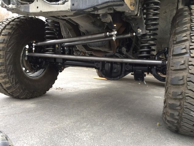

Here is the final rundown on the steering setup:
The trackbar came out to 31.5" and the drag link is 33.5". I used a ruffstuff lower trackbar mount and a Barnes4WD upper trackbar mount. For the drag link I used a stock pitman arm and a modified BTF "hi-steer" mount.

That looks really clean and solid.

1. I need to pay more attention to your build in general.
2. What the heck is hanging off the drivers side LCA mount?
