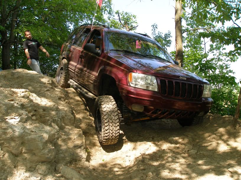

Also obligatory pics of old WJ and current FR-S
