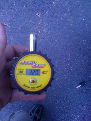

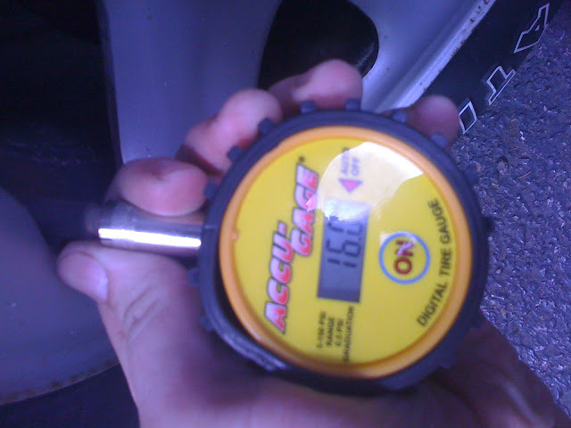

OK I tested a tire fillup straight from the compressor.
The air down took longer than the air up. I had to hook the chuck to the tire and connect my male to male adapter to the end to let air out. I have never had to air down before, so I it took me a minute to figure out how to do it.
Got it down to 16, I thought that was close enough.
Hooked it up, timed 1:30. I figured that would be close enough. REsulting pressure, 32psi.
so 16-32 psi in 1:30 isn't bad for the price. The compressor was a little warm, VERY far from hot.. it just wasn't cold. The hose at the output of the compressor was warmer though. That is expected, all the air friction from compressing.
The gauge on the compressor seems to read 5-6 psi low. Hence the digital unit.

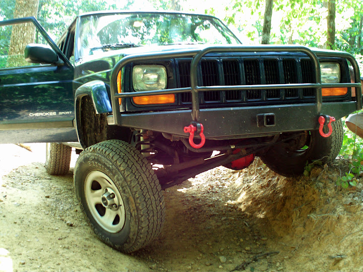

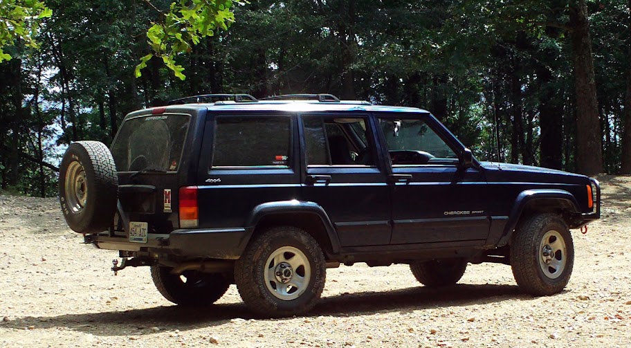

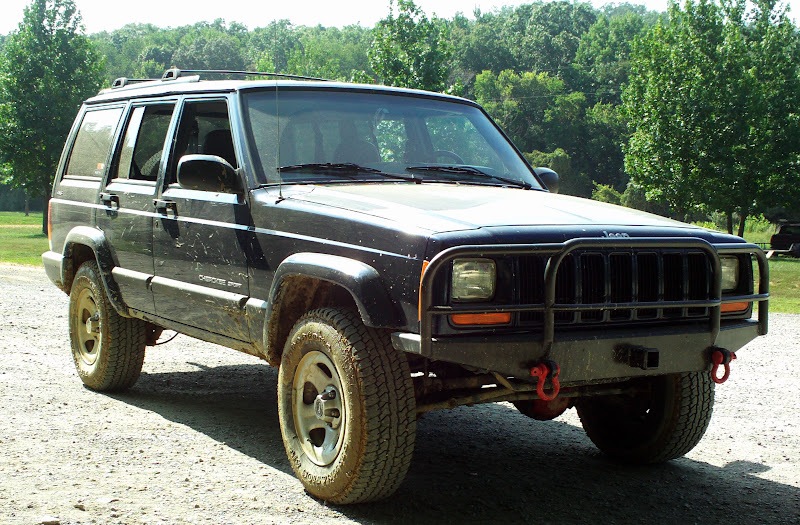

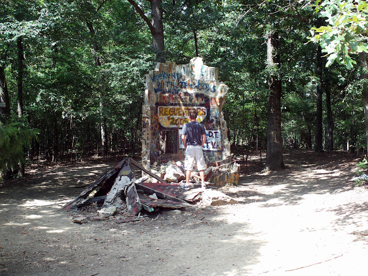

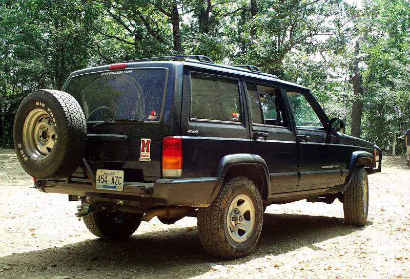

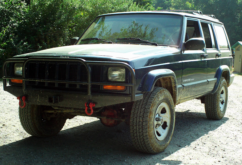

Oi! Went wheeling at Turkey Bay OHV park in Land Between the Lakes in western Kentucky.
Thought I should put some of the pictures up on here (didn't take many), and mention that as it goes for everyone else, now I want more lift and bigger tires even more. And a winch and a locker and some wheeling buddies too.
And a cool Jeep logo picture thing

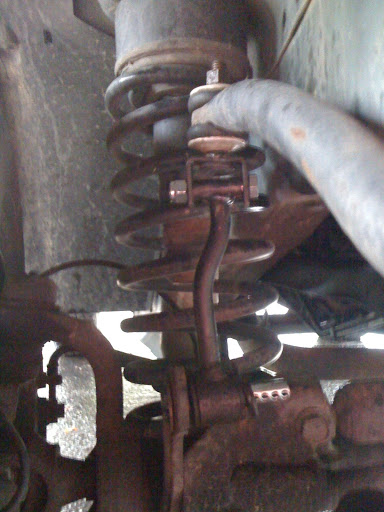

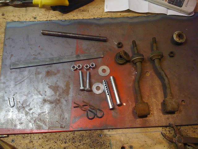

While my current disconnects work fine, and I have no complaints. Thanks to koolaid's poll however I was inspired to make my "2nd generation" quick disconnects. These use a larger clevis pin so it fits better, and fold up out of the way. All together I spent about 10$ on them.
First off, I must say that the sway bar mount hole is a tad bigger than 1/2" on mine. I was hoping it would be a bit closer to 1/2" but its like .51-.52". So the 1/2" clevis pin is still a TAD loose, but the thing still fits together better. I could weld the pins in (or bolt it on somehow) if I used a misalignment joint at the top, but It was a spur of the moment thing so I used what I had. The old ones didsn't make any noise I noticed anyway, so these should be even better.
Alright, I needed..
1/2"X 3" clevis pins (2.5" would work it seems)
some 7/16" washers (the 1/2" ones they have are too loose)
Some 1/2" tube (3/8" ID)
some 3/8" x 2" bolts
locknuts
Some flat bar (i had some .75"X.120" on hand, I would use 1"X.120" next time)
The hitch pin thingies for the clevis pins. You can use any style you want. I used the hair pin type.

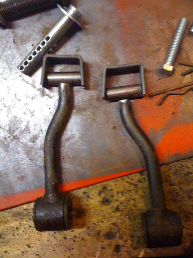

Take off your links and you have this:
Ok so I cut off the threaded ends of the links. I was using 2" long bolts so I needed 1.25" sleeves, so cut those out of the tube. The tube I had still had a seam, so I used a 3/8" bit to ream it off. Then I bent the flat bar into a 1.25x1" U. I was just using a vise, and the jaw width of it was closer to 1.5", so making a U that small was.. complicated. Next time I would make it 1.5" so its easier.
This is how it lays out.
The ends cut off will stick up through the U's. So you need a 10mm hole (7/16" works for us with only SAE bits) in the middle, and 2 3/8" holes in the ends... do that.. Weld the sleeve on the end of the link, weld the threaded end into the U, and bolt it all together.
Bolts up no problem
This extends the link about a half inch btw. Could be longer depending on the U you make. If I was making it for a 3" or more lift I would either weld some rod between the link and sleeve, or use some tube with the same ID as the link to extend it to the desired length. I just have a 2" spacer lift, and I am still broke so ill lengthen it when I get the $$$ to lift it more.
TADA! now I can disconnect it and fold the link up out of the way. I guess a small bungee cord can hold it up?

You should weld the clevis pin to the bracket. I made similar ones for my TJ and used the tightest fitting clevis pin I could find and it worked itself loose a few days later. It would rattle and clunk like mad. When someone jumped on the bumper I could see it move up and down with so much slack.
Cool design though.
