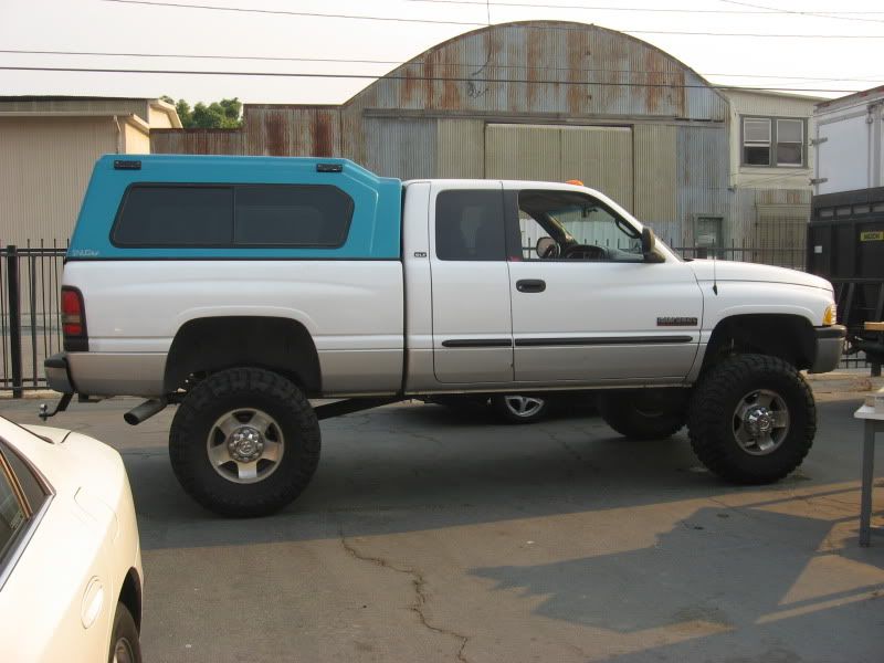

Nice Truck! I have pretty much the same truck, 2001 2500 4x4, I got a bd x-monitor for the guages, and a mag-hytec deep trans pan so far, not really going to go any further, maybe upgrade the lift pump. I got great mileage with 35"s but when I switched to 37"s it went down considerably, next set of tires will be 35"s again unless I find a hp dana 60 and regear. Congrats! I will never own any diesel but a Cummins! edit: and painting the camper shell, got it and a carpet kit for $250 off craigslist
