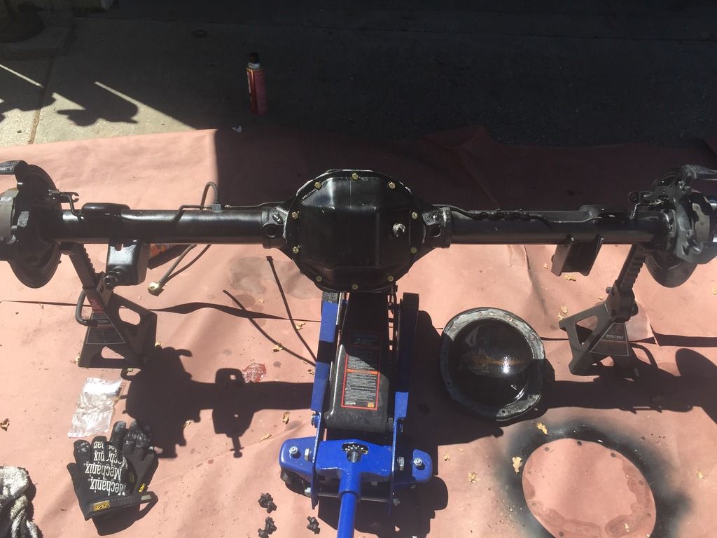

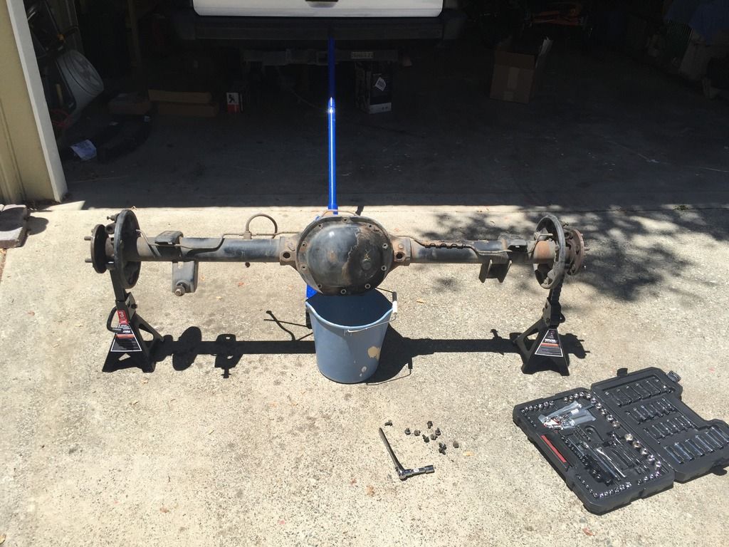

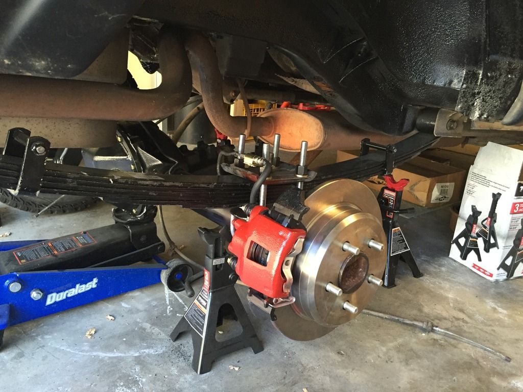

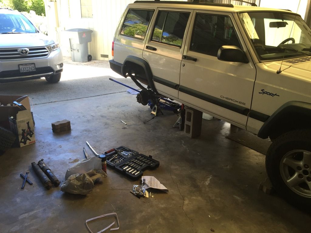

Started with pulling apart the rear end.
Took axle out to freshen up.
Pulled shafts/cleaned inside of housing. Installed new wheel studs for disk conversion. Installed new backing plates. Protecting with Ruff Stuff cover (highly recommended).
Back inside jeep.
It's Not Just a Jeep, It's a Lifestyle

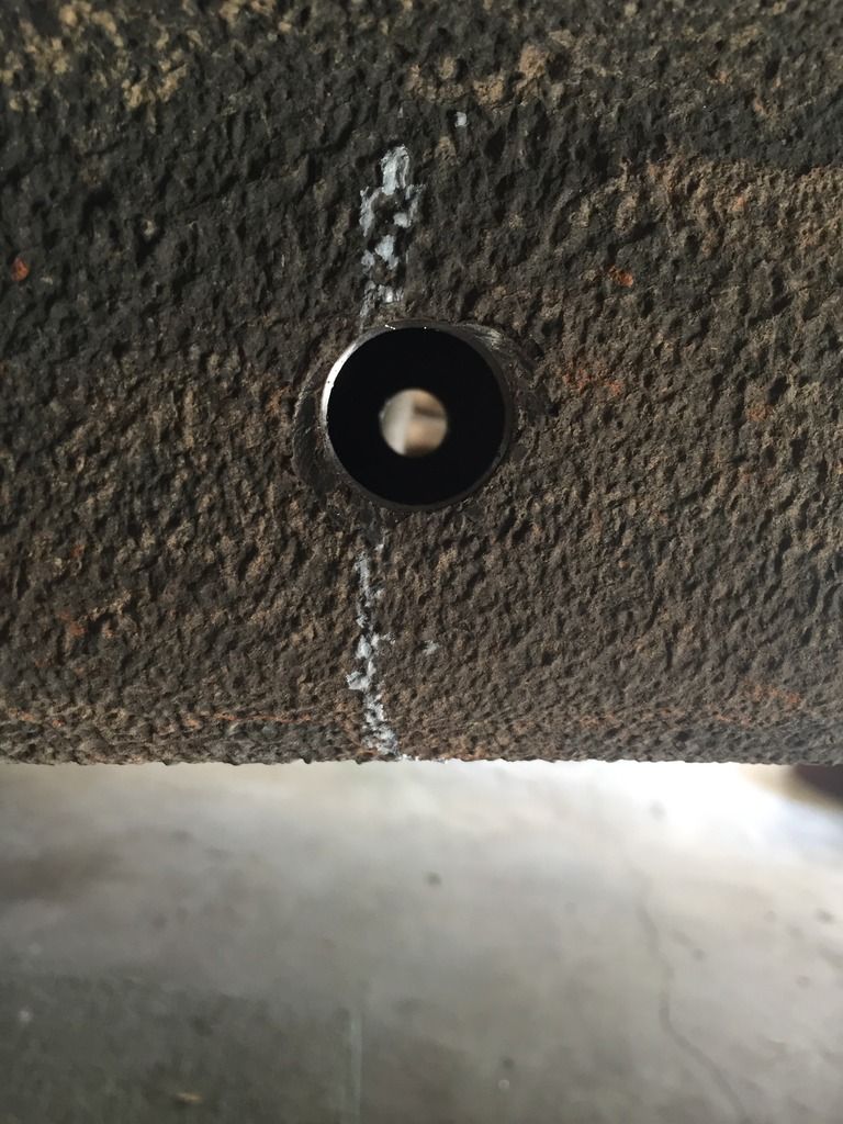

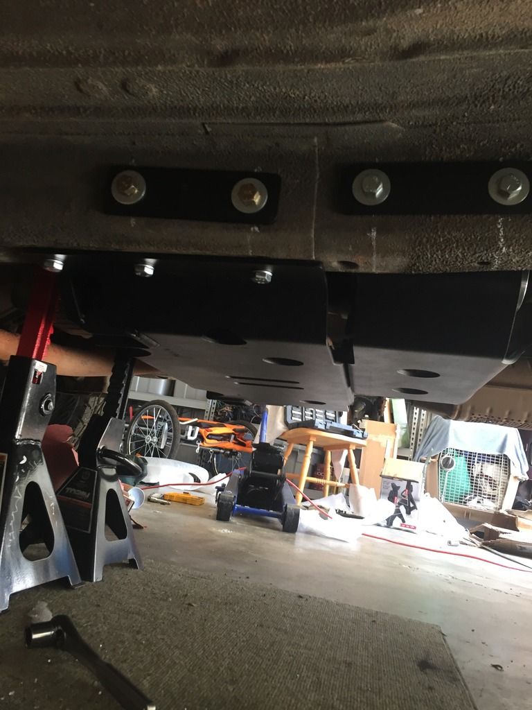

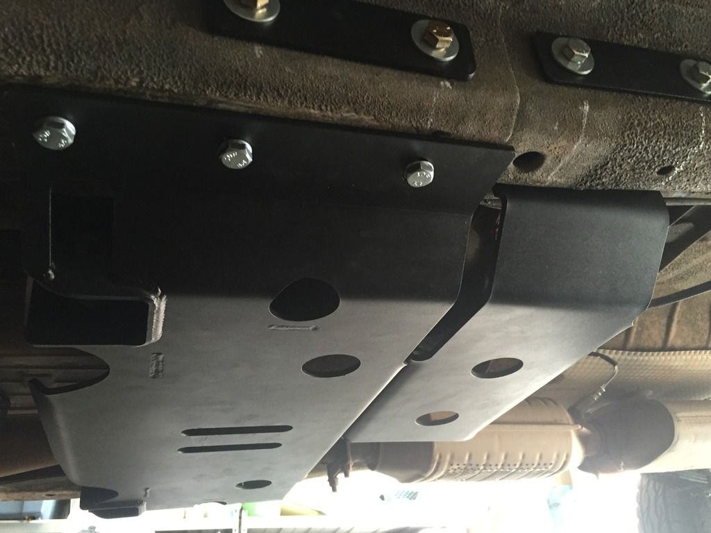

Onto SYE and TnT LA Bellypan install.
AA SYE. I installed with the SYE still inside the jeep thinking I would save time. However i feel like it took me the same amount of time as it has in the past. In the future I would probably pull it out to install so i'm not on the ground all day. Probably took 4.5-5 hours (with a trip to napa).
This was my first time installing the TnT Bellypan. It took me a bit to actually figure out what the directions were saying. I ended up just getting into it and then the directions started making sense. Probably took 3 hours to install. I HIGHLY recommend using a 90* drill to cut the holes, much easier. Install ended up clean (will be adding stiffeners as well as painting rails in the near future.
So far very impressed with the TnT LA Bellypan. Huge amount of added coverage and I think I could drop the jeep on it without any problem at all.

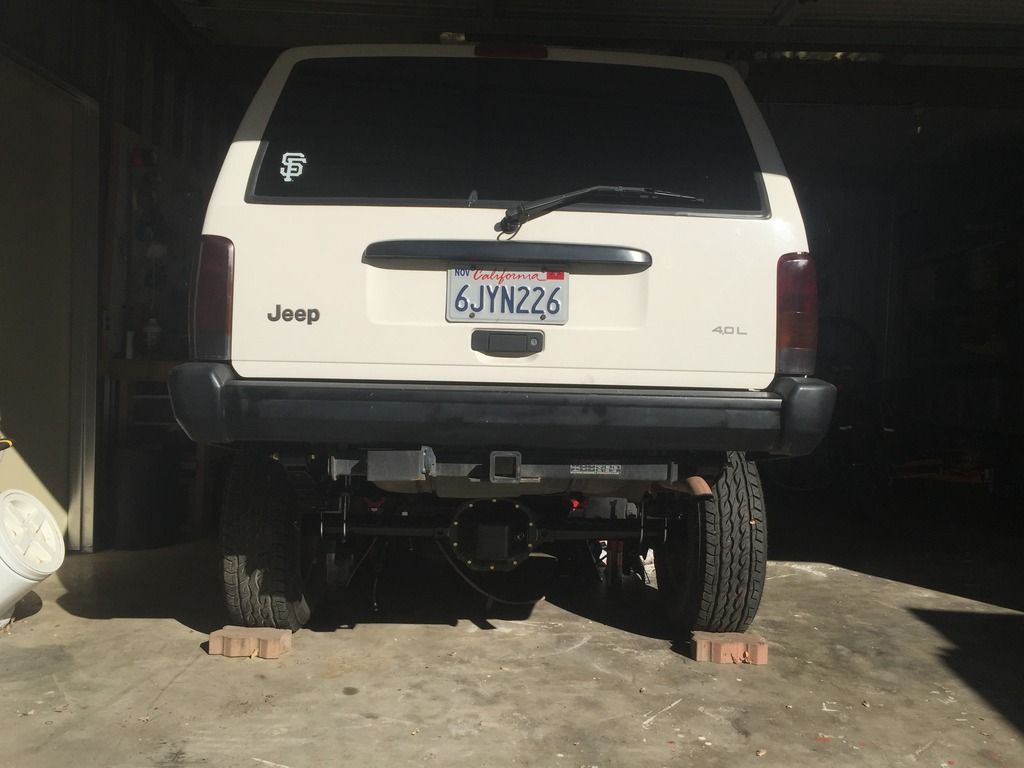

And the front begins.
Out with the old.
Mocked ride height

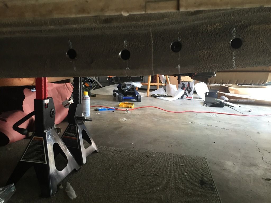

Today's progress, LCA mount removal. 6 cutoff wheels later....
I just got done removing mine this past weekend as well. After bending a sawzall blade and exploding a cut off wheel i changed tactics and drilled out all of the spot welds the pried it off. I don't think it took any longer and it left a nicer surface for frame stiffeners.
Ya there's really no good way to go about it. I was stuck with cutoff wheels only. I exploded two...
My finished product ended up better than I expected but took a lot of grinding after the fact. I'm surprised I didn't burn out my cheap grinder.
