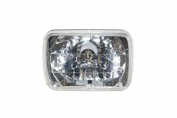

So to the OP, did you do a proper retrofit, or did you just stick HID bulbs into standard style lights? As an example, this type of lens will not work as intended:
Whereas this type of lens works very well:
