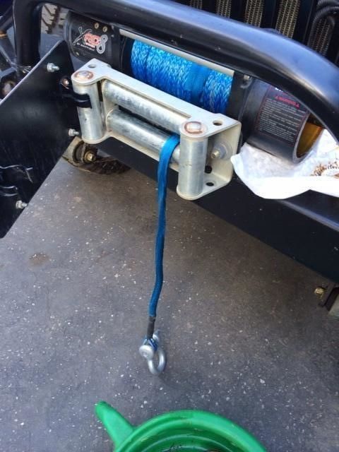

I finally decided to dig into the problem of my winch-line being so difficult to free spool. What I found is that the grease that is inside from the factory is very thick. Too thick. What follows should take the mystery out of what you will find inside of your winch. Mine happens to be a Smittybilt 8k pound and I'm guessing that other models would have similar guts. This process takes about an hour, faster if you've done it before. The only tools required are the Allen wrench to remove the end plate, a toothbrush or similar tool and an oil pan. I used diesel as my solvent but any degreaser would suffice. I used brake cleaner to get the diesel out followed by compressed air then liberal amounts of MolyB/Graphite grease on all of the gears.

My end result was being able to pull the line with one hand where it took both and lots of upper body effort prior.
