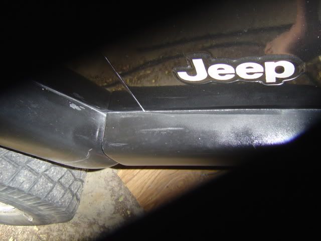

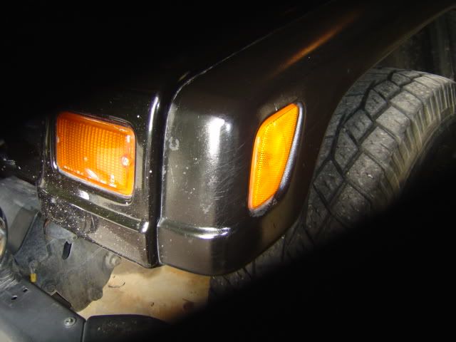

Here are mine after nearly a year and one coat:
(sorry for the poor pics)
Over all the durability has been good, these are a sampling of about what all four show for wear.
