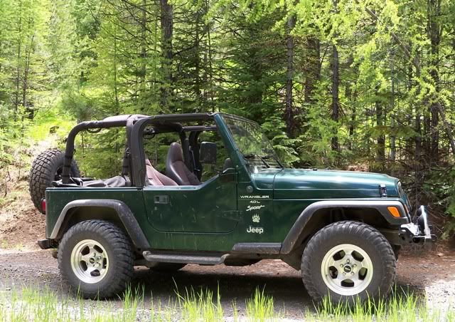

I marked mine along the straight edge using a "jig" of sorts.
Mind you, I only trimmed about 1-1/2". I nailed 2 pieces of wood together in an "X". Slide one board along the inside of the flare, pinch a boxcutter on the other side of the board to score a line along the fender.
I also used a paint stripping wheel in a drill to get an even radius in the corners.
