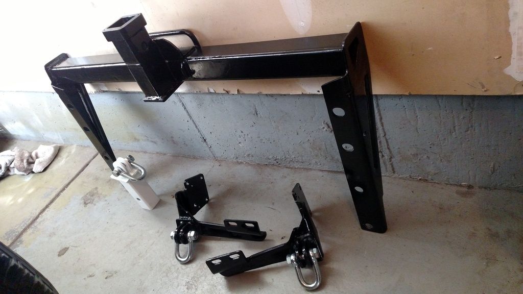

I finished my hitch flip last night. Turned out ok I guess.
Here's a better shot of the finished hitch. I just cut the ends and flipped the frame mounts. The chain hook bar was also cut off and relocated to the other side. If you leave the receiver part exactly where it is from the factory, it puts the receiver tube at the right height in the middle of the bumper.
I ended up cutting on the red lines to allow for more space for when inserting the hitch pins. Just make sure not to cut off the bumper cover mounting holes. I was about 1in away. Also, note that both the metal bumper and the frame metal behind had to be trimmed.

I also took my front factory tow hook mounts and welded d-rings mounts to them
