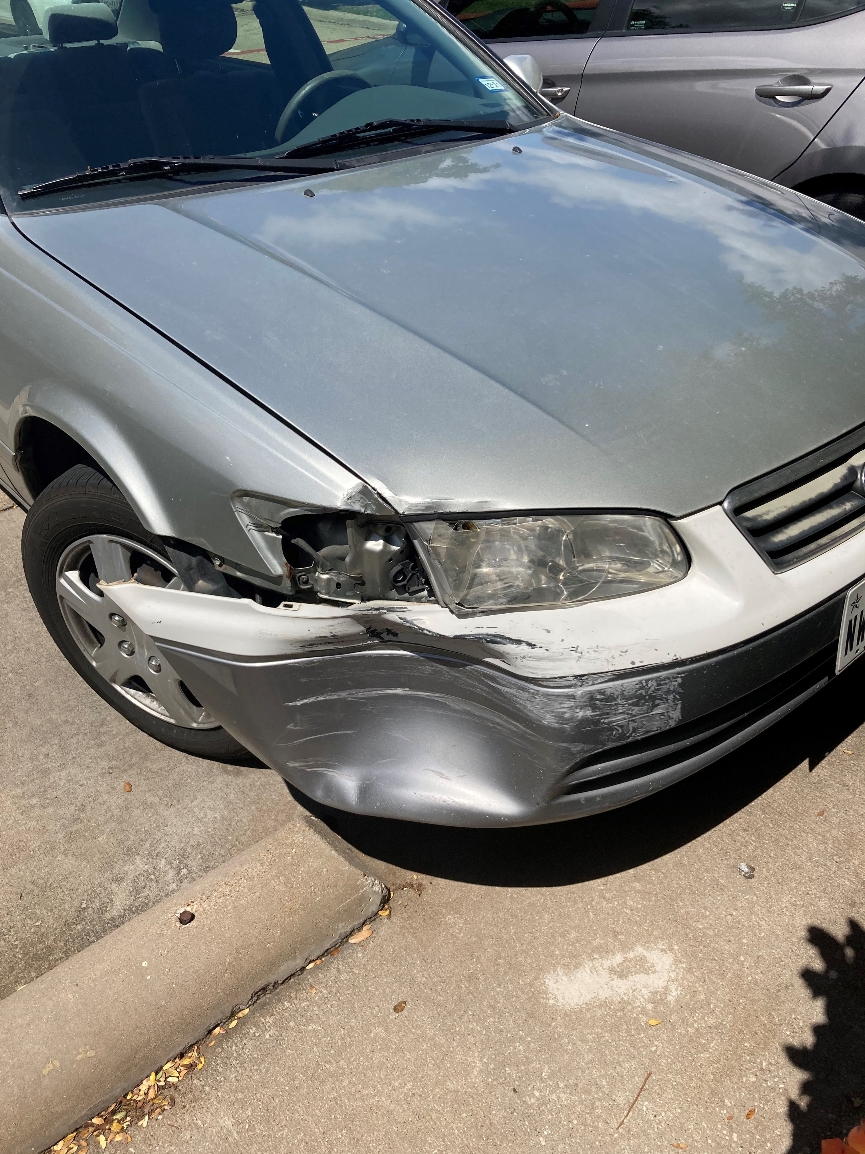

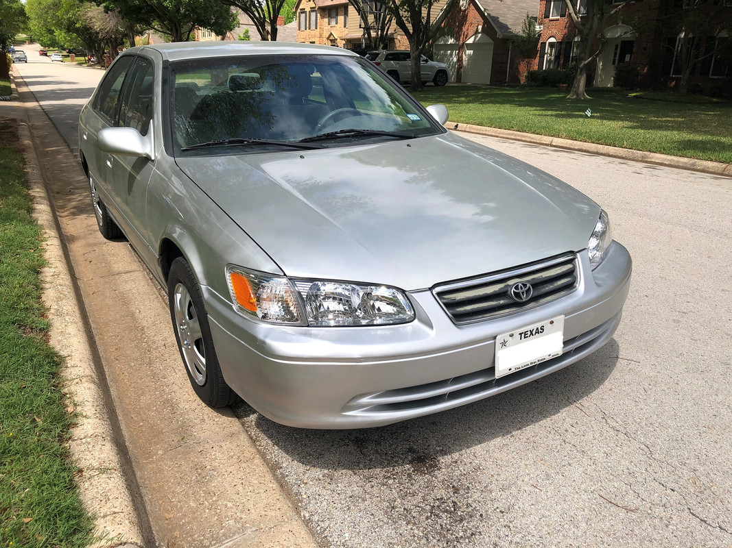

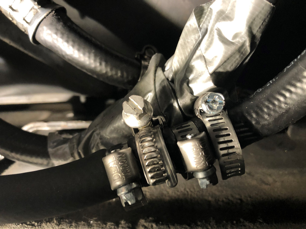

Finally got around to putting in the Transmission Cooler. I was delayed a bit as my daughter had a minor accident in her old Camry, so I quick fixed her car on the cheap with a little Bondo, heat gun to push the bumper back out, new headlights / turn signal lamp, sanding, primer and painted with Duplicolor in a rattle can... I was going to paint her wreaking yard bumper cover at some point anyhow.. She is rather accident prone, so all in all I spent $197 in case she has any more accidents:
After (good enough):

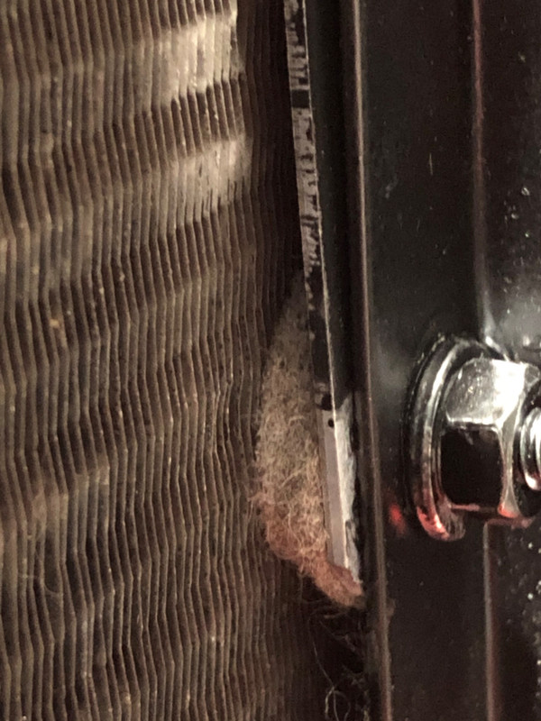

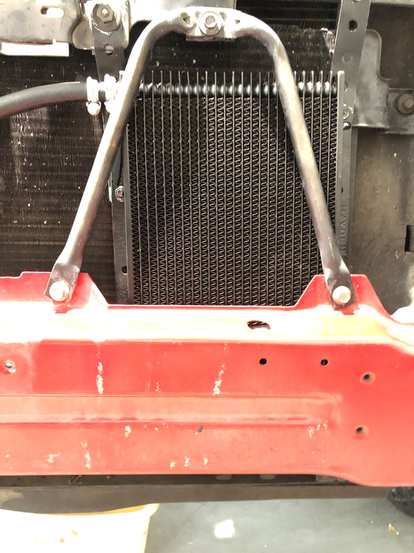

Anyhow, onto the Jeep.. I took my time on this.. Rainy day here today but cool. I got the Transmission Cooler to just fit without touching the condenser, and it is firmly mounted using the metal strips you buy as a kit separately.
The top left was the most challenging to fit without touching the condenser. It does not touch, but I did glue a felt grommet around the nut just in case of any vibration:

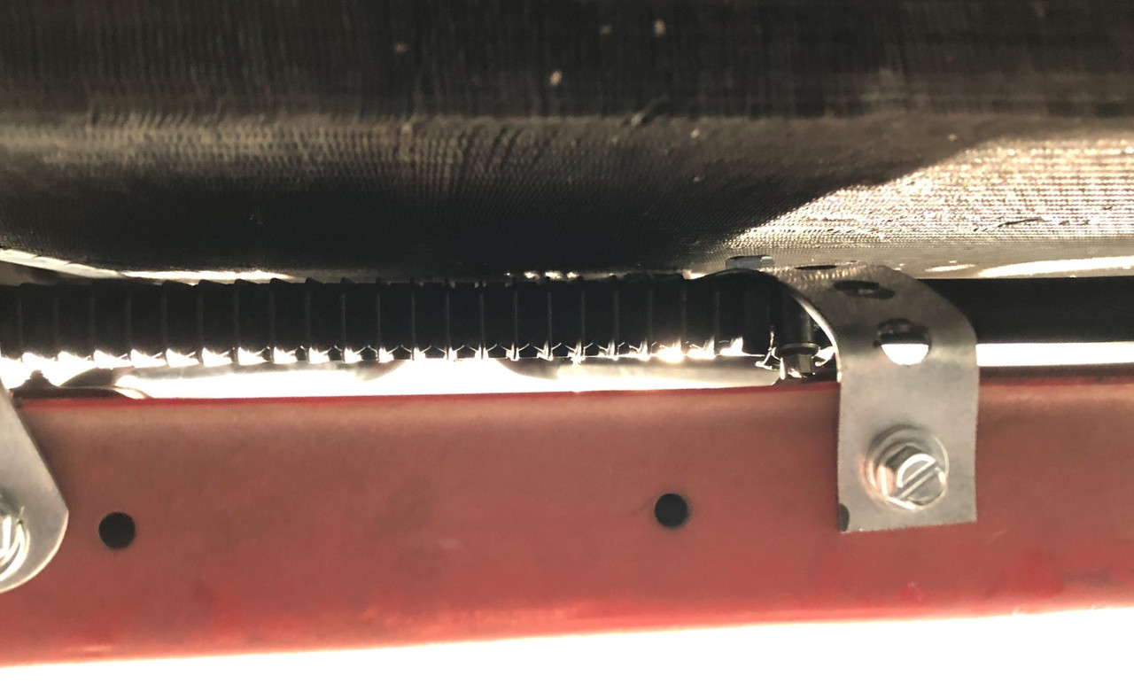

Mounted (note, I did use a few washers as spaces on the triangular mount. Hose clamps are doubled up on the TC:
I doubled up on ALL hose clamps to buy some peace of mind, and I wrapped the sending hose (in the middle) with duct tape in case of any vibration against it with the hose clamps.. I did zip tie all the hoses into place, and made sure I kept the natural direction of the spliced factory return hose, so I have hoses going around both sides underneath to the front:
Not touching:
All buttoned up, tranny fluid topped off, and no leaks:
