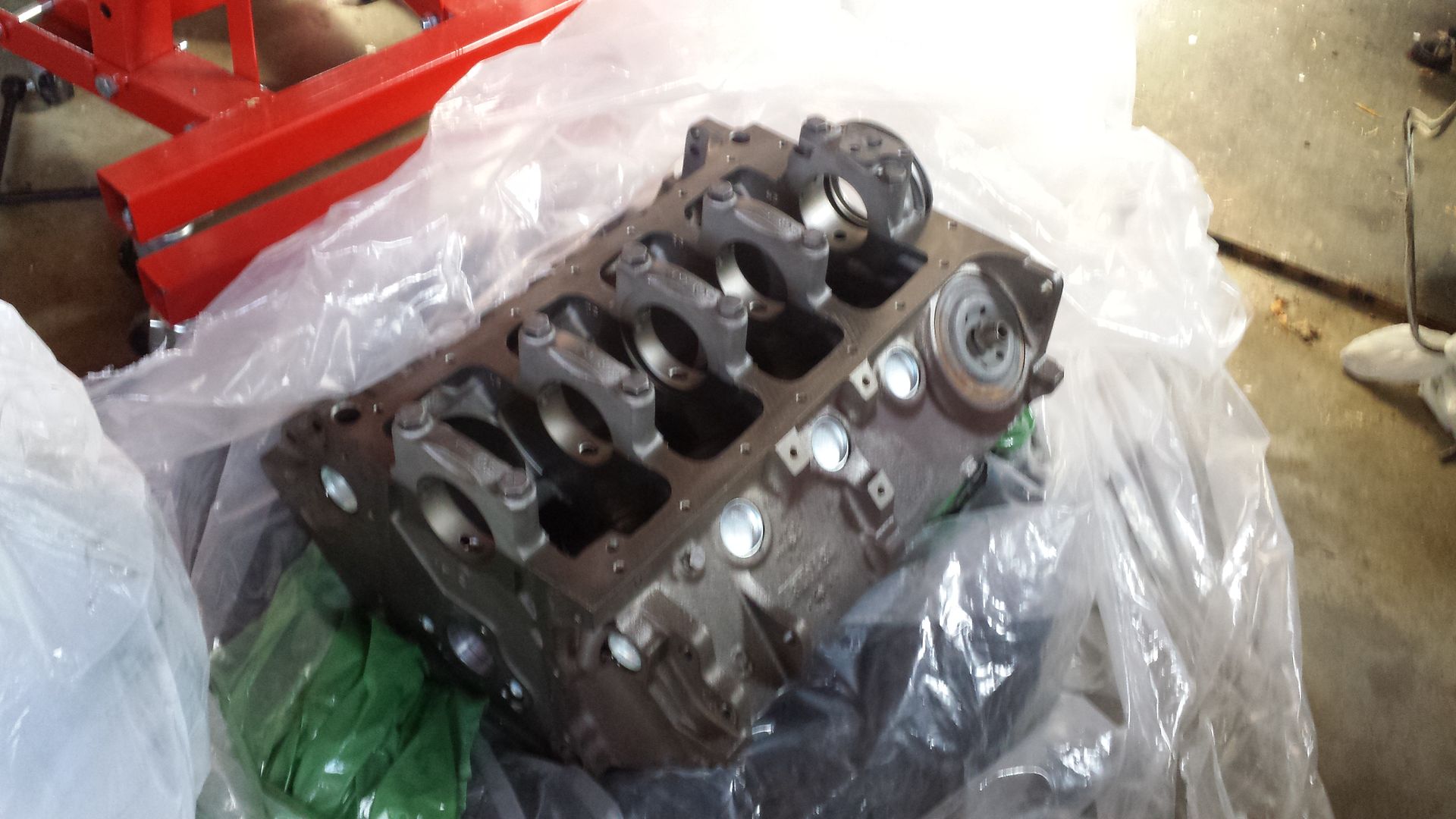

I vote engine swap, I'm prepping a 99 5.9 from a dodge truck. It takes some extra parts but it is doable

If you check the faqs of the zj page I think it gives a decent description of the swap. You'll need the 5.9 (or course), new engine mounts, new torque converter, and a few others things. As well as of course new seals and sensors and what not, depending on how far you want to go.
Mines completely honed, bored .40 over with new heads and pistons. But the 5.9 block I bought was toast, so I went ahead and got it done all the way. Though my wallets been bleeding ever since
Mines a long term project, but it doesn't have to be.
