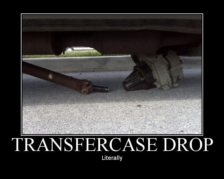

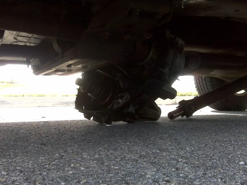

Like the title says, I'm new here. I'm more of a race car guy: I own a 1998 BMW M Roadster that I track and daily drive. My Jeep, with 190,000 miles on it, is a nice backup car that hauls stuff. At least, it was. Now that my wife is pregnant, it was going to be a great car to haul the soon to be born kid in with 100,000 things that only my wife knows how to use in the trunk.
Now that the background is out of the way: I obviously need a new transfer case. It was on the list anyway, but now, well...
Pretty, huh?
First off, I think it just tore the transfer case and the transmission is actually OK, but I defer to you guys there. Secondly, what other things should I be looking for with respect to getting this thing back on the road? Thirdly, a friend of mine used to be a Jeep service adviser and told me that that particular transfer case was known to grenade. He mentioned that there is another case that's 2WD full time/ 4WD part time. The current one (don't know the model number) is all-time 4WD with a 4-Low shift option. Is this something that I can swap easily or would I have to change axles, etc. to make it work? If it's a direct swap, I'm seriously considering it for the gas mileage. Keep in mind: this thing will be a kiddie-cart primarily. We plan to just use it for long trips where we have to haul crap for the baby.

Ok, first, I lol'ed at your thread title. A lot. I'm sorry. Second, you are looking at doing the 242 swap, which is Jeep's "selec-trac" 4wd. Your grenanded transfer case is a 247. Because you have the 4.7, you will need to find a donor 242HD, from another 4.7 WJ. It will then be a direct swap. You may need to use the tailcone or input/output shafts from the 247. Someone else on here will know that for sure. Thirdly, you will not gain any gas mileage from having full time 2wd. The Jeep is fully mechanical and so everything is always moving anyways, just a matter of where the torque goes. I, as well as others, keep my 242 in 4 full time all the time just for the added traction. Lastly, I suspect your transmission is probably ok, but I will also defer that to those more knowledgeable than myself.

Those pictures are awesome!
I know it totally sucks and glad your ok and all, but damn!
I don't know the WJ's well, but your going down a well traveled path with the TC swaps. Plenty of guys on here have done the swap and will soon chime in.
doesn't look like you hurt the trans, the main shaft inside the tc will pull apart from the input gear with no worries when the case halves are apart, and I dont see any parts of the trans on that case.
There are six bolts that bolt the tc to the trans. I'm sure that they are all still on the trans, look for stress cracks on the trans mounting points and be sure to look at the ruber trans mount real well.
Good luck.
Thanks! I'm looking at the bright side: It's already disassembled!

WOW!, thats way cooler than when my TC grenaded, but I fixed mine on the side of the road at midnight with JB weld, silcone, zip ties and Duct tape, doesn't look like you could have done the same.
If the trans looks ok, as far as the case goes, I would at least replace the output seal, it probably got damaged during the... what have you. Also, check the front Ujoint and yoke for damage, so that you don't have to go back in there a second time. If you do the 242 swap, grab all of the linkage and the interior bezel. I'm sure someone will chime in about any needed wiring, I think there is something about unplugging one harness and plugging another in behind the center consol?
Your right about the 242 being cheaper, I got one from the JY for $250, They can be had for cheaper, but the guy knew I needed it within three days, so he might have raised the price a bit.
Just curious, did it lock up on you?
Edit, with the new one, make sure it has ATF in it! Doesn't look like your old one had any.
