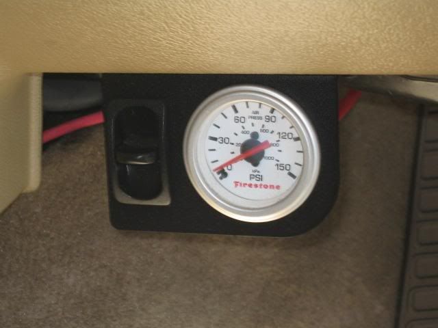

previous owner did the air bag upgrade to the jeep, here is the switch they installed up front...
and i see the exhaust tips aren't stock, not sure if the exhaust is different or just the tips (didn't get a chance yet to look under the jeep)

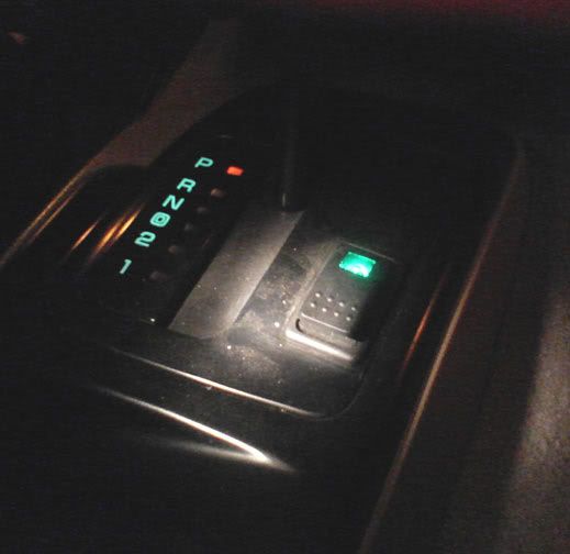

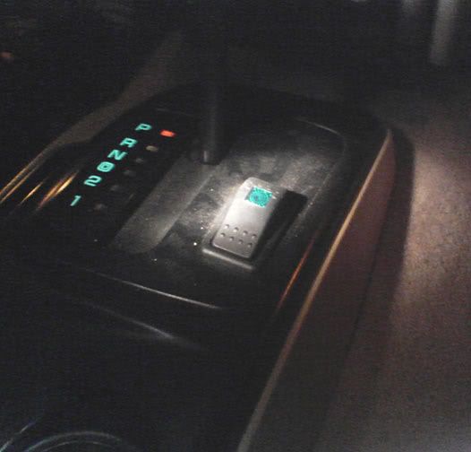

here are the 2 pics i just took...
Off
On
the guy that was selling the jeep mentioned that the previous owner installed this, where it's supposed to help get out of those muddy areas or for example pulling a boat from the lake when it's wet on the ground (maybe because this is a 2wd? - he had to put this in to help the wheels from slipping)

Sound like you have a locker in the back, and that's the switch to activate it.

so it was after market, It is very possible you have an after market locker, the only option I know of for the zj was the limited slip which I would think that would be good enough for pulling a boat out , It would be a streach for someone to spend that much money to install a true locker in a 2wd that already has a Limited slip unless the L.s in the rear failed and then the previous owner replaced the rear and added a new locker. which is a huge bonus for you. If you want to know if you have a locker it is easy to tell.
ofcourse block the front tires, Jack up one side in the rear, place jeep in N and with the key on and locker switch active/on, you should NOT be able to spin the tire off the groud by hand because it is LOCKED to the other side on the ground, then Unselect the locker switch, if that is what it is ,and you will be able to spin the tire off the ground.

Looks like you have an locker in the rear, either electric or air. you need to do a little more investigations on that.

you know that gague and switch you showed a picture of is probably not for an air bag , if you have a locker, after market, it would probably be air actuated, that switch might turn on the compressor for the locker. I bet that is it, I am very confident that is for your locker. not and airbag. an airbag does not work with that consept. compressed air that is.

I'm pretty sure that gauge with the switch is for firestone airbag spring helpers.
