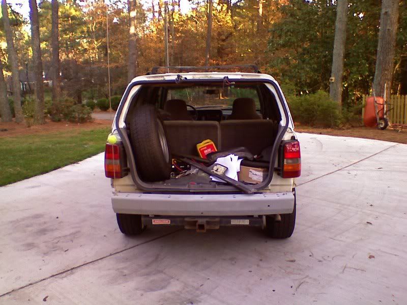

The hinges are easy to take off, dont be afraid to put some muscle into the bolts. The hub connecters on the other hand are a PITA. The torx head is in the middle of the hub, surrounded by wires. Im pretty sure the torx head is a T25. Be careful with the wires though, they can break, and its not fun to fix.
Edit: Photo

Dont go hatchless unless you Reinforce your unibody somehow.
The unibody WILL flex without it on there. Ask me how I know...
