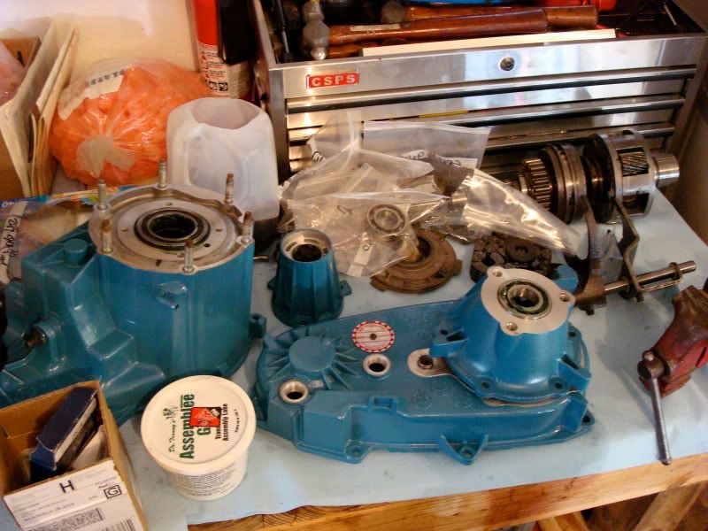

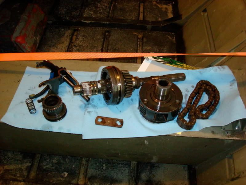

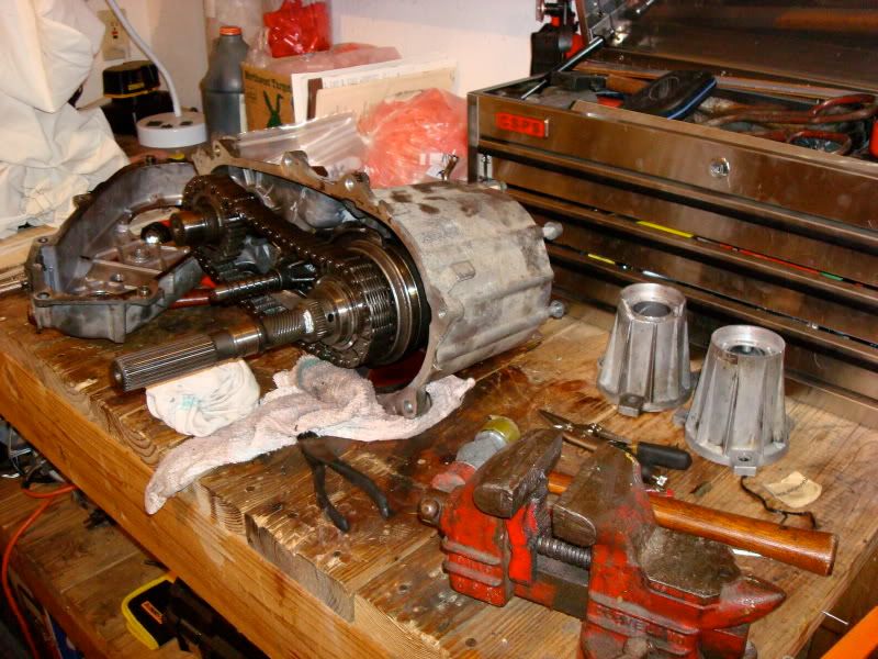

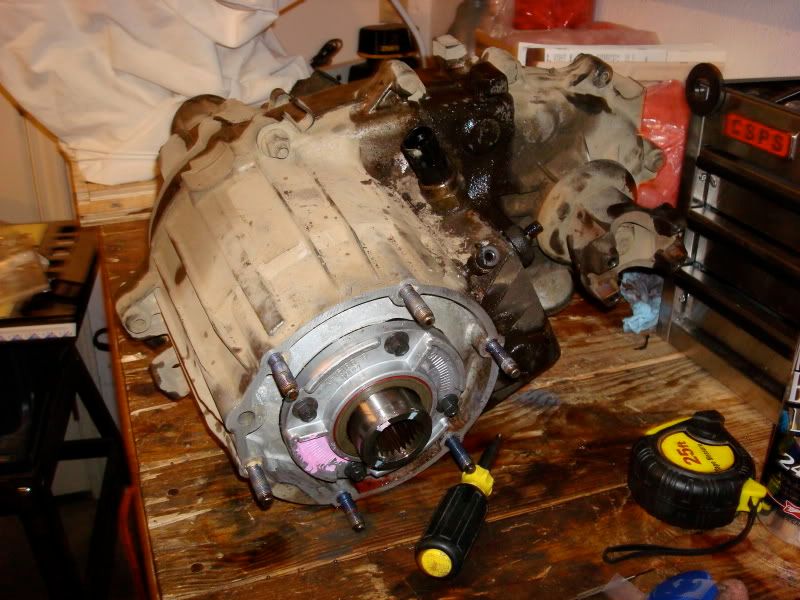

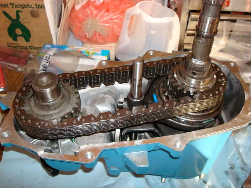

ordered a few parts for the 231, couple seals, couple bearings and all 6 shift fork pads. pulled out my 249 today and discovered that the input is the same length but the donor is the 21 spline and the 249 is 23 spline so now i have to tear down the 249. its amazing how huge the 249 is compared to the 231, i knew it was bigger but man the 249 is huge. im not going to be able to hook up my VIC because the 231 is too old and doesnt have an electronic hook up but that doesnt bother me. here are a couple pics.
old 249, a huge piece of ****!
231 being taken apart
main 231 innards, pretty basic actually
231 casings all cleaned up and finished with some mopar blue bling

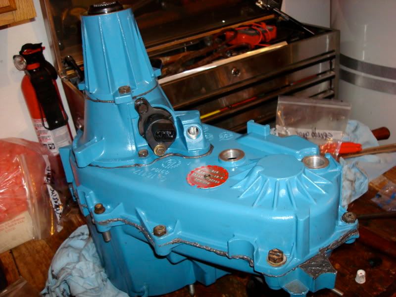

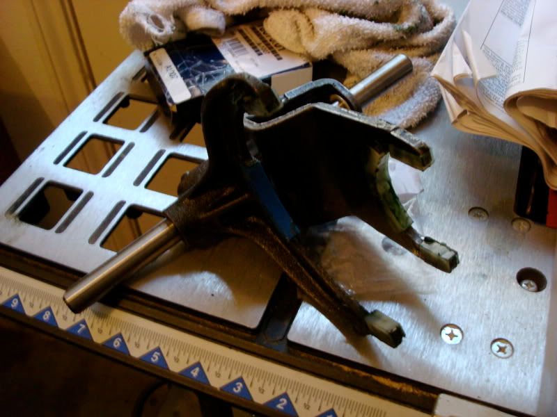

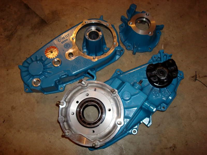

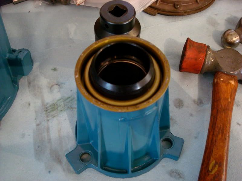

yep, 249 torn apart, sun gear/input swapped, VC heavy as hell, parts arrived today and 231 put together and ready to go.
ready to assemble
new rear output seal
new rear output bearing
new shift fork pads
and all done, excuse all the silicone, sealed it and realized i forgot the spring on the end of the shift fork rod so i had to crack it open and seal it again.
