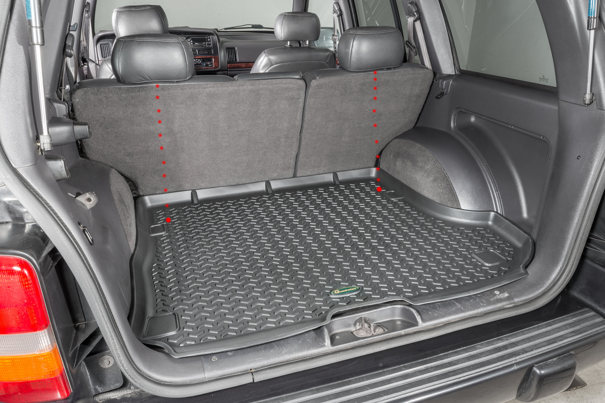

1) Obviously a 1995 has no LATCH system. No worries, I can use that extra buckle / belt tightener thing to lock the belt in place for seat-belt install. With the top/center Tether - what are you all doing? I'm currently 6000 miles away from my Jeep so no way to run out and do a quick inspection; will be back in a few weeks. What is the situation with the vehicle body a few inches behind the seat? Is there a place where I can just drill a hole through and install an Eye Bolt with a big washer on the back side? (Obviously those screw-in cargo loops are worthless.)
I'm thinking something like this -

We have been using the Graco 4Ever DLX (https://www.amazon.com/Graco-4Ever-D.../dp/B07J37RTPG). My daughter is 4 1/2 and about 43 lbs (I'm 6'6" and she got the tallness).
As for the latch points, the spot you have marked is right about where the OEM cargo loops are. Should be right over the rear axle so should be room to add a loop. Just look under and plan it out first and look up the specs on the latch anchor position. IMS they are supposed to go up and back or straight down but I could be mistaken.
I was looking at this when my oldest daughter was born. The infant car seat didn't need the upper tiedown and could use the center seat non-retractable buckle. But we wanted two so something would need to happed. Which turned out to be the 42RE going bad and me buying a Forester. Now my sister drives the ZJ with her one kiddo so it's fine.
There is a thread here or maybe just out on the web were someone welded in latch anchors to the rear seat frame. It might also include info on the upper anchors but I can't find it offhand.
I don't recall any loops there, but annoyingly it's impossible for me to check right now... from 6000 miles. That would sure make life easier! Are they under the carpet? As to the anchor position, I've seen them all over the place; I think the important bit is that it's behind the seat, since the intent is to keep the child seat from moving forward in a crash.
I thought they were there on all the ZJs. Your cargo liner has the rectangles marked out over the loop locations. I assume so you could cut out and use them. I don't think I'd trust the loops for an anchor point though. They're probably to far to the side anyway. But the fact that they are there probably means the sheet metal is good enough and there are no issues with clearance underneath.

That's just a random picture I grabbed off the internet to draw dots on. But anyway... interesting. When I get back to the Jeep I'll check there for anchor points. Thanks again!

I drilled mine out when I puled the carpet. They are NOT safe for child seat use as they are only pop riveted in place. they are meant more for light weight cargo control. I had considered using bolt in anchor loops for a replacement ( https://www.lowes.com/pd/CargoSmart-...-PC/5001906019 ) but i am opting to go with custom cut L Track instead as it will allow me more flexibility to future plans.
