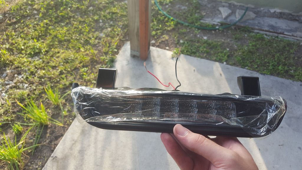

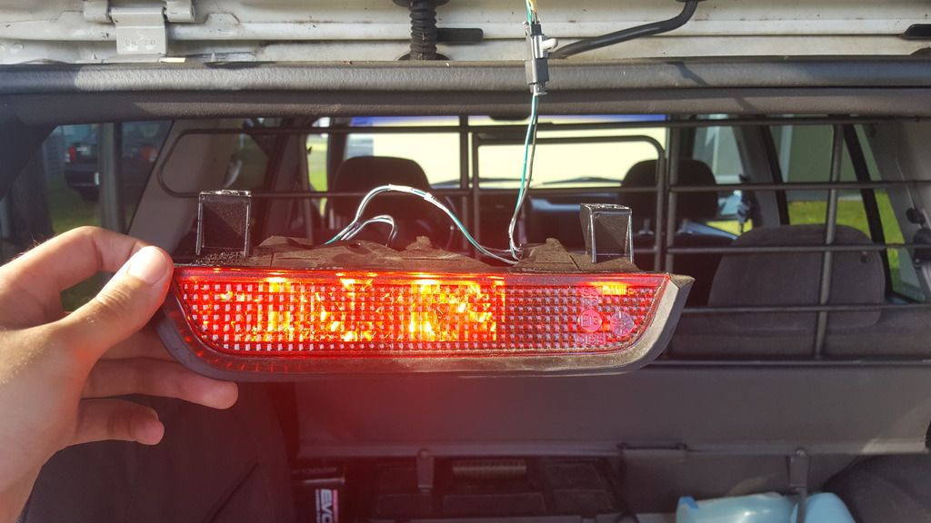

::::::: Mod Name: 3rd Led Brake Light Assembly
::::::: Why Worth It: The led lights are brighter and they last longer
::::::: Cost: I bought them for $20 six months ago; I found a web page that sells them for $24
::::::: Where to buy: DashzRacing
::::::: Time required:~.5 max hour
::::::: Difficulty(1-10): 1, if even
::::::: Picture(s):
Old Assembly:

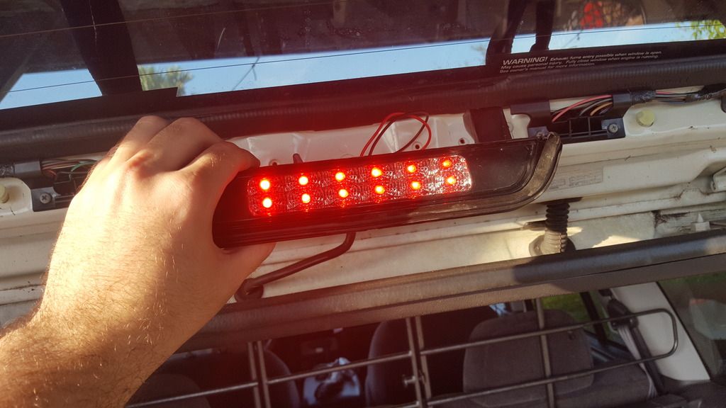

Led lights:

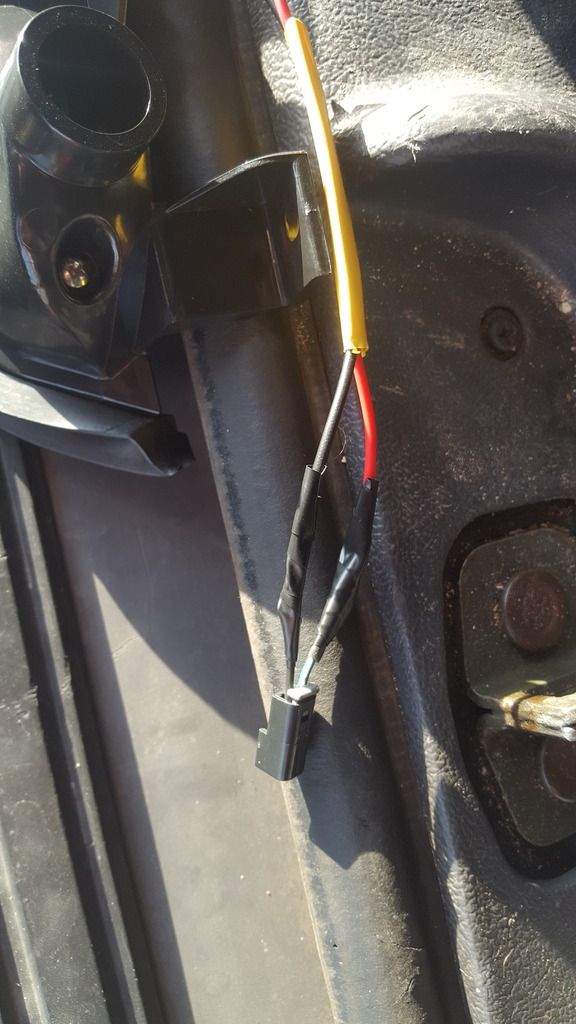

I cut the the harness from the old assembly and attached the cables from the new one:

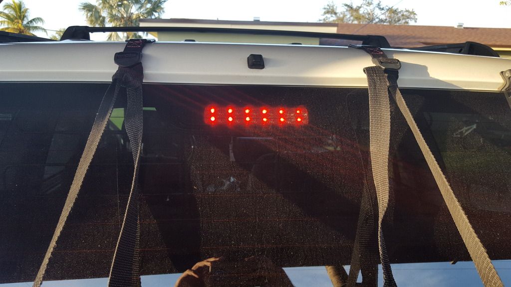

And this is the finished product:

Very Nice!
**EDIT** The company says this has been discontinued.

I replaced the three lamps in the center high brake light with LEDs from SuperBrightLEDs.com -- I went with larger LEDs as I have another thing in mind for that center light.
Then the next step, the one you didn't mention, is doing something about the lights out module (LOM) hiding behind the spare tire. The first time you press the brake pedal with the engine running, you're going to get the cheery REAR LAMP FAILURE on the VIC.
The easiest thing to do is to pull the LOM and plug the connectors which used to go to the LOM into each other, eliminating the LOM.
The good news and the bad news of removing the LOM -- you don't know when rear lamps go out. But you don't see warnings for LEDs that are working just fine.
I'm replacing most of the rear lamps with LEDs, so the LOM needs to go.
Oh, once you start replacing turn signal lamps with LEDs, you need to replace the flasher module with one made for LEDs -- an EP27 flasher.
IMPORTANT NOTE: You can find a bunch of these EP27 LED flashers, from eBay, Amazon, SuperBrightLEDs.com, and other places. They come in TWO SIZES. The one that fits in the ZJ is around 28mm x 28mm. The one you don't want measures about 32mm x 32mm -- it won't fit.
bob k6rtm
Oh, I found the datasheet for the part used in the LOM. It's a multi-section comparator. It should be possible for someone to do measurements and calculate new resistor values for the different comparators in the LOM so it would work with certain LEDs in the rear lights. I so do not have time to do that. If you're interested, the IC is LM1946N (obsolete).

Troopers here love the easy ticket of a bulb out. Front LEDS with the flasher I could go with, but I'll keep the LOM for the rear. I don't know how comparators work but with the vastly varied LED types and manufacturers that could be quite a task matching them even with the same type LED.
