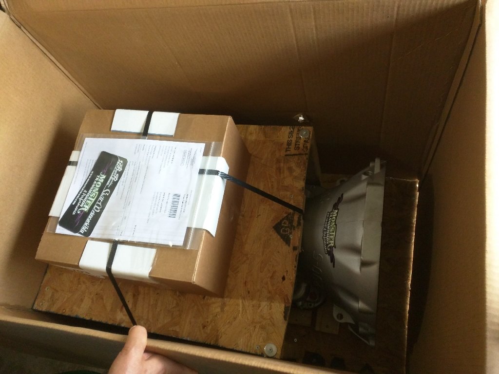

So, the transmission arrived yesterday. I came home from running errands and there was a sort of lopsided package in my driveway by the garage. The delivery agents hadn't rang the bell or anything, according to my wife. So we levered the box up onto a dolly and pushed it into the garage, since rain was in the forecast.
The "Pallet" it arrived on was pretty beat up. I'll have to make some minor repairs before returning the core.
This afternoon my father-in-law came by and we figured we'd start the process of installation. But first... to attach an old piece of oak 2x10 to my jack. This was more effort than I expected, just because I didn't have a bolt quite long enough, but I counter-sunk the hole quite a bit to get a nut on the back-side of things and I was in business.

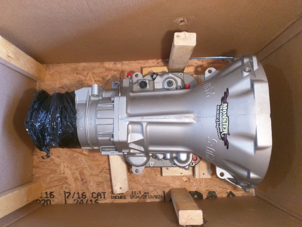

We opened up the box and looked inside. Behold!
After removing the (surprisingly heavy) torque converter and strapping, we had a nice view of the new beast:
Looks glorious, doesn't it?

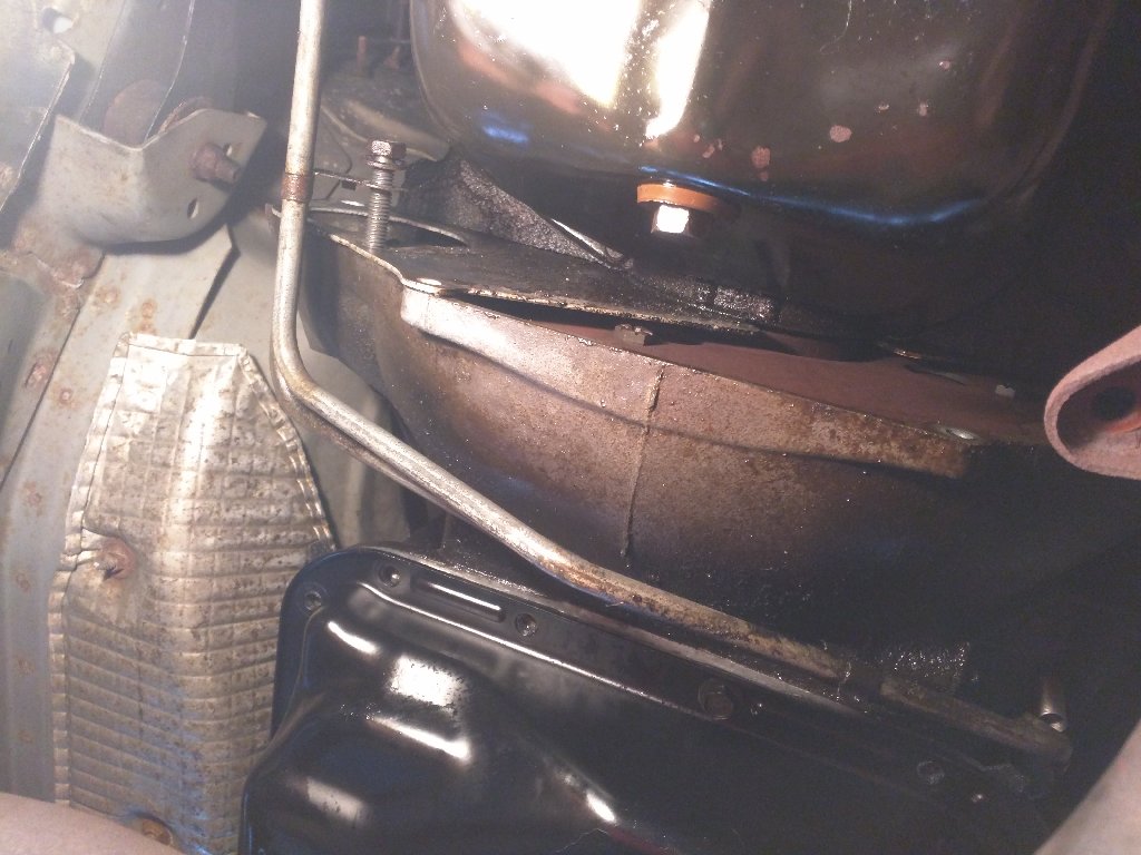

So... then I crawled under the Jeep and removed the transmission skid plate; 3x 15mm bolts that were still quite tight from when I installed the thing back in ~2013.
Now at this point I would reference the service manual to see what steps are required to remove the transmission. Unfortunately my PDF stops at page 30 and the R2 procedure starts on page 35, according to the Table of Contents.

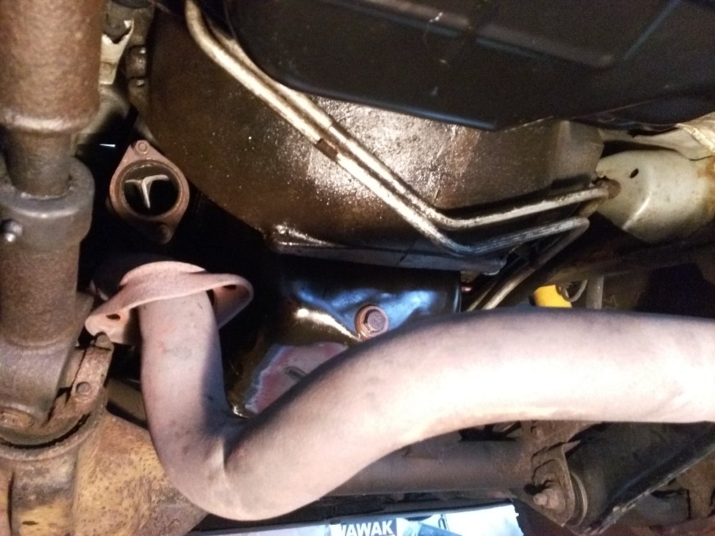

Undeterred, I forged ahead. I knew the exhaust system was in the way, so I set about removing it. This may be complicated by my installation of Kolak exhaust 18 months ago. The exhaust shop added a new hanger since one of them had rusted away. Anyway, I busted out my impact gun, a 12" extension, and a 14mm deep socket to remove the two flange nuts. Unfortunately I took no pictures of this.
With the flange nuts off I assumed I would be able to slide the system down off of the manifold studs... but no luck. The flange itself seems to be a separate piece that was clearly loose at this point because I could move it around with my fingers. And the exhaust pipe connecting up into the manifold was obviously loose because I could wiggle it and see it wiggle, but it stubbornly refused to slide the 1" down the studs. I yanked on the thing quite aggressively but it didn't budge. I tried gently "persuading" it with spirited taps near the manifold, but no luck. The downpipe is unwilling to separate from the manifold.
So. It being 6PM, I threw up my hands and came in for a shower and adult beverage, and to reference the Internets.

The transmission cross-member and the front exhaust need to come off together while the transmission is supported by a wood-block or trestle or something. I have a V8 so I have a y-pipe. The bolts to the manifold are through bolts with a nut on the other side. The nut is tabbed so it does not turn. You need to turn the bolt until the bolt and nut both fall on the floor.
The V-6 may be different.
The stock front exhaust and the mid exhaust have an overlap joint with a clamp. In a stock setup the clamp is tightened so much that two are permanently *deformed* *together*. Separating them requires a separator tool or an acetylene torch to heat red hot. I replaced my clamp with a stainless lap joint on my Dodge so I can remove it easily.
Removing the exhaust is the hardest part -- it took me a week because I had hardly any of the right tools at the time.
An exhaust shop will never bother putting things back like OEM, so I have no idea what you have. Usually an exhaust shop will just weld everything together right there while it is hanging because it is easier and they are really good pipe welders. It may be impossible to disassemble without cutting.
Also note there are plenty of cheep tools to cut exhaust pipe that are easy to use on your back under the car.

Once you pull the trans crossmember, and trans mount, the exhaust should move, as I think the exhaust is supported by the trans mount.
I just had to change my trans mount, and that is how it was set up, but my ZJ is 2wd - your mileage may vary.

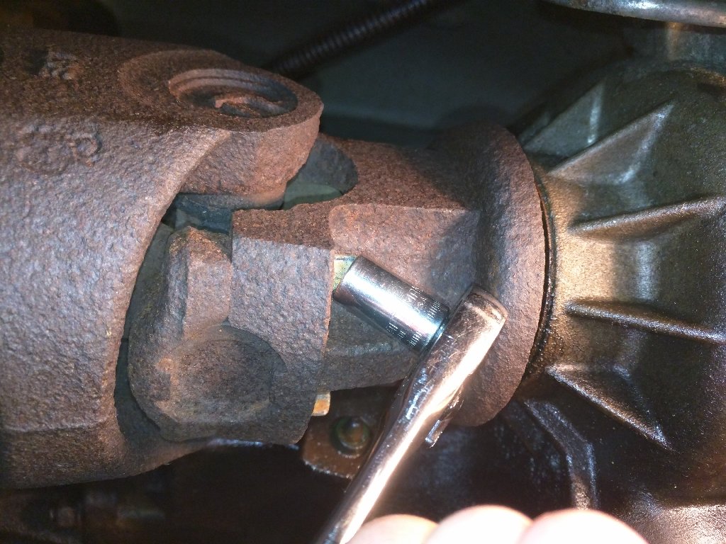

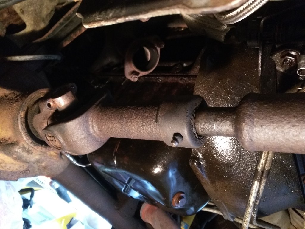

5. Remove rear driveshaft and plug hole in trans (I assume you'd pull both driveshafts).

So, decided to make what progress I could with the pipe in place.

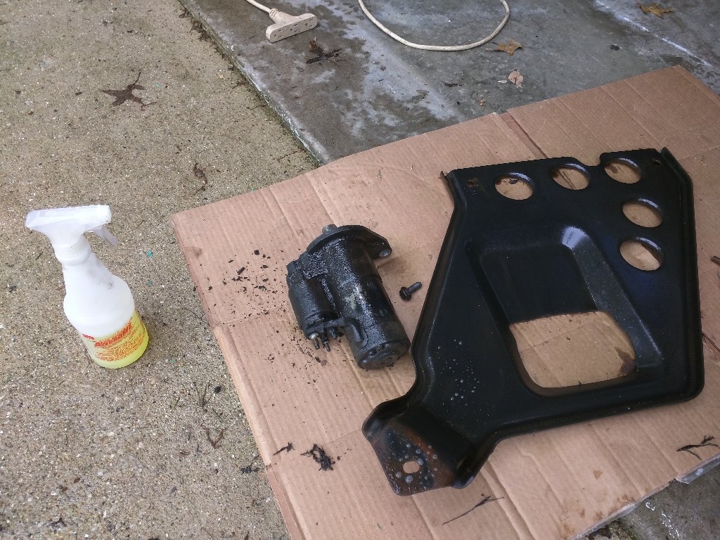

Removed the starter, with a little help from
. I think those are 13mm nuts for the wiring connections and an 8mm for the ground.
Then, the two bolts holding on the starter are 15mm / 9/16ths. Came off quite easily. Covered with as much old oil as the one in the video.
It got a liberal spray of degreaser and attention with several paper towels.
I gotta say, this ZJ starter was a million times easier than on my old BMW 540, that was a nightmare.
Look ma! No starter.
Grimey...

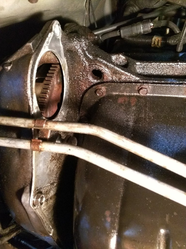

So then I quickly and easily removed the 3x 13mm bolts holding the torque converter cover in position and slid that out of the way.
Anyone reading this in hopes of following in my footsteps: save yourself a few minutes and remove the cover towards the driver's side.
It won't go the other way no matter how much you think it might, and how many angles you try.

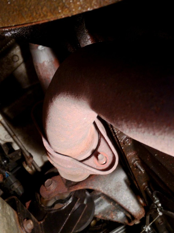

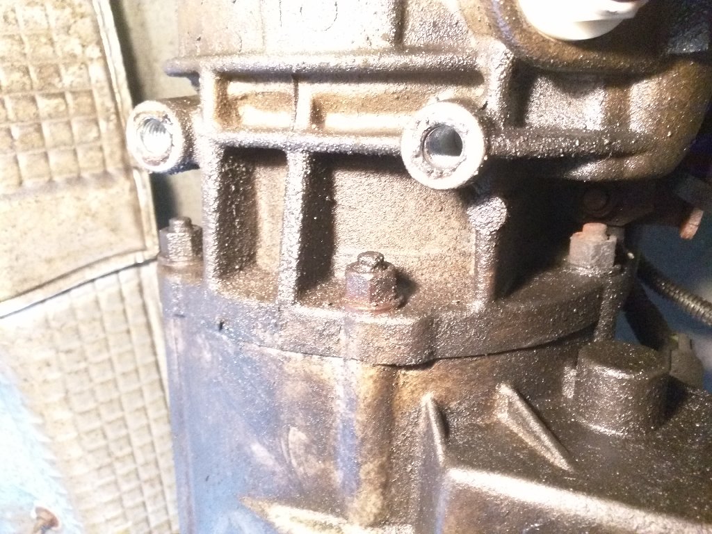

Now. The exhaust still didn't want to move at this point. I was convinced that StormChaserTim was right, and I had to drop the crossmember.

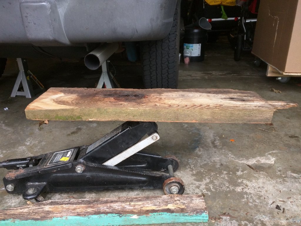

I cut a piece of 2x4 to ~16" to put below the TC at this point.

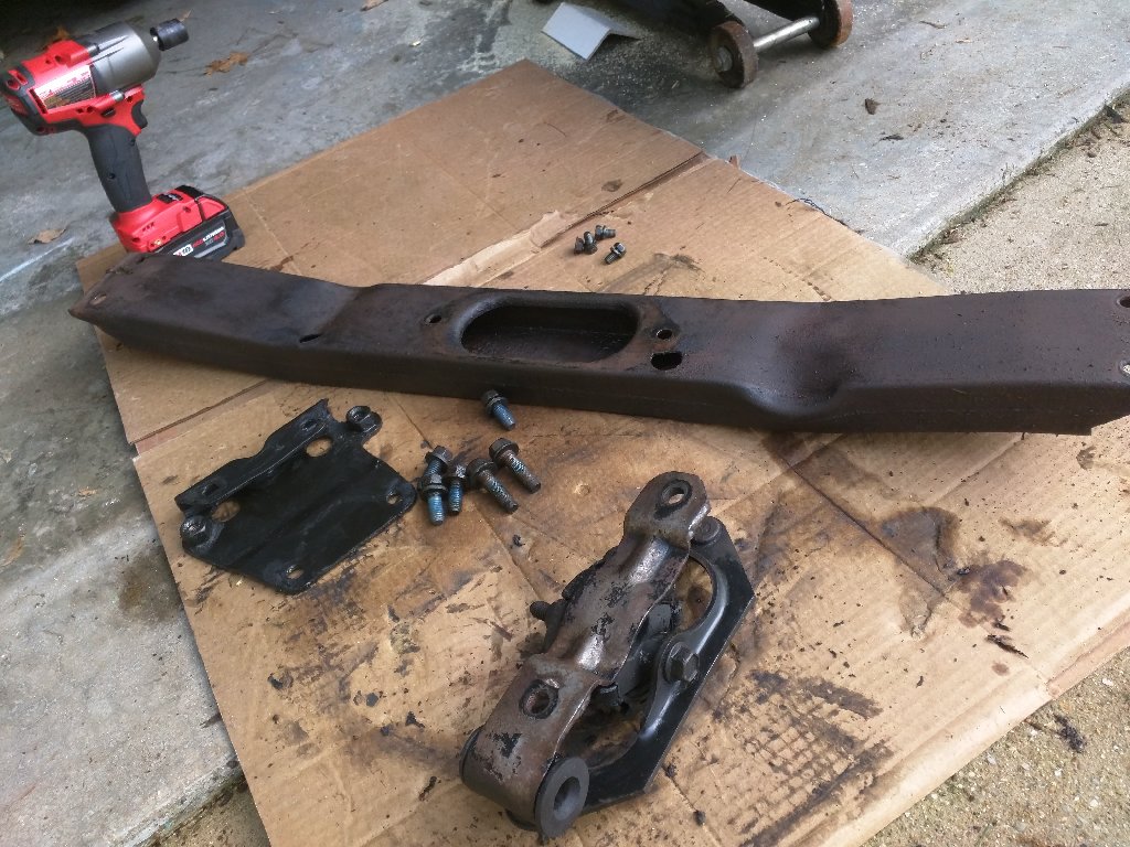

The crossmember was held on by 4x 15mm bolts and 2x 15mm nuts. Once down, you have a clear view of a rubber transmission mount thing
and the exhaust hanger. This is more challenging to remove because you have two more 15mm bolts, also four 16mm bolts. Two of each.
But two of the 16mm bolts are recessed and the hole is just *barely* big enough to fit a socket, and one is blocked by
the transmission mount so you need to use a box-end wrench to access it. Or at least I did. Sorry I don't have any pictures of this.
I was deep into swearing.
Eventually you get the transmission mount + exhaust hanger out and it looks like this:
With those things out of the way, there's no exhaust hanger to keep you from pulling down on the exhaust downpipe, and it should come out
with just a bit of tugging:
Now, here are the three pieces in question, just not stacked like they are in the vehicle:
Immediately above the crossmember is the piece in the foreground, then above that sits the curvy bracket at left, which bolts to the bottom of the tranny.
Questions from here:
1) While the exhaust is hanging, it's basically just hanging on the one hanger at the rear bumper now. I've tried pushing it over to the passenger's side,
but there's an awful lot of spring tension or something holding it in it's usual location. I guess I can get a line and pull it over and tie it to the nerf bar...
or am I doing something wrong here?

1. My exhaust isn't stock, so it's been awhile, but I think the stock exhaust didn't want to move over as much as my current exhaust. I think I did use a ratchet strap to hold it over at some point.

3. Measure between the bolt holes on your new converter and your old flywheel. Ideally either they both are all equally spaced (90 degree flywheel) or are both have two measurements the same, one a little shorter, and one a little longer (offset flywheel). Some of them have one bolt offset 5 degrees. It's about 1/8" IMS. A lot of people just slot one hole so it will fit. Mine has been this way for 10 years with no issues.
OK I'll check out the new TC and reference that against the old one when I get it out to see what difference there is, if any.

Originally Posted by AlamoJeeper
This post describes replacing my engine and transmission mounts. For illustration purposes, here is a picture of the 93-95 crossmember/transmission mount above the 96-98 crossmember/mount.
Cool, that's helpful. I think the current mount is still in pretty good shape, but it's probably also 25 years old so maybe I should source a replacement. Guess I could hit the JY to see if they have a 1996-1997 setup... but then I'd need to figure out how to bend the hanger bar to fit the different position... hmmm. hmmmmmmm
Yes, the transfer case and crossmember get removed after disconnecting both driveshafts. The FSM says to mark the orientation of the U-joint caps and positioning of the yokes so that you can reassemble them in the same orientation. Or you might install new U Joints. You might be able move the driveshafts far enough aside so that you don't need to disconnect them at the axles. You might consider replacing the transmission mount at this time.

My exhaust system was the same as yours, continuous from front to back. I used a saws-all to cut it into pieces and replaced everything from the manifold on back. The muffler had many holes in it and wouldn't pass annual inspection.
Mine is pretty new, but I'll cut it ahead of the cat if necessary. Thanks for the clamp idea!!

Oh, Jaime, I forgot to mention -
All you had to do to pull the crossmember was pull the 18MM through bolt holding the mount to the crossmember bracket, and then the 2 bolts on the driver side - loosen the 2 on the passenger side, and the crossmember will slide out to the driver's side. Once the crossmember is out of the way, you have clear access to the two bolts holding the trans mount to the trans bracket.
When you do go back together, install the mount bracket to the crossmember, but leave it slightly loose, so you can jiggle and wiggle things back in. Put the two bolts back in the passenger side frame so putting the crossmember in is not as big a chore.
Mine required a little finesse, plus a bit of muscle to line back up, but this may be due to my engine mounts being the originals, and older than the hills.

Did I mention I love my ultrasonic cleaner? Just wish it were bigger... These things had a thick coat of rust and gunk on them.
My magic combo is white vinegar and a squirt of dish soap. And many, many of the machine's 5-minute cycles...
Now just a slight patina from air-drying. (Lots more where this sample came from...)

Hit front of rear drive shaft with a squirt of paint to mark its alignment, then removed it. That one was easy. (four 8mm bolts and a gentle nudge with
a large screwdriver.) My question comes with the front drive shaft.
The four 8mm bolts at the front diffy / U-joint were easy. Even though the front of the Jeep is on ramps so I couldn't spin the shaft,
access was a piece of cake with my gun and an extension.
NOW. The four 8mm bolts at the TC are a much bigger pain because the access is TIGHT!! I couldn't even fit a "-drive ratchet in there,
much less put my impact gun on the thing. I COULD fit an 8mm box-end wrench, but unfortunately I just don't have enough leverage
on a wrench that short to break the bolts loose. Maybe I should hit them with some Liquid Wrench before bed.
QUESTIONS AT THIS STEP:
1) What did you guys do?
2) Do I have to actually remove the front drive shaft?
3) ...or is it okay to just let it hang there? Guess I can hang it loosely from the suspension with a cord... Thoughts?

At the Transfer Case I clearly need to remove this shifter rod. Is there a good technique for this?
It would also appear that I'll not be using the impact gun on some or all of these nuts since there's no clearance for that either...
With luck I'll be able to fit a ratchet/socket in there. Haven't tried it yet.
Who has a good trick for this?

I can't help with the 4WD stuff since mine's 2WD. I'd say use the 8mm wrench and the double wrench trick. Won't help you torque them down to reinstall though.

I'm also a 2wd guy, but...I have also been working on cars for 30 years. The linkage looks to me like a wrench job. Break torque on that little nut, spin it off, then slide off the linkage. That would be what I would try first.
On the transfer case, I'd see if I could use gear wrenches. It'd be a little slow going, but that should get them loose, and it would be quicker than just regular wrenches.
You actually have two options there. You COULD see if the trans and transfer case will come down as one unit, then you could seperate them and re-join them on the ground. That might make it a bit heavy and unwieldy though, and could be hard to handle for one person. The other way is to undo the bolts, and slide it off as it sits, then come down with the trans.
Tim

Liquid Wrench/PB Blaster is definitely your friend. Applied twenty-four hours before, then twelve hours, then twenty minutes. You probably know that the correct sized socket or box end wrench is less likely to round off hex corners than open end wrenches. Something UniBlurb suggests is turning a fastener both ways repetitively while breaking a bolt or nut loose. Heat applied to the fastener or nut with a torch can help break it loose. Moderate heat, making sure there is nothing flammable around.
FWIW, the Factory Service Manual (FSM) says to remove the transfer case and then the transmission. Securing each piece to your oak board on your jack before sliding it rearward off of its locating dowels.
Again, FWIW, I pretty slavishly follow the FSM procedures and torque values. It seems to save time and be less likely to injure myself.
