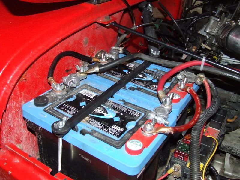

Heres mine. No isolator. Batteries wired together. my alternator also puts out about 120A at idle now with 194A max.

Great info guys Thanks! Since I have the batteries I think I'm going to do it. I'm just undecided on the isolator part of it. I'm just concerned without it I may fry something under the hood. I still have the stock highoutput alt.
