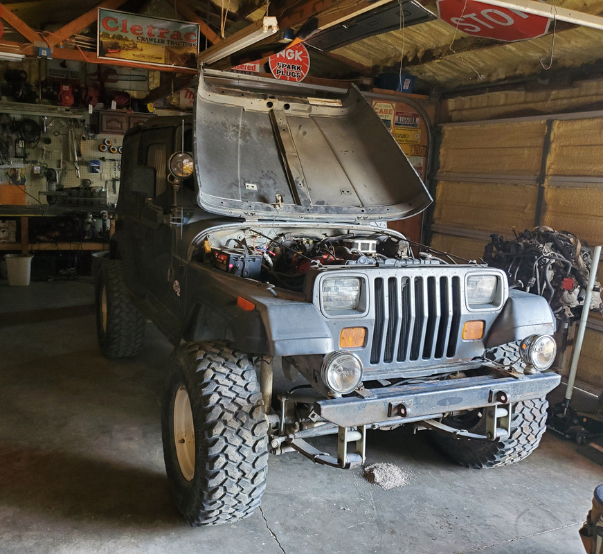

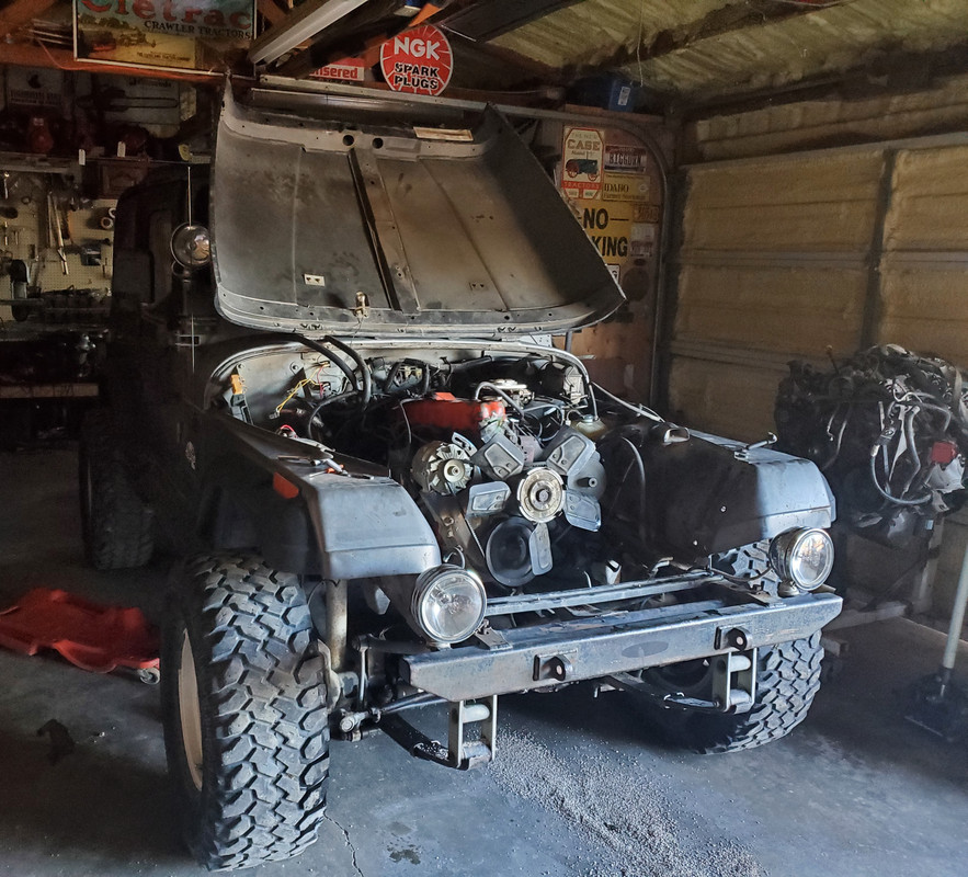

This time around, it'll be a 1990 YJ with 130k miles, that while it has a running motor, I'm just not a carburetor fan! I like EFI, especially living in the high desert of Idaho where we have swings from sub zero to 110 and altitude from 2000 feet to 10k feet. So, I'm an EFI guy. Now, I realize the 4.2 can be injected or a 4.0 can be swapped, but if I'm going to the effort, might as well swap a v8! And in this day and age, might as well be an LS!

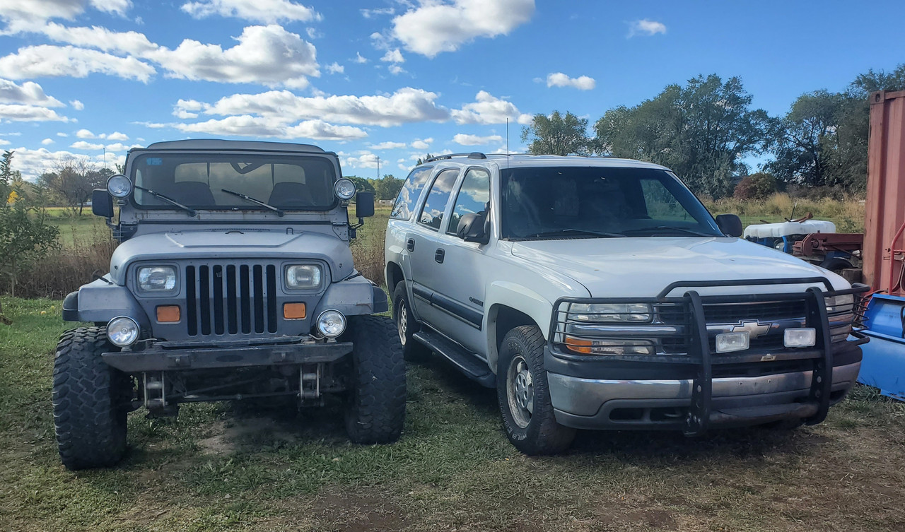

My $1500 YJ. No rust in the body or chassis, just some surface patina.

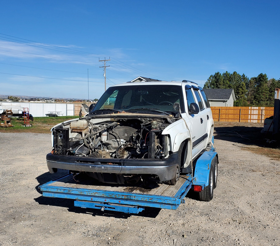

The donor: 2001 Tahoe with a 5.3 LS and 135k miles. Its an auto, but I'll be going 5 speed in the Jeep, because even with a blown clutch, you can still drive home!
The pair side by side, trying to get along...

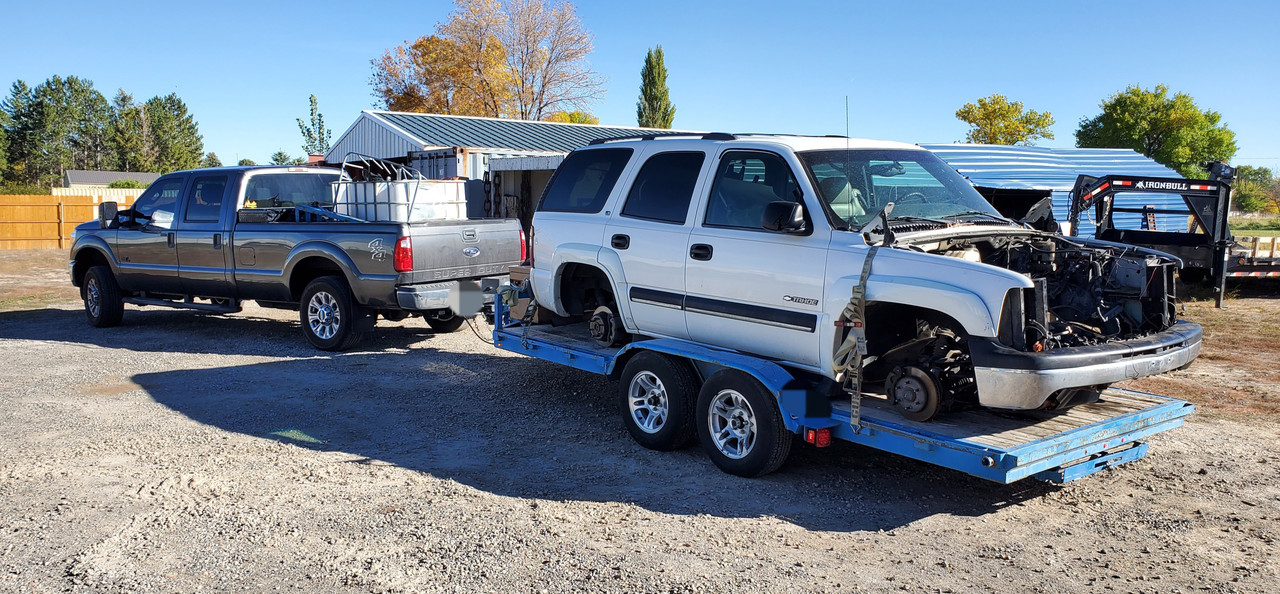

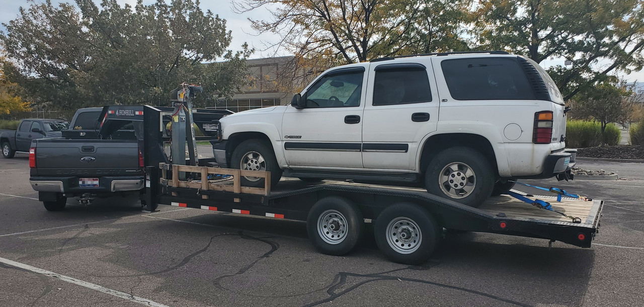

With the help of my eldest son (13), the engine is out. Tahoe was hauled off to the scraper. We got $150 for the Tahoe. $60 for the two catalytic converters, so at least it paid something!
Used the skid steer to lift up the Tahoe to pull the tires... was a little sketchy on the passenger rear...good thing the wife wasn't home for that one!

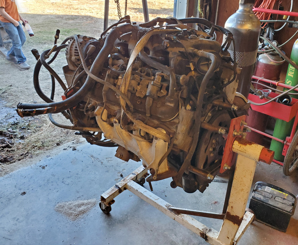

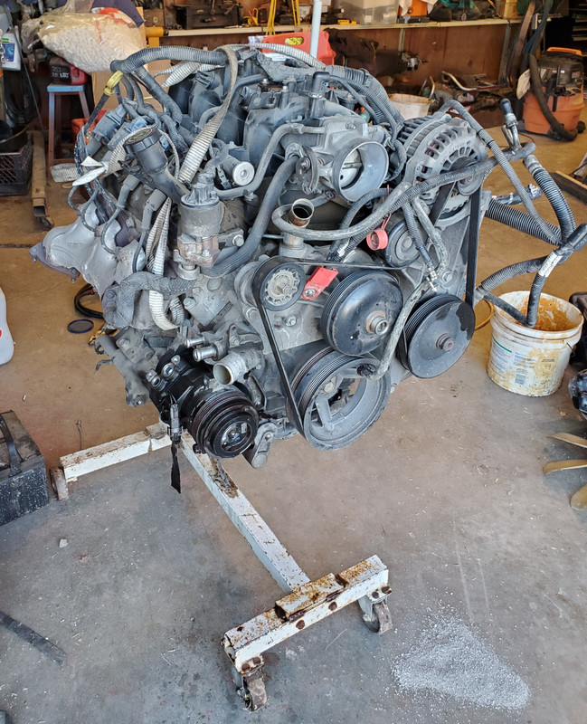

The engine is on the stand.
Now to get the engine cleaned and prepped to go back in.

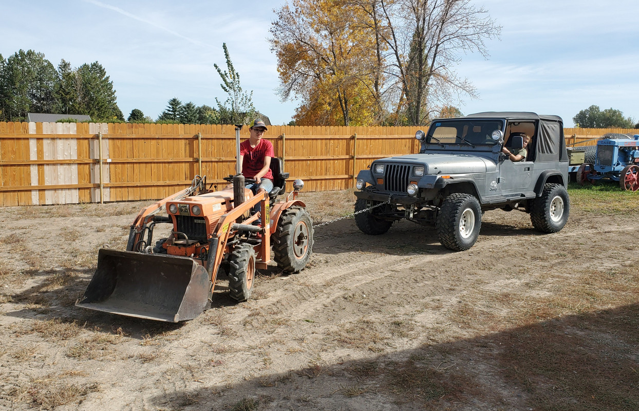

Well, I went NV3500 shopping with my eldest today at all the local scrap yards and learned that a 2001-2006 Chevy/GMC K1500 4x4 with a 4.8 and NV3500 is an exceptionally rare combination. So rare, none had ever even seen one! So, that tosses the NV3500 option out the window, back to Novak and retaining the AX15 it is! Hahaha. Oh the joys of power train swaps!
On the upside, we did get the Jeep into the shop today. My eldest two pulled it over with the Kubota:
http://www.youtube.com/watch?v=nblw6F9uDdE
While I have a skid steer and several larger tractors, that little B7100 Kubota is just such an amazing machine!

Had a little while this afternoon, so I prepped the Jeep to have the motor pulled tomorrow. All I need to do is unbolt the motor mounts and the transmission cross member/skid plate and out it'll come.

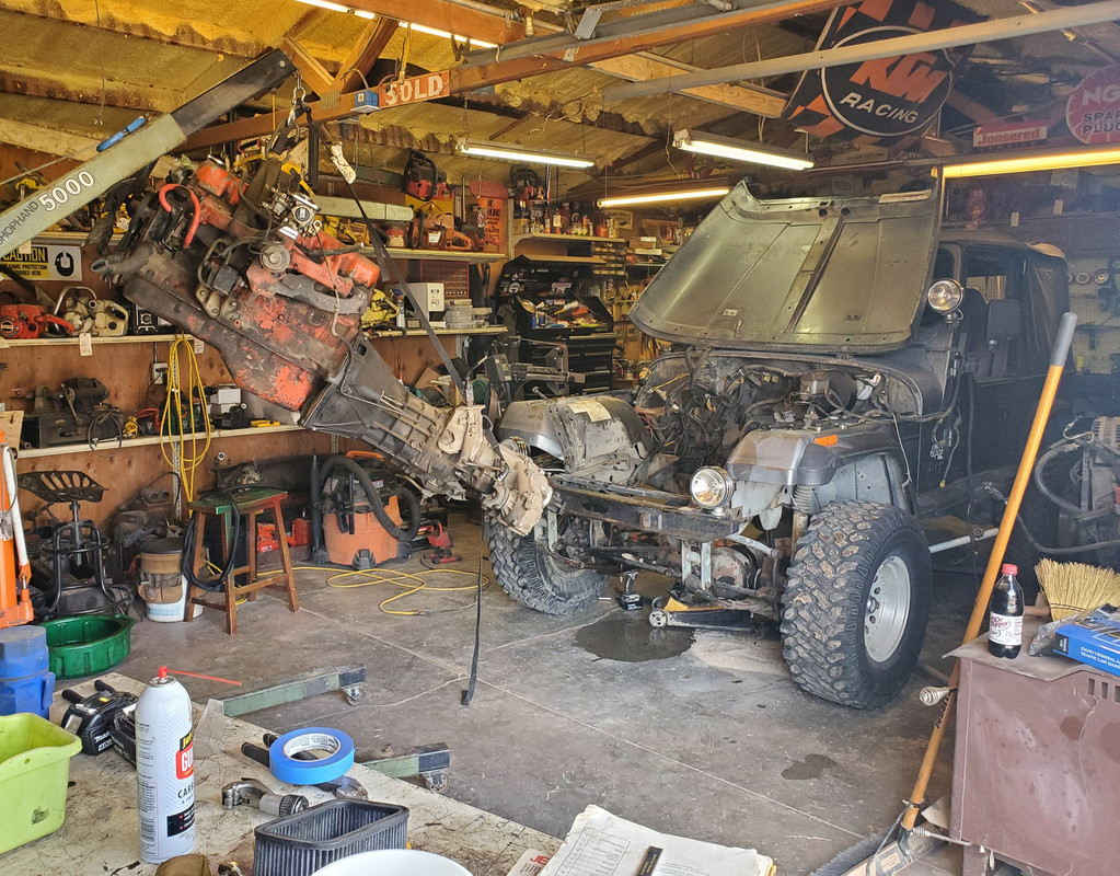

Had a pretty good afternoon in the shop. The engine, transmission, and transfer case are out! Parts are ordered to adapt the engine to transmission.

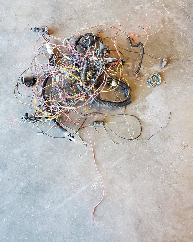

With the engine out, I was clear to start thinning down the harness. This is all of the stock emissions and vacuum control wiring from the MCU (under the dash). Since NONE of it is required for the conversion, it all goes away.
When it is all said and done, I'm left with just the wires coming from the main bulk head connector. None of those needed thinned, they just needed pinned out so that I knew what was what for wiring into the new harness.
Tomorrow, I'll reloom the harness, reroute it, and start on the fuel system modifications (add an electronic fuel pump, new 3/8 feeder line, remove factory 1/4" return line, etc). If I have time, I'll get the 4.2L motor mount horns cut off the frame and the M.O.R.E. horns burned in with the mig welder.
