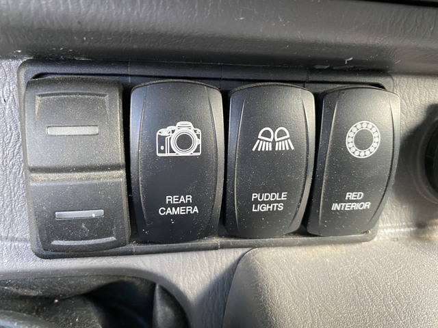

Edited for simplicity.
How my Pioneer unit works, when the camera comes on, the screen switches to the camera view. The camera is powered by the backup light circuit.
My switch just controls which camera gets power.
The camera's video feeds just go into a simple "Y" RCA connecter, then to the head unit.
Three position rocker switch (two would have worked) sends power to either the upper or lower camera.
Camera switch is just 12v, makes the head unit think I'm in reverse when I'm not.
(A good question might be, don't your backup lights come on when you use the switch? No. But I don't remember why not.
Isolated it from the backup circiute using a multi pole switch maybe? I't been several years now. lol)

Thats great cas, thanks!
