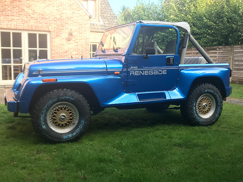

Originally Posted by WestfieldMX5 View Post
Got some 31 Cooper Evolution MTT's <img src="https://www.jeepforum.com/ubb/smile.gif" border="0" alt="" title="Smilie" class="inlineimg" />
That has to be one of the cleanest/nicest looking renegades
