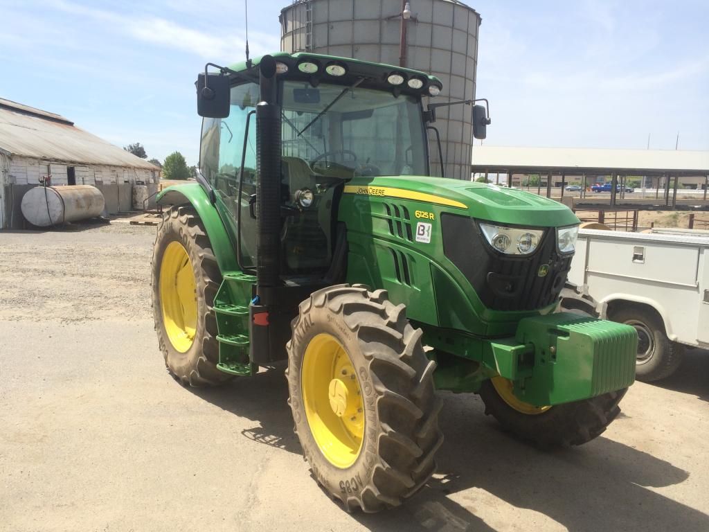

Close enough. I picked it out of the junk bin when I picked this up at the dealership this morning

Thats purty. I actually had to fight a fire on one of those recently. Some sort of electrical component shorted and started the fire. The family had it for just a few months too, felt bad for em, was a total loss.

I was going to say tractor. But I was like meh probably not lol!

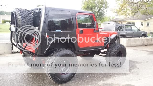

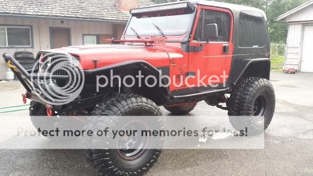

Threw the had top back on it for ****s and giggles!!

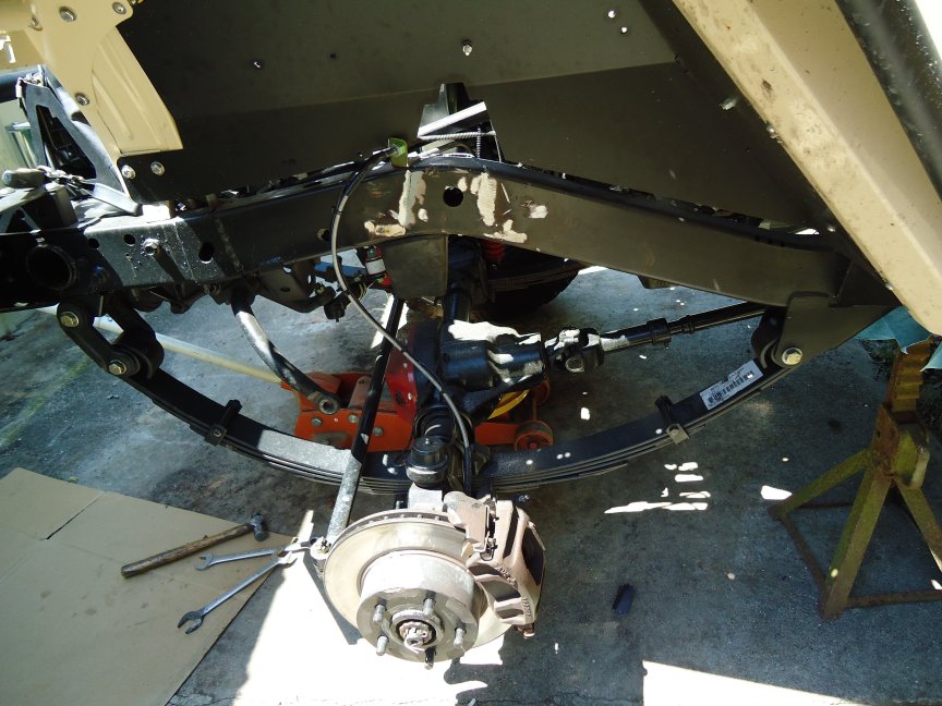

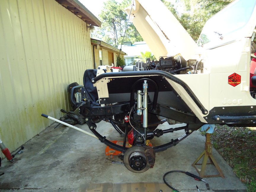

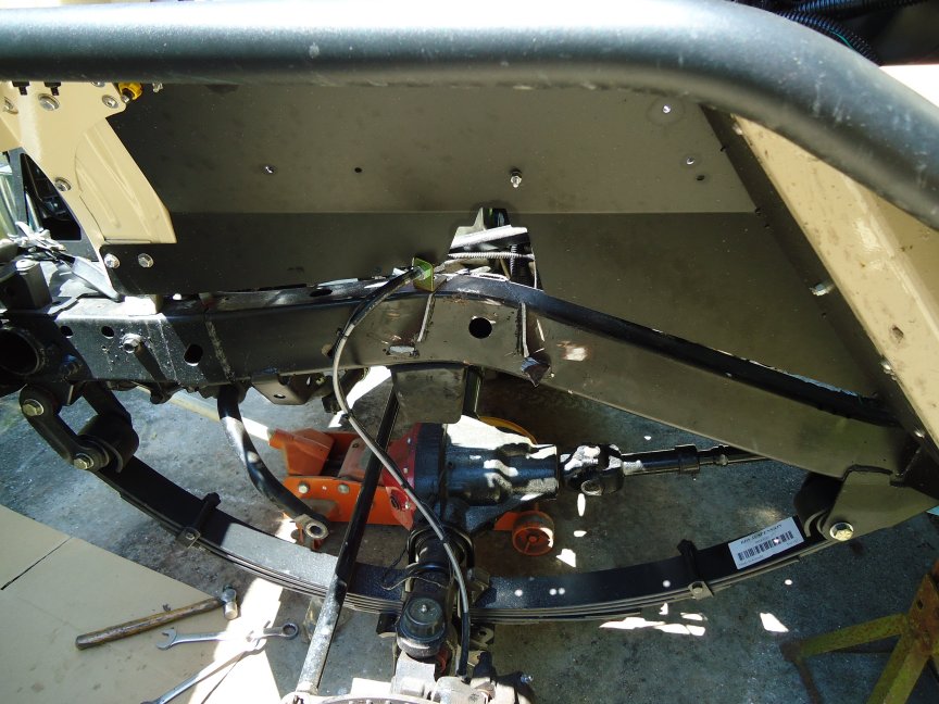

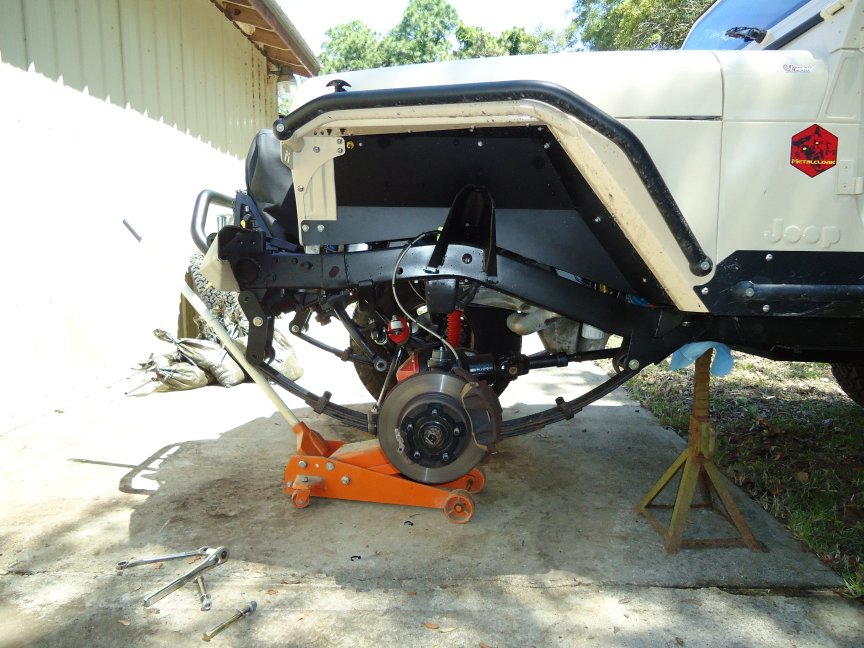

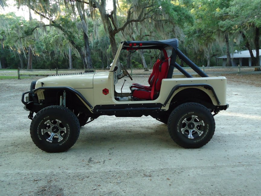

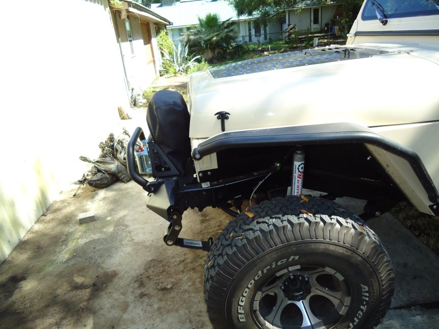

cut my shock towers off, welded on the hoops from wfo, fitted bilstein 5165 and 5" bds springs on front. Installed Bilstein 5125 in rear. I have the bds 3.5 in rear and for the first time my jeep now sits pretty much level. With the weight of the Metal Cloak, warn 8274 and v-8 it was about 2" low in the front with the 3.5" BDS springs on both ends
