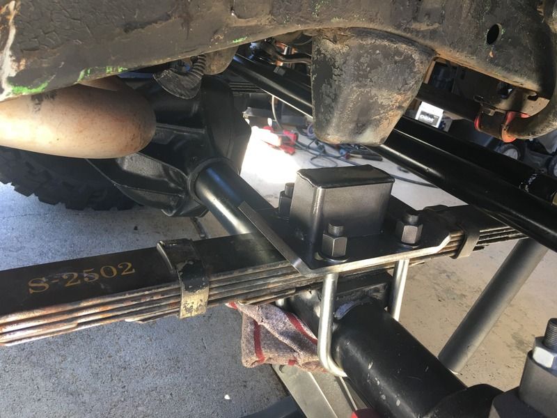

RAND, Wow, I didn't really notice the 2nd pic earlier. springs look bent thru 4 of the 5 leafs... Not sure what would prevent that in the future

@JeeperDon is there any chance you have a pic of the spring mounted?

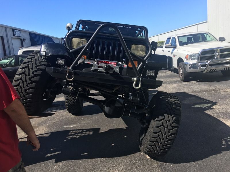

They flex well too. Even with my up travel limited.
Brake line being too short was limiting factor in this picture.

Originally Posted by 87TPIYJ View Post
...Even with my up travel limited...
I had to do that too, fab up some taller metal bump stop towers above the axle u-bolt plate. I just get a bit tire-lug-on-fender-flare flutter when stuffed. I always forget to mention bump stop work when these 'how to SOA' threads appear.
