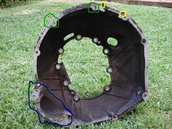

Gather your parts, and keep on this thread. We will help you through it. Some things to consider ahead of time: First common issue--spray some PB on your skid plate bolts, 3 on each side, if you are unable to break them free with a "test" ahead of time. You can drill a tiny hole thru the frame at each of the bolts so you can spray the bolts on the inside of the frame. Second common issue--there are 2 E12 Torx bolts at the very top of the bellhousing. You won't be able to see them from below unless you know they are there. They are very very tight and you should go get an E12 Torx socket for them. They can be best reached from the inside of the jeep thru the transmission tunnel opening once you have removed the shifter and shifter boot. You will need to use several long extensions to reach them. They are high up, just barely below where the cylinder head mates with the block. Beware the E12 Torx bolts. Third common issue--do not cut the white plastic shipping straps on your new external clutch slave. The white plastic jock strap thing is designed to hold the piston on place. Install it as is, the white straps will snap the first time you push in the clutch pedal. If you don't have the action arm installed properly in the dimple on the end of the clutch arm and you do this, you will launch the piston and game over with that set.
This is a photo of the 4.0 YJ bellhousing for an Internal slave setup. You will see that the Blue circle is where the starter goes, the 2 Yellow ones are where the CPS bolts in, and the 2 Green ones are where you will find the dreaded E12 Torx head bolts.
Keep your questions coming, post photos along the way.
