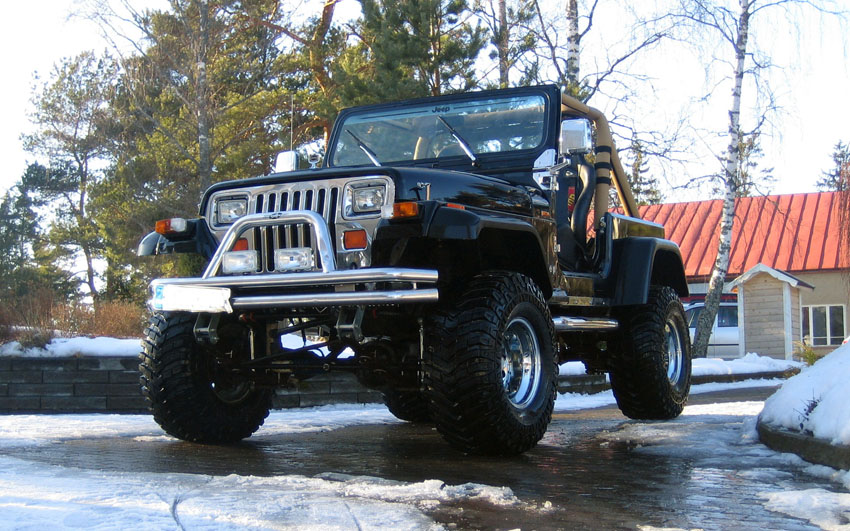

Lets start then! No one want to read my nonsense-english, so i'll try to keep it short and put lots of pics. First picture is how jeep looked when I bought it 3 years ago, it was little pimped already, but there was parts that i really hated and it was kinda moving piece of **** (nothing worked how it should)

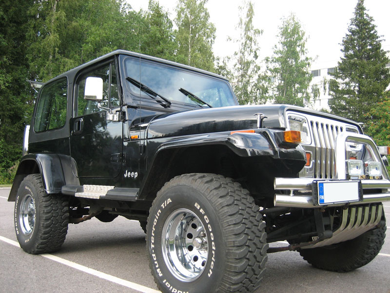

Here are pictures of current state..
Little more welding, grinding, praying and changing few parts (takes time because i'm from Finland (not that we Finns are that slow) and it takes time to order things from USA, lot's of places wont do international orders and some places trying to rob me with international wreight charges!
Cant member even half of the new parts it has gotten while living with me but it now haves 35-13.5x15 maxxis mudzilla tires, SYE, CV shaft, 1.25" motor lift, 1.25" body lift, RE 4.5" ED, traction bar, new fender flares, new seats/belts, half doors, duster top, soundbar, hi-lift, bimini and lots of "bling" and other things i cant member anymore. After its having new paint job (hopefully in month or two) i'm going for Ford 8.8 rear hunting, even thought i have drived it like maniac (offroad) and D35 still works strong!! One broken CV driveshaft so far, so i guess i have had luck or previous owner in Germany has installed superkit for D35 or something..oh, D30 has been broken once but it's fixed again.
What to you guys think? about paintjob? Should i go with original black color or something else? I have been wondering about pearl white, dunno.. gimme some tips and motivation to finish my project

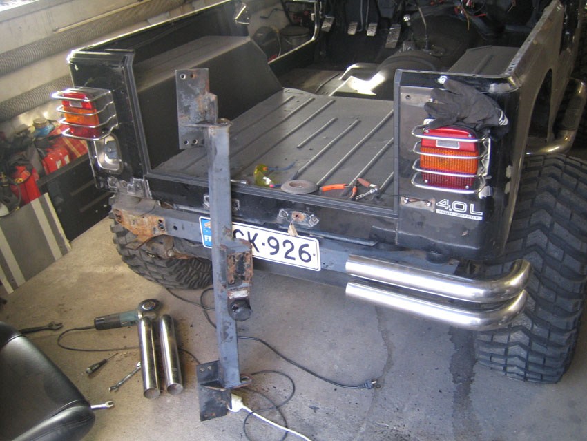

I was removing hitch-assembly yesterday to get "bling bumbers" closer to the body, i was getting stuck because hitch assembly sticked too far out - it was kinda bended too. Now getting ready for CJ7 tailgate, will make order today with some other stuff.

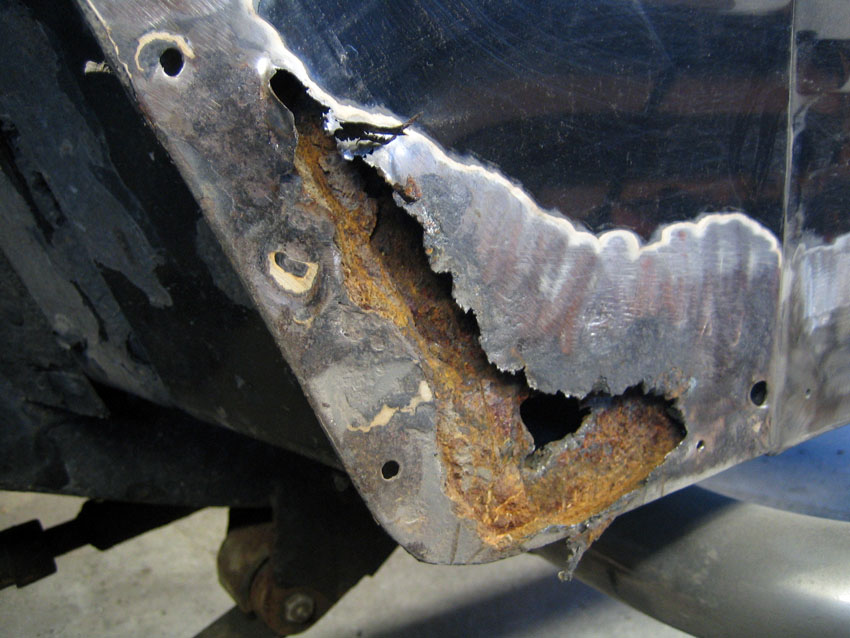

No pictures of rust before! When starting this project didn't take much pics, tough that most of the bigger holes were done, but found little surprise under TOTALLY GOOD PAINT! there wasn't any signs at all on the surface.. well, it's not that bad but was really hidden good. Well, I'm not going to fix it because its not only problem with fender - will order new fenders.

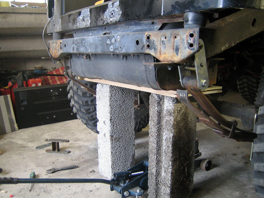

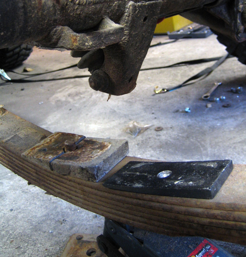

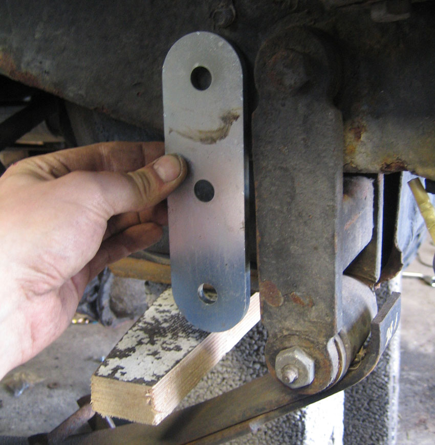

Installed RE 4.5" ED kit year ago and was too lazy to change rear shackles+ bushings. Old shackles were longer too so figured they were better because I would get even more lift.. have been wondering my non-existent rear flex - and Jeep rear-end feeled to act strange, making knocking noise. Old shackle (which sheared rear frame) and new ones, which I installed without center bolts to get more flex and avoid frame contact.
Also took 8 shim plate out and replaced with 4, didnt have time to check pinion angle yet but atleast it was wrong before, i think it's better now. There is also one pic with new shackle other corner and other corner with old one, see difference between springs? I think now they work like they are supposed.

as far as the r/e springs, i had those 4 1/2 extreme duty on my jeep(see pic) and they were awesome. make sure your spring bolts/shackle bolts are torqued to about 35-45 lbs, not to tight to limit movement, and grease them up if they are not. also check brake lines and shock travel so they aren't hitting
also they need to be flexed and used offroad to break them in and soften them up when new. make sure your axle ubolts are real tight.

Please tell me your just holding up the gas tank in that last photo????? I had to make a quick trip to the hospital after using 'questionable' support methods. Just saying.

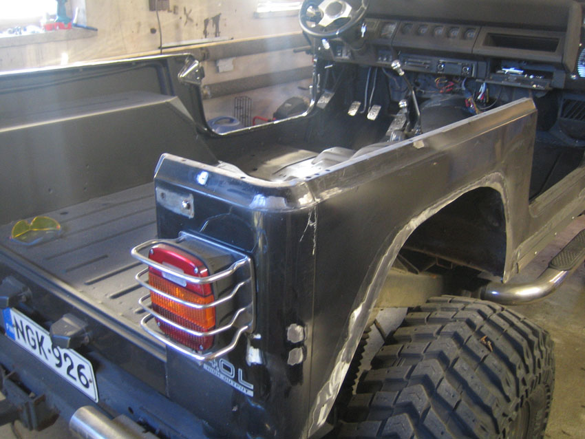

the tub looks great, what exactly did you do to it?
Thanks for info about lbs torque on spring/shackle bolts, I have been running this lift for ~2years and havent been happy with it, feels like "rock" when driving on normal roads.. might be this also? with wrong shackles.. let's see, i will check torques.
But it's shocks what i'm worried, people say what I ordered now is "overkill" dunno, bad or good.. how is your steering? Mine is horrible, I think im going to add shim's to front axle also to adjust caster, maybe this helps?

Gas tank holds jeep there! Had stoppers on front wheels of course, and when I'm under car its double secured with jack of course, but had to remove jack under rear axle to take this pic -> only way to show difference between leafsprings with different shackles! And my girlfriend is a nurse!!

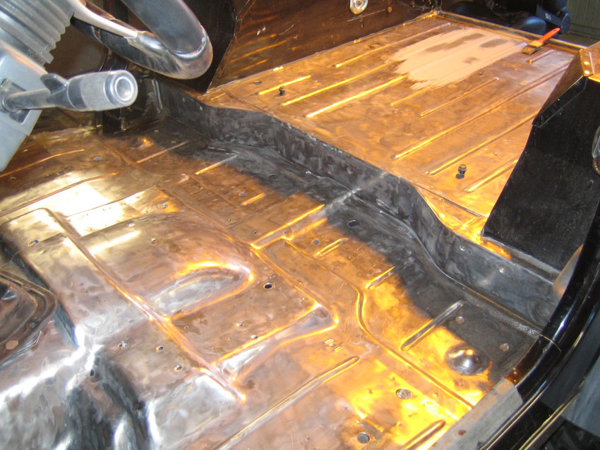

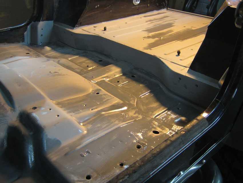

Removed all rust/paint, welded small holes and one bigger one, cleared with alcohol based stuff, painted with Zincpaint (2x) and then used 3-4 layers of rock protection paint, it's little like bedliner, contains rubber also but doesnt look that ghetto. Zinc is higher minted element than iron so it's very good for corrosion/rust protection. If you know boat motors, there is Zinc near propeller and it does same thing there in salt water, this works exactly same way.
If someone does this, remember that there is not many paints that will be good with Zinc.
