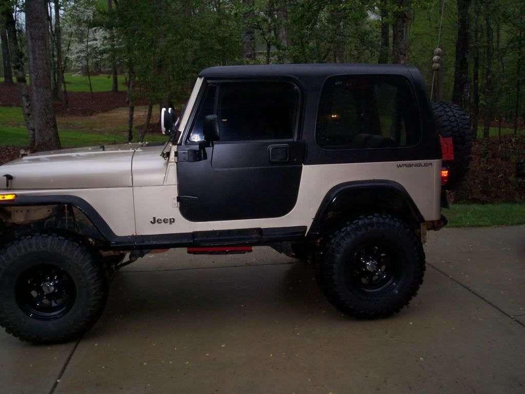

Not the whole jeep buy you can get the idea
Did the doors inside and out, and the top inside and out with rustoleum semiflat black. I did all the prep and paint in the backyard and in the garage when it was raining, came out really good for a backyard job. I have seen others who have done the whole jeep and it looks good.

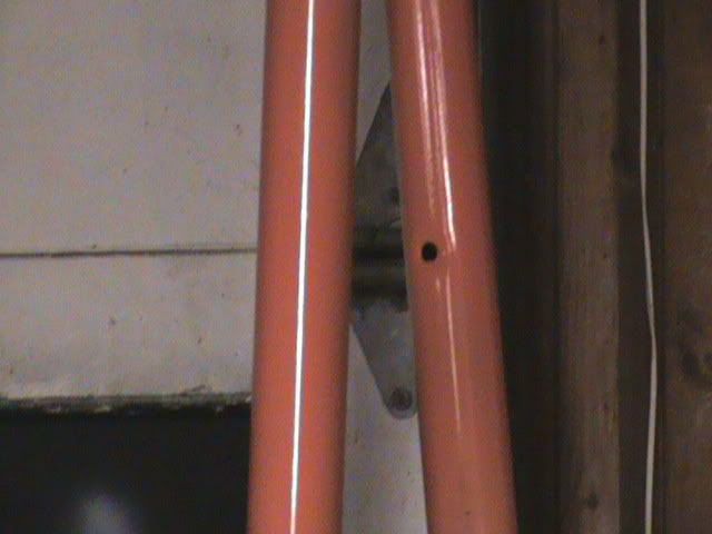

Mines not done yet. Here is the color scheme Im going to run,
Black on the rig, hugger orange for the roll bars and engine accesories.Also some of the dash and interior will be orange.
Here is a shot of part of the rool cage...
It only has one light coat so far, but you can see the color pretty good.
Just take your time and lots of light coats and you wont know its a rattle can job.
Its not that hard, just some time and common sense really.
What color you thinking of running.

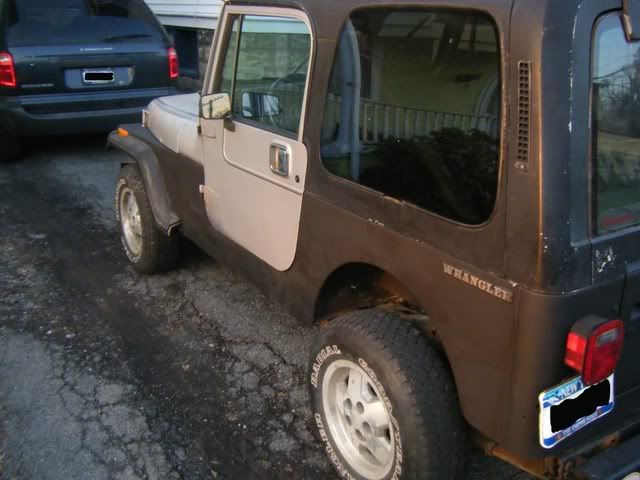

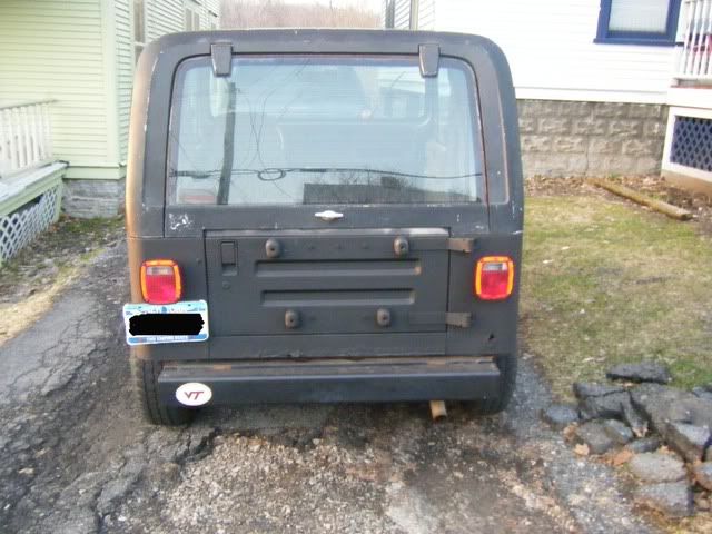

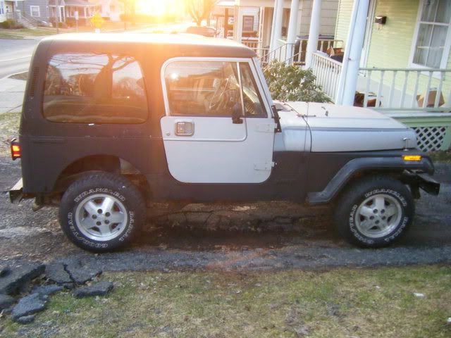

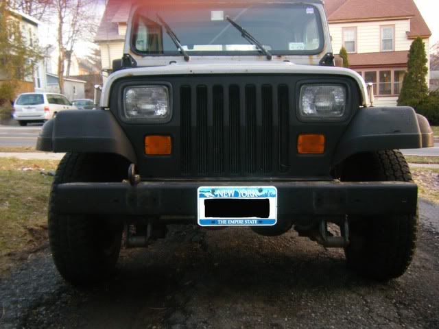

Heres mine, did it amonth ago....less than $100
and before

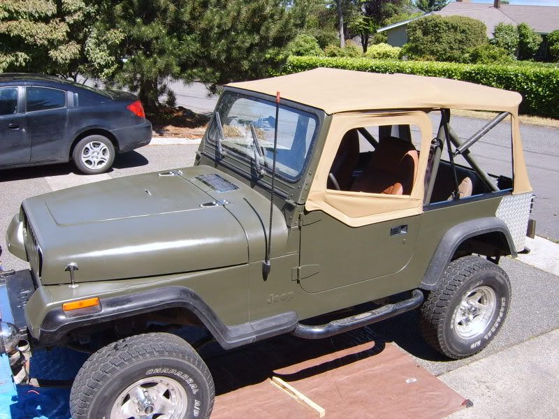

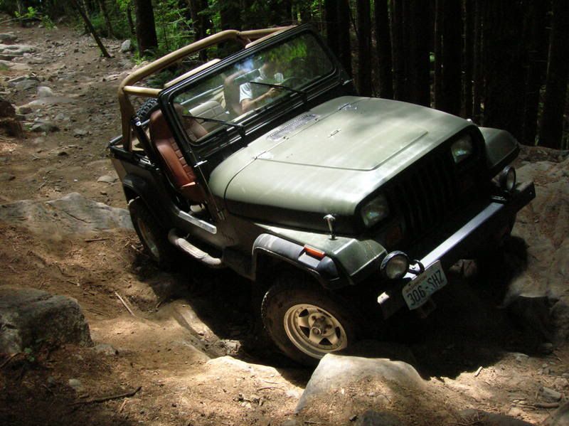

Olive Drap using the krylon camo paint

That looks extremely familiar
The only thing I found was the olive drab krylon camo seems to scratch extemely easy, as in run your finger nail down the side of it and it scratches. I followed up with some clearcoat from schucks just to be safe. Whole thing took maybe 12 cans of color, inside and out about 4 coats. Another maybe 6 cans in clear for 2 coats on top of that.
A year later and its starting to fall off here and there, mainly on the grill. But...thats why i ordered 18 cans Easy touch up
