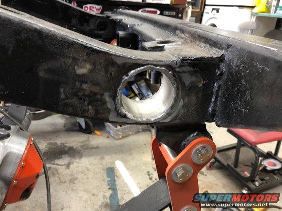

I think as long as it is fully welded in at every edge it should be just fine. I didn’t French my rear shock towers but I did slice a 3” hole right thru the back of mine where the stock rear shackle mount was to run my exhaust thru. I sleeved the hole with some round tube and fully welded it all the way around on both sides making it an integral part of the frame. I’m not too worried about it hurting the frame strength.
interesting. does that exhaust rattle in the frame?
So far no it hasn’t made a peep. The exhaust itself is pretty solidly mounted. I also have it wrapped and the wrap does slot in on the inside of the frame to help cushion it.
