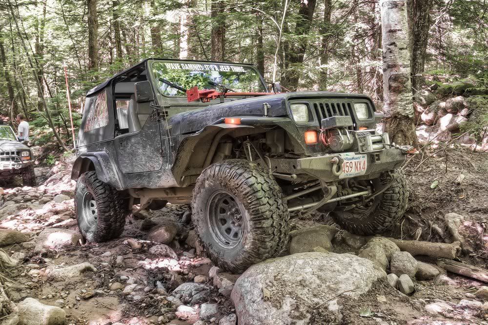

I've had my TJ, my first Jeep, for over a year now. Bought it as a beach rig and discovered wheelin' last Fall. Was just at the beginning of the buildup when one of the parts I bought (Dana 44 from a TJ) wasn't correct and the whole budget house of cards tumbled down.
A nice wheelin' YJ appeared and I bought it last night.
Here's the specs from the craigslist ad:
The good:
  • 2.5L 4 cylinder
  • AX-5 manual tranny
  • 3.5" black diamond suspension
  • Dana 30 front axle with ected locker, geared 4.88, vacuum disconnect removed
  • Ford 8.8 rear axle with ected locker, geared 4.88, disk brakes
  • Durango power steering box
  • bullet proof tie rod and drag link
  • nate 4x4 front winch bumper
  • smity built rear bumper/tire carrier
  • NP231 sye kit on transfer case
  • tom woods custom rear drive shaft
  • high tire clearance tube fender front and rear
  • K&N cone filter and rusty air tube
  • warn gas tank skid
  • stickers that add a ton of horse power
The bad:
  • crack forming at power steering pump on frame
  • starter on the way out
  • no rear shocks (been like that for many years don't even notice them missing)

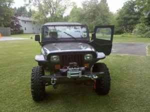

And of course pix from the ad. (It is on 34x10.5 in the shots. They did not come with it. I have inspection tires on it now. I'll be putting my 33x12.5 TrXus on it.)
I need to do a few things right away. The top is abysmal. Would love some recommendations on a YJ top. I'll need a new frame for it or would love a bowless design like the Rampage for the TJ. I do have the family cage.
Frame crack looks minor and easy to fix, some fab work will be needed to add rear shocks, it needs them in my opinion. I have an Anti-Rock that I'll get out of my TJ and see about putting it in. Not too comfortable running without a swaybar on the street.
Need to replace the starter.
The inner fenders are gone, pulled when the very sturdy tubes were put in. I'd like some just for looks and so cops don't think it is a cob-job.
Oil pan is bashed in, probably want to replace that and put a skid over it.
Need to install my CB and buy a hilift. I can probably afford a winch now, that's great. Why can I afford it with all the above work.
I paid $2650. I got a beat looking trail rig, what I've always wanted. And I have a buyer for my TJ already, we just haven't agreed on price. Life is good.

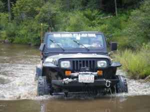

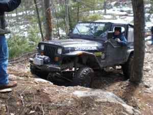

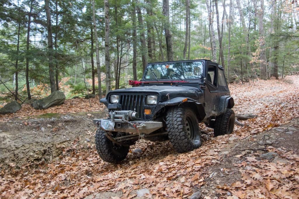

Here's some shots on Class VI roads in NH.
Check out the brake lines on the first shot. Oh boy! I'm looking to replace them but I measure them at 25" and the longest I can find are 24" so that's not going to help. Maybe measure again... At least the maxxed out shock is keeping the brake line from snapping!

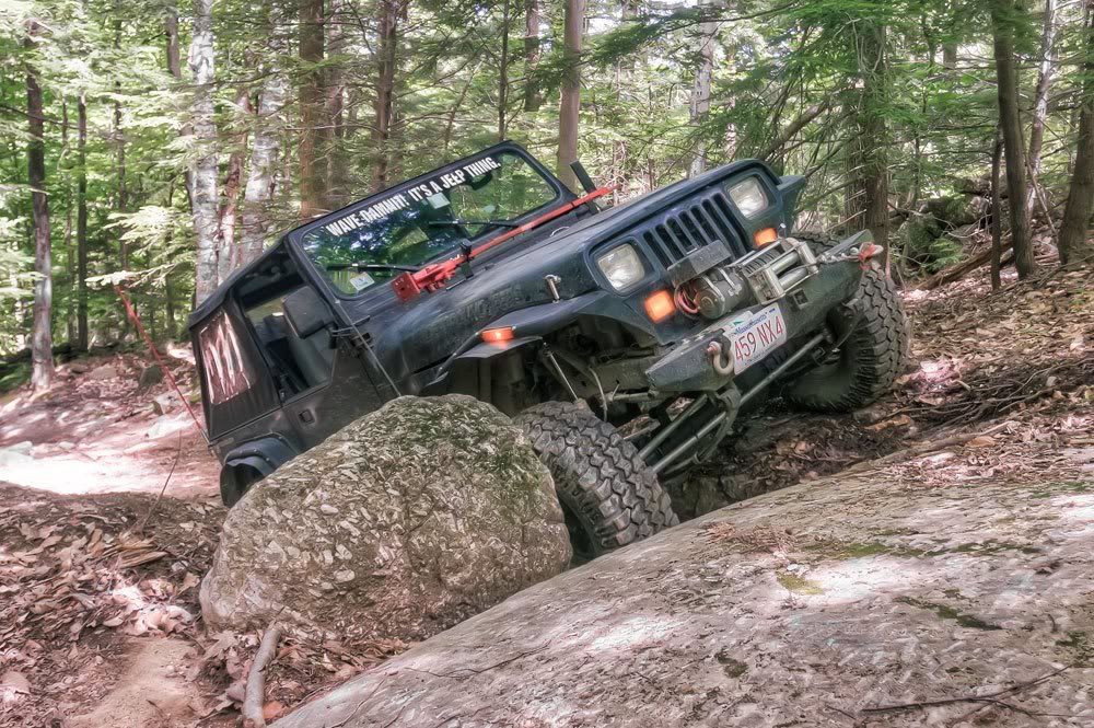

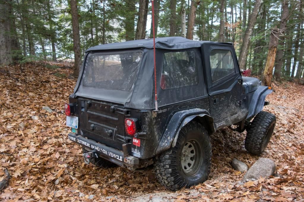

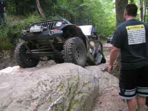

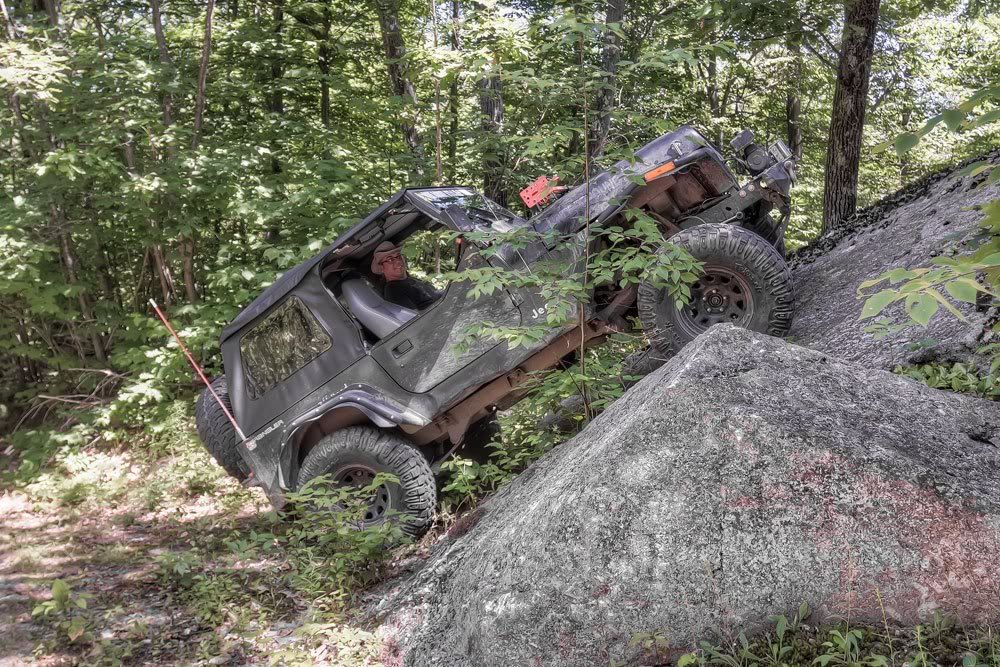

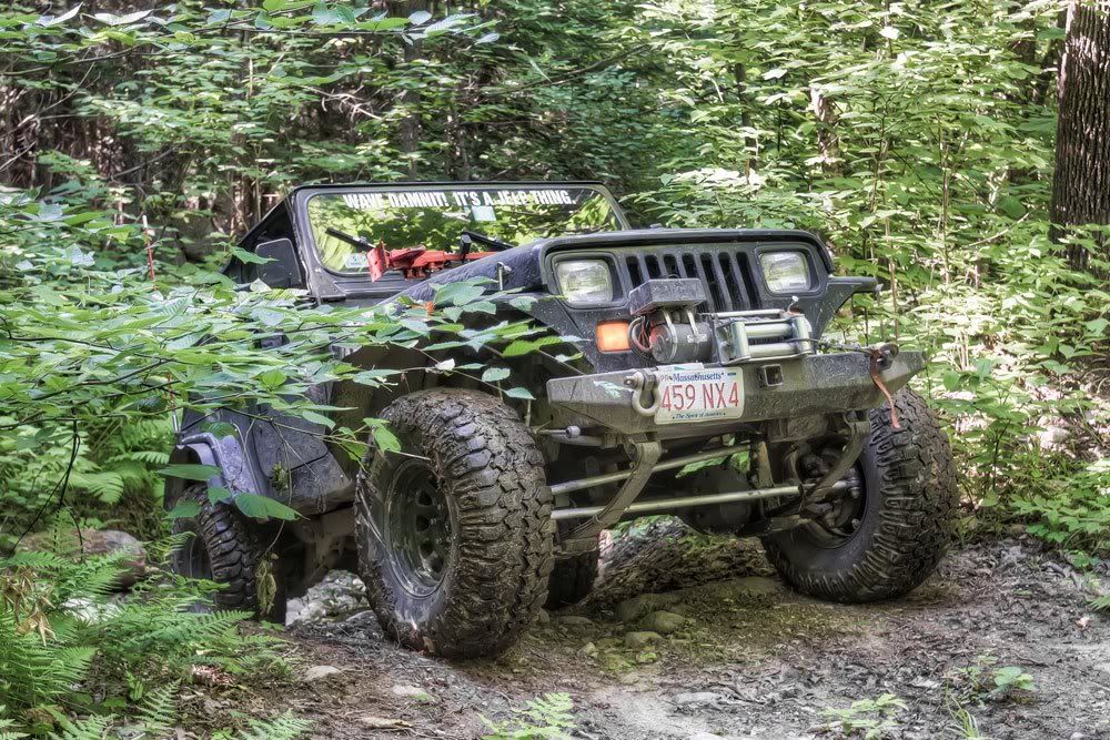

And here's some eye-candy. This first was the closest I've come to rolling.

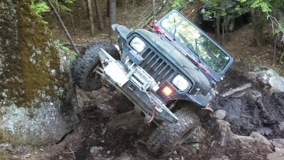

And here's some showing when I stuffed the passenger side rear. Sadly I didn't get a close up.

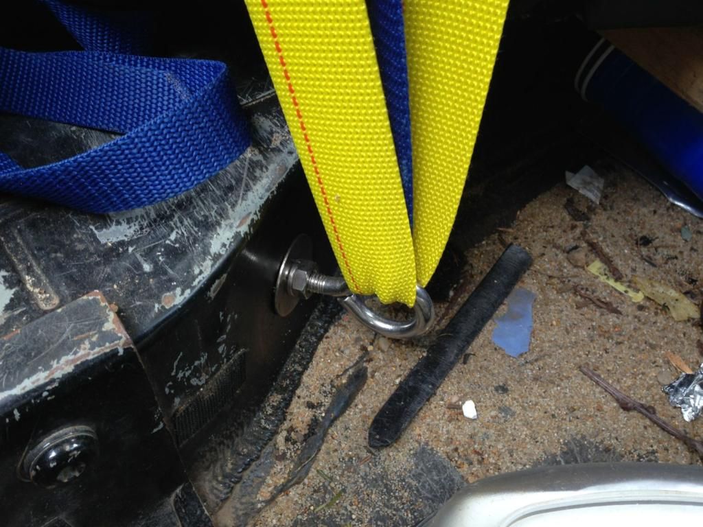

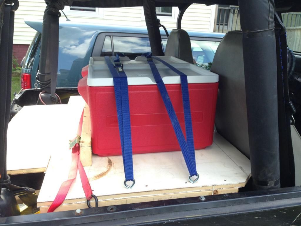

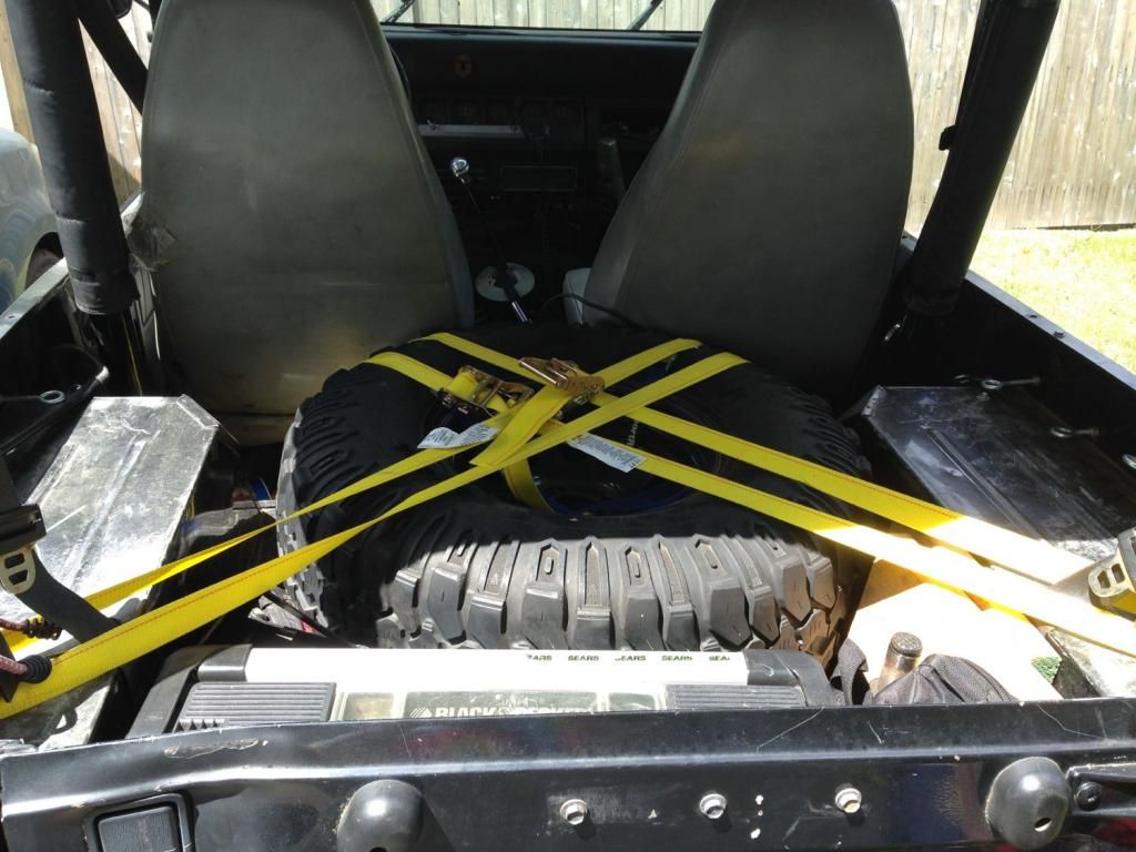

And here's what we did when the rear tire carrier failed. Best mod ever, we can see out the back now! The ratchet straps are, I think 20,000lb one, found them online. I did not want a 100lb tire in our backs during an accident.
And a wood platform with the low riser coolers on top. We can see over this with the rear view mirror.

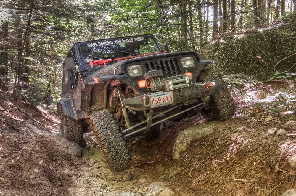

Ok, maybe some modifications. That's not me BTW, that's my friend Chris who knows what he's doing.
