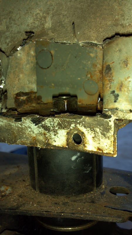

I have been doing a lot to my Jeep lately and plan on doing more in the upcoming months and I wanted to do a "build" style thread. I just recently installed a 1" prothane body lift to replace my rotted out original body mounts. I wanted to add some pictures of my Jeep when I first got it, but I will need to scan those in and post them later, so this is going to be a little out of order, but hopefully it will all come together in some sort of Pulp Fiction-esque story line.
my system to lift the body up
one of the side mounts
another side shot and the mystery puddle that appeared after I jacked up the body...i think it was power steering fluid, but I couldn't figure out where it came from exactly
the last front mount
had to perform some minor can opener surgery to get to the back mount after i broke it
close up view
more can opener surgery for the inside mounts
sunday with the top off after completing the lift
and here it is today after I washed her up

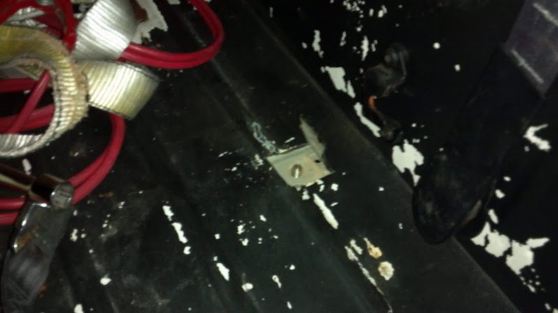

Been doing lots of stuff lately, went ahead and ordered the raptor liner which came in already and started getting the jeep ready to be lined. Removed everything from the tub to start sanding and prep work. I had previously used a spray in duplicolor bedliner which did not last very well, nor give me the texture that I was looking for. So I am having to not only sand the interior but try to get rid of most of that previous attempt at a bedliner.
Here is a picture of the jeep tub emptied out:
Had to cut out the rust spot to fit in the new pan:
Put the driver's seat back in and drove it over to a friends house to weld in the new pan. Driving with that huge hole in the floor was pretty awesome. Went ahead and welded it in. I need to state that I have never welded before. He did the first welds, then let me go at it. I am not certain how good it looks, but I am going to be covering it up with the raptor liner, so i dont think it should matter too much.
close up of the weld:
headed back over to his house tonight after work to finish up and to address the little issue that I discovered while cutting out the main rust spot. I think I am going to go ahead and spray bedliner under the door entries down the rockers.
Excited to get these rust spots fixed and finish the bed prep so I can spray in the raptor liner.
