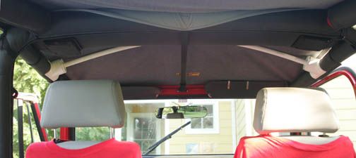

I use it under my trail cover , to keep water from pooling on top. PVC from Lowes. shown here under my safari. The pieces are just pushed together, I didnt bother to glue it. And I can drive with it on under the safari.

sjlplat
Guest
Join Date: Oct 2004
Posts: 1,226
Awesome idea. Looks to work just as good as the mass-produced stuff.

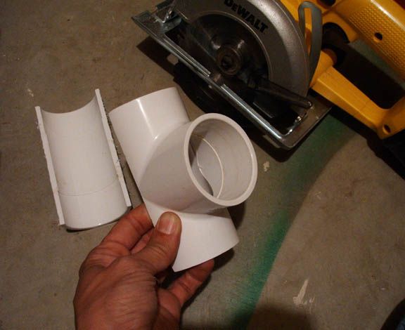

Here it is (see pictures, since I’m not exactly sure what they call these parts, and I got them all in the PVC plumbing dept at Lowes)
two 2” tee pipe fittings (although a friend pointed out one four way would work instead). Cut the main tube in half (I used a trim saw with a fast cutting wood blade and it easily cut it with no chipping)

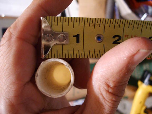

1/2”x 10’ PVC pipe. The thin cheap stuff, ten feet cost me $1.07 I cut mine to 46” and I think it may be a bit long. Since its not glued, it can easily be shortened. Here’s a pic showing how thin the wall is.

Step one, cut the 2 inch PVC cross in half so that you end up with two "T" pieces. They will both sit on the padding of your roll bars.
