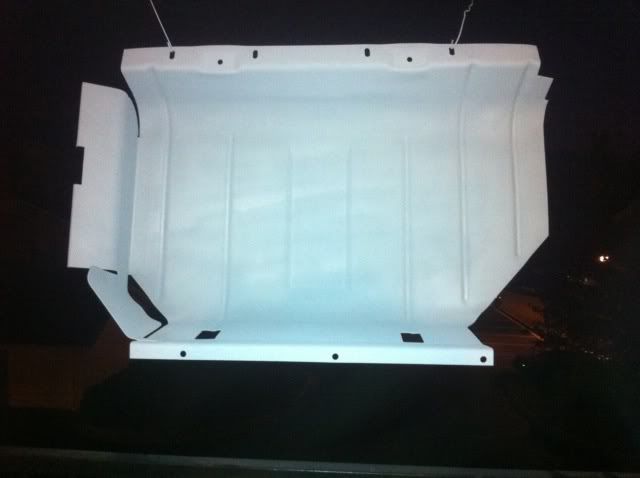

I finally got my gas skid back and blasted. I also made a stop by Lowe's after my jog.
Here's the blasted skid.
I wiped it down with a wet rag and after a couple minutes it started oxidizing.
Primed:
I also painted my jerry can with camo green. It was close enough to OD green to me:
All painted off the back porch of my apartment. Yes I'm the guy with auto parts hanging off the hooks on the deck.
Tomorrow I'm going to smooth out the gas skid with some steel wool and wipe it down. Then I'm going to put some black gloss paint on it. I was torn between flat black and gloss. I figure it won't matter after a couple months plus I had some extra gloss black in case my one can wasn't enough.

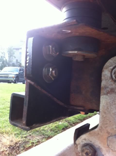

Today I finished up the latest mod. Well add-on I guess. I don't have any kind of rear bumper or recover except a tow hook through the frame. I also can't tow anything. A buddy gave me his old Curt trailer hitch. Since I don't have the dough to spend on a bumper/tire carrier (saving and there are other more important things I need for the jeep)this was the best option and it was free.
I put (10) Grade 8 bolts through the rear cross member and one in the tapped hole under each end of the frame. I also made some backing plates for the (8) bolts going through the rear cross member out of 3/8" steel plate.

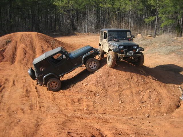

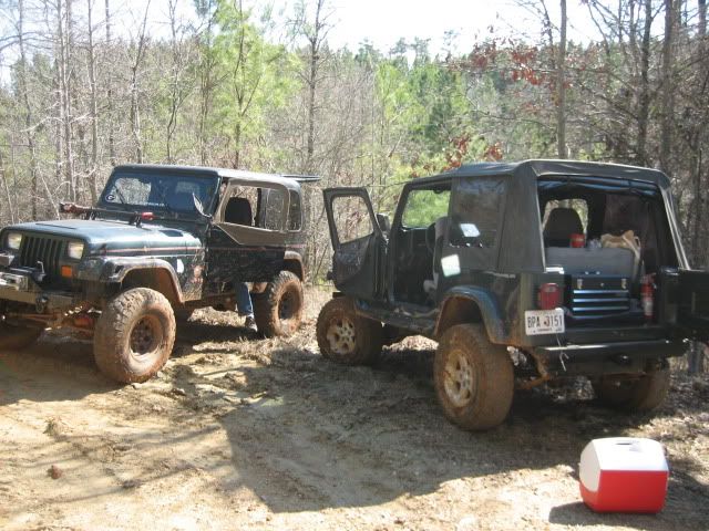

I was looking through some of my photo albums on my computer and found some pics from Durhamtown on page 1 that I finally got from my buddy. I figured I'd post them just for kicks and giggles.
