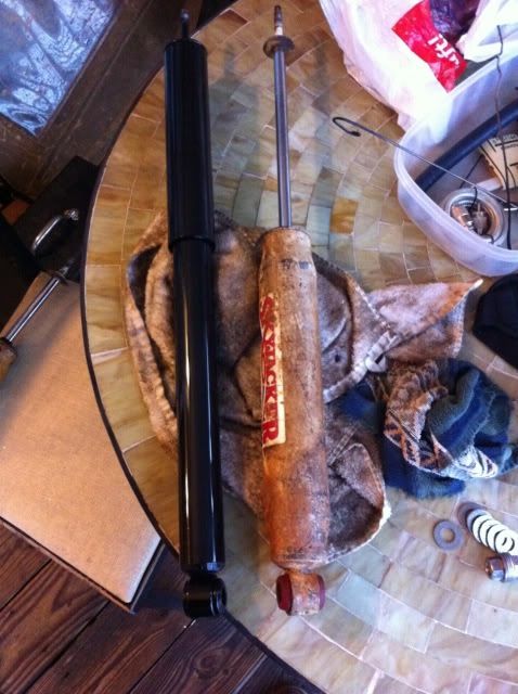

After my last wheeling trip I noticed my front shocks were spewing fluid out of the top seal. Upon inspection the seals were cracked and the piston shaft was pitted. I took the front shocks off and found they didn't have near the resistance going downward versus upward. Also one piston sank down by its own weight when I unbolted it from the upper mount. Not good. They also look like pure doo doo.
So I took my old shocks to the Summit Racing store and found out they had the same Skyjunkers for $45 each. I didn't want to put those back on so I tried to size up other ones but Summit wasn't able to do so. So I whipped out my phone and pulled up the Monroe shock catalog with all the mounting and length data and I found some Sensa Trac light truck shocks that matched what I needed. They were $25 a piece with a lifetime warranty from Autozone. I know you get what you pay for but I'm about to on a wheeling trip to SC, they are better than what I have and gas isn't getting any cheaper. On top of that Rancho, Monroe, Gabriel, etc are all made by the same company anyway. I just wasn't ready to throw down $80 a shock yet. Here it is.
I'll have them mounted this evening.

Overall my jeep took some minor beating but nothing its not used to. Here's the shocks I will be replacing soon. The top seal is shot and the shaft is pitted plus it was spewing fluid with all the bumps. I took them off and pulled it in and had a lot of resistance. I pushed it in and it was noticeably less resistant.

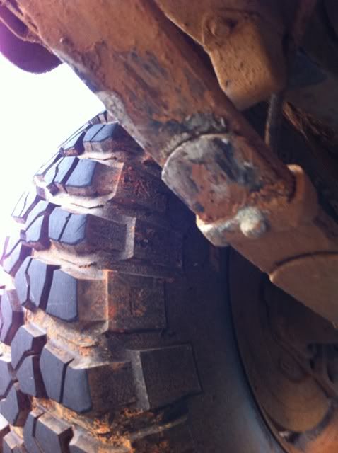

Here is a good reason to do a u-bolt flip on the back. I keep snapping these u-bolt studs off. I finally got off my butt and cut the other down to 1/8" of thread sticking out.
I'm sure this helped climb the 3' rock walls.
