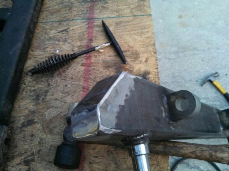

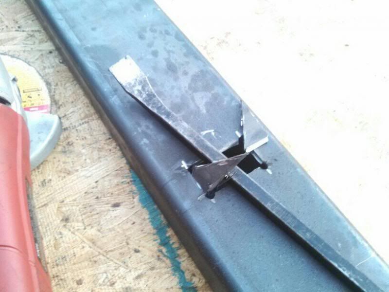

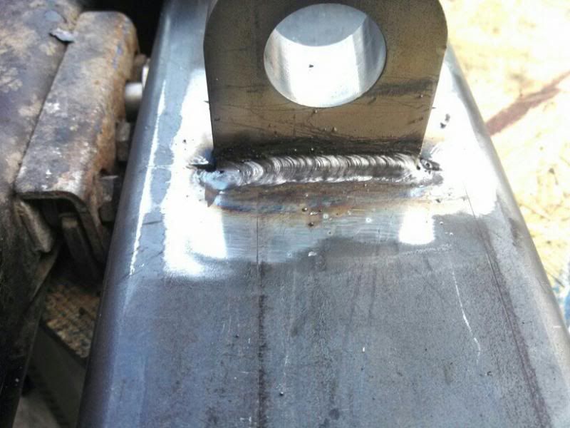

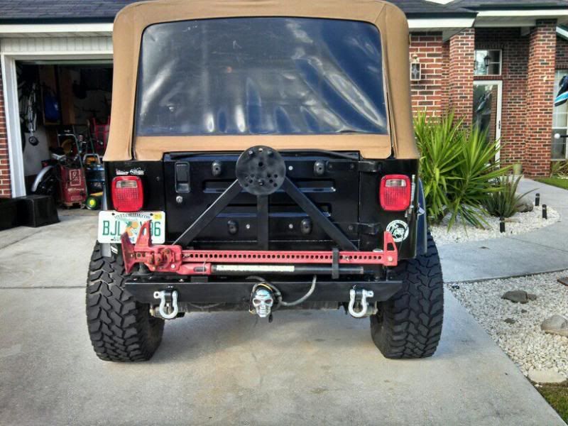

Little update of what has been going on. I finished building my spare tire carrier. Here some pics of the process if anyone wants any details let me know
Cuts for the clevis mounts
End caps

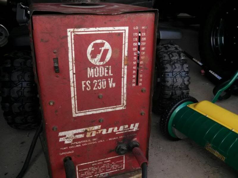

I installed a 240V outlet becuase my HF POS wasnt cutting it. My first time with a 240V STICK welder (40-50 yrs old I might add) 7018 rod. Some weld porn
Finished product

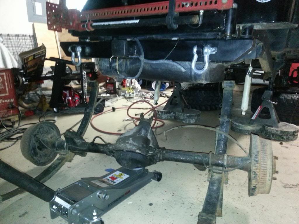

Well it has been a while for me posting here. After making a spreadsheet to map out parts and prices of my 1 ton SOA swap and the fact that any decent offroad Park is 7+ hrs away from me, I decided to just do 8.8 rear SOA. I just couldn't justify the cost of the swap. The sterling I bought ended up being trashed on the drivers spindle so I scrapped it and am trying to sell the locker. I have already sold the Dana 60 ARB. So I picked up an 8.8 with 4.10s and lsd. I'm also doing a belly up skid.
Parts ordered/purchased :
<TABLE style="WIDTH: 164pt; BORDER-COLLAPSE: collapse" border=0 cellSpacing=0 cellPadding=0 width=219><COLGROUP><COL style="WIDTH: 164pt; mso-width-source: userset; mso-width-alt: 8009" width=219><TBODY><TR style="HEIGHT: 15pt" height=20><TD style="BORDER-BOTTOM: #f0f0f0; BORDER-LEFT: #f0f0f0; BACKGROUND-COLOR: transparent; WIDTH: 164pt; HEIGHT: 15pt; BORDER-TOP: #f0f0f0; BORDER-RIGHT: #f0f0f0" class=xl65 height=20 width=219>Front Drive balance</TD></TR><TR style="HEIGHT: 12.75pt" height=17><TD style="BORDER-BOTTOM: #f0f0f0; BORDER-LEFT: #f0f0f0; BACKGROUND-COLOR: transparent; HEIGHT: 12.75pt; BORDER-TOP: #f0f0f0; BORDER-RIGHT: #f0f0f0" class=xl65 height=17>Exhust insulators</TD></TR><TR style="HEIGHT: 12.75pt" height=17><TD style="BORDER-BOTTOM: #f0f0f0; BORDER-LEFT: #f0f0f0; BACKGROUND-COLOR: transparent; HEIGHT: 12.75pt; BORDER-TOP: #f0f0f0; BORDER-RIGHT: #f0f0f0" class=xl65 height=17>Exhaust C clamps</TD></TR><TR style="HEIGHT: 12.75pt" height=17><TD style="BORDER-BOTTOM: #f0f0f0; BORDER-LEFT: #f0f0f0; BACKGROUND-COLOR: transparent; HEIGHT: 12.75pt; BORDER-TOP: #f0f0f0; BORDER-RIGHT: #f0f0f0" class=xl65 height=17>Exhuast Pipe</TD></TR><TR style="HEIGHT: 12.75pt" height=17><TD style="BORDER-BOTTOM: #f0f0f0; BORDER-LEFT: #f0f0f0; BACKGROUND-COLOR: transparent; HEIGHT: 12.75pt; BORDER-TOP: #f0f0f0; BORDER-RIGHT: #f0f0f0" class=xl65 height=17>Dynomax Muffler</TD></TR><TR style="HEIGHT: 12.75pt" height=17><TD style="BORDER-BOTTOM: #f0f0f0; BORDER-LEFT: #f0f0f0; BACKGROUND-COLOR: transparent; HEIGHT: 12.75pt; BORDER-TOP: #f0f0f0; BORDER-RIGHT: #f0f0f0" class=xl65 height=17>Rams Horn Manifolds</TD></TR><TR style="HEIGHT: 12.75pt" height=17><TD style="BORDER-BOTTOM: #f0f0f0; BORDER-LEFT: #f0f0f0; BACKGROUND-COLOR: transparent; HEIGHT: 12.75pt; BORDER-TOP: #f0f0f0; BORDER-RIGHT: #f0f0f0" class=xl65 height=17>Band Clamps (3)</TD></TR><TR style="HEIGHT: 12.75pt" height=17><TD style="BORDER-BOTTOM: #f0f0f0; BORDER-LEFT: #f0f0f0; BACKGROUND-COLOR: transparent; HEIGHT: 12.75pt; BORDER-TOP: #f0f0f0; BORDER-RIGHT: #f0f0f0" class=xl65 height=17>Corvette exhaust flanges</TD></TR><TR style="HEIGHT: 12.75pt" height=17><TD style="BORDER-BOTTOM: #f0f0f0; BORDER-LEFT: #f0f0f0; BACKGROUND-COLOR: transparent; HEIGHT: 12.75pt; BORDER-TOP: #f0f0f0; BORDER-RIGHT: #f0f0f0" class=xl65 height=17>Exhaust j hooks</TD></TR><TR style="HEIGHT: 12.75pt" height=17><TD style="BORDER-BOTTOM: #f0f0f0; BORDER-LEFT: #f0f0f0; BACKGROUND-COLOR: transparent; HEIGHT: 12.75pt; BORDER-TOP: #f0f0f0; BORDER-RIGHT: #f0f0f0" class=xl65 height=17>Tires</TD></TR><TR style="HEIGHT: 12.75pt" height=17><TD style="BORDER-BOTTOM: #f0f0f0; BORDER-LEFT: #f0f0f0; BACKGROUND-COLOR: transparent; HEIGHT: 12.75pt; BORDER-TOP: #f0f0f0; BORDER-RIGHT: #f0f0f0" class=xl65 height=17>wheels</TD></TR><TR style="HEIGHT: 12.75pt" height=17><TD style="BORDER-BOTTOM: #f0f0f0; BORDER-LEFT: #f0f0f0; BACKGROUND-COLOR: transparent; HEIGHT: 12.75pt; BORDER-TOP: #f0f0f0; BORDER-RIGHT: #f0f0f0" class=xl65 height=17>Crown HD springs</TD></TR><TR style="HEIGHT: 12.75pt" height=17><TD style="BORDER-BOTTOM: #f0f0f0; BORDER-LEFT: #f0f0f0; BACKGROUND-COLOR: transparent; HEIGHT: 12.75pt; BORDER-TOP: #f0f0f0; BORDER-RIGHT: #f0f0f0" class=xl65 height=17>Brake lines</TD></TR><TR style="HEIGHT: 12.75pt" height=17><TD style="BORDER-BOTTOM: #f0f0f0; BORDER-LEFT: #f0f0f0; BACKGROUND-COLOR: transparent; HEIGHT: 12.75pt; BORDER-TOP: #f0f0f0; BORDER-RIGHT: #f0f0f0" class=xl65 height=17>Cross member DOM</TD></TR><TR style="HEIGHT: 12.75pt" height=17><TD style="BORDER-BOTTOM: #f0f0f0; BORDER-LEFT: #f0f0f0; BACKGROUND-COLOR: transparent; HEIGHT: 12.75pt; BORDER-TOP: #f0f0f0; BORDER-RIGHT: #f0f0f0" class=xl65 height=17>8.8 Diff cover bolts</TD></TR><TR style="HEIGHT: 12.75pt" height=17><TD style="BORDER-BOTTOM: #f0f0f0; BORDER-LEFT: #f0f0f0; BACKGROUND-COLOR: transparent; HEIGHT: 12.75pt; BORDER-TOP: #f0f0f0; BORDER-RIGHT: #f0f0f0" class=xl65 height=17>Skid plate</TD></TR><TR style="HEIGHT: 12.75pt" height=17><TD style="BORDER-BOTTOM: #f0f0f0; BORDER-LEFT: #f0f0f0; BACKGROUND-COLOR: transparent; HEIGHT: 12.75pt; BORDER-TOP: #f0f0f0; BORDER-RIGHT: #f0f0f0" class=xl65 height=17>Brake pads</TD></TR><TR style="HEIGHT: 12.75pt" height=17><TD style="BORDER-BOTTOM: #f0f0f0; BORDER-LEFT: #f0f0f0; BACKGROUND-COLOR: transparent; HEIGHT: 12.75pt; BORDER-TOP: #f0f0f0; BORDER-RIGHT: #f0f0f0" class=xl65 height=17>Weld bungs/Jam nuts</TD></TR><TR style="HEIGHT: 12.75pt" height=17><TD style="BORDER-BOTTOM: #f0f0f0; BORDER-LEFT: #f0f0f0; BACKGROUND-COLOR: transparent; HEIGHT: 12.75pt; BORDER-TOP: #f0f0f0; BORDER-RIGHT: #f0f0f0" class=xl65 height=17>LSD Rebuild kit</TD></TR><TR style="HEIGHT: 12.75pt" height=17><TD style="BORDER-BOTTOM: #f0f0f0; BORDER-LEFT: #f0f0f0; BACKGROUND-COLOR: transparent; HEIGHT: 12.75pt; BORDER-TOP: #f0f0f0; BORDER-RIGHT: #f0f0f0" class=xl65 height=17>8.8 axle</TD></TR><TR style="HEIGHT: 12.75pt" height=17><TD style="BORDER-BOTTOM: #f0f0f0; BORDER-LEFT: #f0f0f0; BACKGROUND-COLOR: transparent; HEIGHT: 12.75pt; BORDER-TOP: #f0f0f0; BORDER-RIGHT: #f0f0f0" class=xl65 height=17>D30 Ubolts & Plates</TD></TR><TR style="HEIGHT: 12.75pt" height=17><TD style="BORDER-BOTTOM: #f0f0f0; BORDER-LEFT: #f0f0f0; BACKGROUND-COLOR: transparent; HEIGHT: 12.75pt; BORDER-TOP: #f0f0f0; BORDER-RIGHT: #f0f0f0" class=xl65 height=17>spicer 2-2-1379</TD></TR><TR style="HEIGHT: 12.75pt" height=17><TD style="BORDER-BOTTOM: #f0f0f0; BORDER-LEFT: #f0f0f0; BACKGROUND-COLOR: transparent; HEIGHT: 12.75pt; BORDER-TOP: #f0f0f0; BORDER-RIGHT: #f0f0f0" class=xl65 height=17>ABS block off freeze plug</TD></TR><TR style="HEIGHT: 12.75pt" height=17><TD style="BORDER-BOTTOM: #f0f0f0; BORDER-LEFT: #f0f0f0; BACKGROUND-COLOR: transparent; HEIGHT: 12.75pt; BORDER-TOP: #f0f0f0; BORDER-RIGHT: #f0f0f0" class=xl65 height=17>diff gasket (rubber</TD></TR><TR style="HEIGHT: 12.75pt" height=17><TD style="BORDER-BOTTOM: #f0f0f0; BORDER-LEFT: #f0f0f0; BACKGROUND-COLOR: transparent; HEIGHT: 12.75pt; BORDER-TOP: #f0f0f0; BORDER-RIGHT: #f0f0f0" class=xl65 height=17>Dana 30 perch</TD></TR><TR style="HEIGHT: 12.75pt" height=17><TD style="BORDER-BOTTOM: #f0f0f0; BORDER-LEFT: #f0f0f0; BACKGROUND-COLOR: transparent; HEIGHT: 12.75pt; BORDER-TOP: #f0f0f0; BORDER-RIGHT: #f0f0f0" class=xl65 height=17>Axle seal (2) Timken</TD></TR><TR style="HEIGHT: 12.75pt" height=17><TD style="BORDER-BOTTOM: #f0f0f0; BORDER-LEFT: #f0f0f0; BACKGROUND-COLOR: transparent; HEIGHT: 12.75pt; BORDER-TOP: #f0f0f0; BORDER-RIGHT: #f0f0f0" class=xl65 height=17>Axle Bearing (2) Timken</TD></TR><TR style="HEIGHT: 12.75pt" height=17><TD style="BORDER-BOTTOM: #f0f0f0; BORDER-LEFT: #f0f0f0; BACKGROUND-COLOR: transparent; HEIGHT: 12.75pt; BORDER-TOP: #f0f0f0; BORDER-RIGHT: #f0f0f0" class=xl65 height=17>Caliper Paint</TD></TR><TR style="HEIGHT: 12.75pt" height=17><TD style="BORDER-BOTTOM: #f0f0f0; BORDER-LEFT: #f0f0f0; BACKGROUND-COLOR: transparent; HEIGHT: 12.75pt; BORDER-TOP: #f0f0f0; BORDER-RIGHT: #f0f0f0" class=xl65 height=17>High steer jb </TD></TR><TR style="HEIGHT: 12.75pt" height=17><TD style="BORDER-BOTTOM: #f0f0f0; BORDER-LEFT: #f0f0f0; BACKGROUND-COLOR: transparent; HEIGHT: 12.75pt; BORDER-TOP: #f0f0f0; BORDER-RIGHT: #f0f0f0" class=xl65 height=17>8.8 Flange bolts</TD></TR><TR style="HEIGHT: 12.75pt" height=17><TD style="BORDER-BOTTOM: #f0f0f0; BORDER-LEFT: #f0f0f0; BACKGROUND-COLOR: transparent; HEIGHT: 12.75pt; BORDER-TOP: #f0f0f0; BORDER-RIGHT: #f0f0f0" class=xl65 height=17>Cross member</TD></TR><TR style="HEIGHT: 12.75pt" height=17><TD style="BORDER-BOTTOM: #f0f0f0; BORDER-LEFT: #f0f0f0; BACKGROUND-COLOR: transparent; HEIGHT: 12.75pt; BORDER-TOP: #f0f0f0; BORDER-RIGHT: #f0f0f0" class=xl65 height=17>Boomerang Shackle plates front</TD></TR><TR style="HEIGHT: 12.75pt" height=17><TD style="BORDER-BOTTOM: #f0f0f0; BORDER-LEFT: #f0f0f0; BACKGROUND-COLOR: transparent; HEIGHT: 12.75pt; BORDER-TOP: #f0f0f0; BORDER-RIGHT: #f0f0f0" class=xl65 height=17>Boomerang Shackle plates rear</TD></TR><TR style="HEIGHT: 12.75pt" height=17><TD style="BORDER-BOTTOM: #f0f0f0; BORDER-LEFT: #f0f0f0; BACKGROUND-COLOR: transparent; HEIGHT: 12.75pt; BORDER-TOP: #f0f0f0; BORDER-RIGHT: #f0f0f0" class=xl65 height=17>Boomerang Shackles</TD></TR><TR style="HEIGHT: 12.75pt" height=17><TD style="BORDER-BOTTOM: #f0f0f0; BORDER-LEFT: #f0f0f0; BACKGROUND-COLOR: transparent; HEIGHT: 12.75pt; BORDER-TOP: #f0f0f0; BORDER-RIGHT: #f0f0f0" class=xl65 height=17>Clocking ring</TD></TR><TR style="HEIGHT: 12.75pt" height=17><TD style="BORDER-BOTTOM: #f0f0f0; BORDER-LEFT: #f0f0f0; BACKGROUND-COLOR: transparent; HEIGHT: 12.75pt; BORDER-TOP: #f0f0f0; BORDER-RIGHT: #f0f0f0" height=17>Traction Bar</TD></TR><TR style="HEIGHT: 12.75pt" height=17><TD style="BORDER-BOTTOM: #f0f0f0; BORDER-LEFT: #f0f0f0; BACKGROUND-COLOR: transparent; HEIGHT: 12.75pt; BORDER-TOP: #f0f0f0; BORDER-RIGHT: #f0f0f0" class=xl65 height=17>8.8 swap kit</TD></TR><TR style="HEIGHT: 12.75pt" height=17><TD style="BORDER-BOTTOM: #f0f0f0; BORDER-LEFT: #f0f0f0; BACKGROUND-COLOR: transparent; HEIGHT: 12.75pt; BORDER-TOP: #f0f0f0; BORDER-RIGHT: #f0f0f0" class=xl65 height=17>Diff cover</TD></TR><TR style="HEIGHT: 12.75pt" height=17><TD style="BORDER-BOTTOM: #f0f0f0; BORDER-LEFT: #f0f0f0; BACKGROUND-COLOR: transparent; HEIGHT: 12.75pt; BORDER-TOP: #f0f0f0; BORDER-RIGHT: #f0f0f0" class=xl65 height=17></TD></TR><TR style="HEIGHT: 12.75pt" height=17><TD style="BORDER-BOTTOM: #f0f0f0; BORDER-LEFT: #f0f0f0; BACKGROUND-COLOR: transparent; HEIGHT: 12.75pt; BORDER-TOP: #f0f0f0; BORDER-RIGHT: #f0f0f0" class=xl65 height=17>Gear oil</TD></TR><TR style="HEIGHT: 12.75pt" height=17><TD style="BORDER-BOTTOM: #f0f0f0; BORDER-LEFT: #f0f0f0; BACKGROUND-COLOR: transparent; HEIGHT: 12.75pt; BORDER-TOP: #f0f0f0; BORDER-RIGHT: #f0f0f0" class=xl65 height=17>Axle primer and paint</TD></TR><TR style="HEIGHT: 12.75pt" height=17><TD style="BORDER-BOTTOM: #f0f0f0; BORDER-LEFT: #f0f0f0; BACKGROUND-COLOR: transparent; HEIGHT: 12.75pt; BORDER-TOP: #f0f0f0; BORDER-RIGHT: #f0f0f0" class=xl65 height=17>Calipers</TD></TR><TR style="HEIGHT: 12.75pt" height=17><TD style="BORDER-BOTTOM: #f0f0f0; BORDER-LEFT: #f0f0f0; BACKGROUND-COLOR: transparent; HEIGHT: 12.75pt; BORDER-TOP: #f0f0f0; BORDER-RIGHT: #f0f0f0" class=xl65 height=17>Eynergy Sway Bar bushings</TD></TR><TR style="HEIGHT: 12.75pt" height=17><TD style="BORDER-BOTTOM: #f0f0f0; BORDER-LEFT: #f0f0f0; BACKGROUND-COLOR: transparent; HEIGHT: 12.75pt; BORDER-TOP: #f0f0f0; BORDER-RIGHT: #f0f0f0" class=xl65 height=17>Eynergy Leaf spring bushings</TD></TR></TBODY></TABLE>

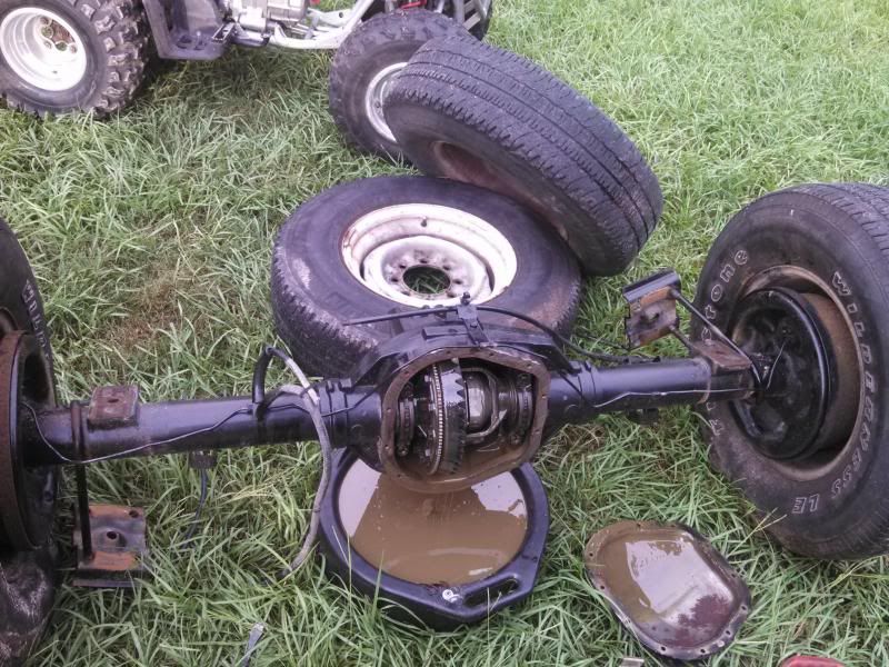

So I started disassembling and prepping the 8.8. The ring and pinion looked great so did the spiders.
Then I removed the brakes.
Began cutting the perches off and I got to the last one when it happend. I was rotating the axle over to get to the last perch and it fell off the jackstands. The pinion flange landed right on my ring finger causing 2 large lacerations and a compound fracture. Needless to say my build had come to a hault and my parts keep flowing in I plan to start it back up when my finger heals. I am trying to finish before Jeep Beach in April.
So while I have time to kill I would like some opinions. The leaf springs I bought used on CL. I don't know condition of them with weight but they are definitely old. I was trying to save money but I may just bite the bullet do it right and buy new springs. I have been doing a little reading on Waggy front springs. I like the idea of a 4" stretch with the added ride height. I am also considering new Oem, Re 1.5" SOA or Bds 2". I really only care to run 35s because I think 37's may be too much in the 30. Note that I have a 2" Buy right now they I want to get rid of, but I'm not sure how much I can once a clock the NP241 and raise the drive train up. Any thoughts? Thanks guys!
Note: my phone says my pics are too large to post so I will try to update this post to with pics as soon as possible.

Oh it did take a chunk of concrete. You can see the divot a couple of inches long. Running into the clean spot on the ground (that's where my hand was). Then I guess the other clean spot is where it slid off after it did it's carnage.
Here are some pics supposed to be in last post. Autoguide won't let me edit in.

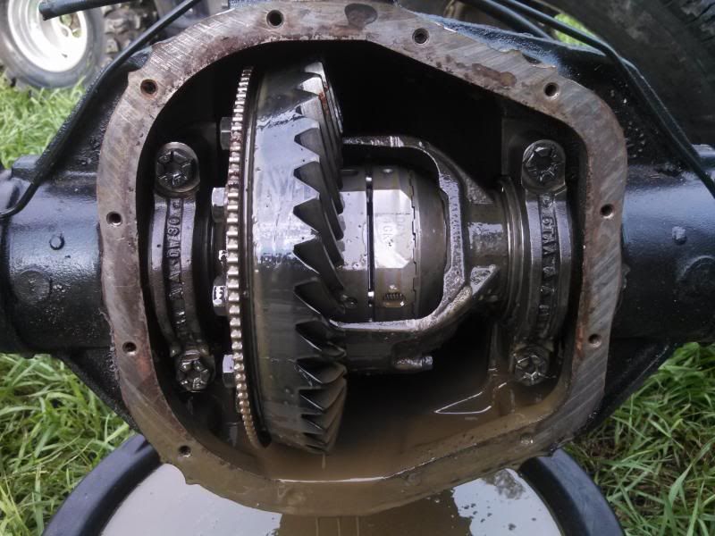

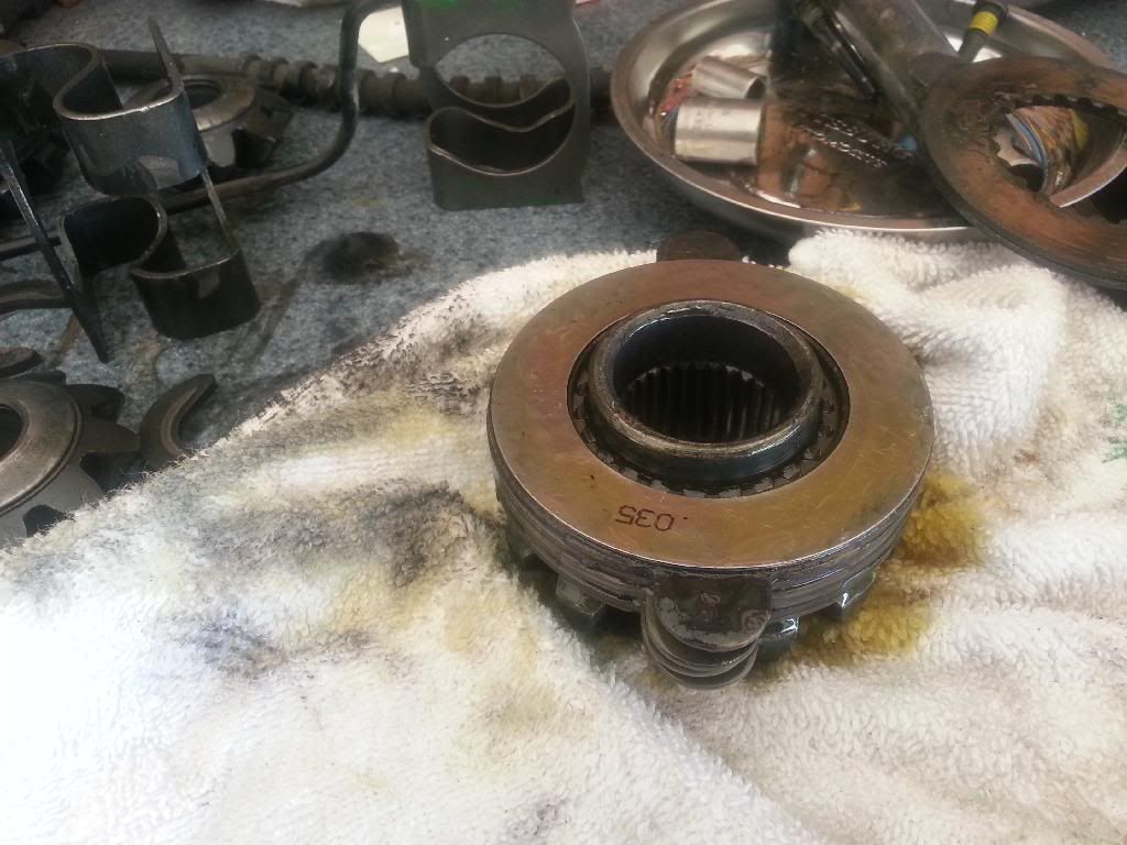

Put the new clutches in the LSD. I used a "performance" stacking. This uses 8 clutches instead of 6, so I had to reuse 2 old clutches.
While it is apart it's a good idea to replace bearings and seals. Notice the break in lube. I put some on the bearing so it will have some initial lubrication.

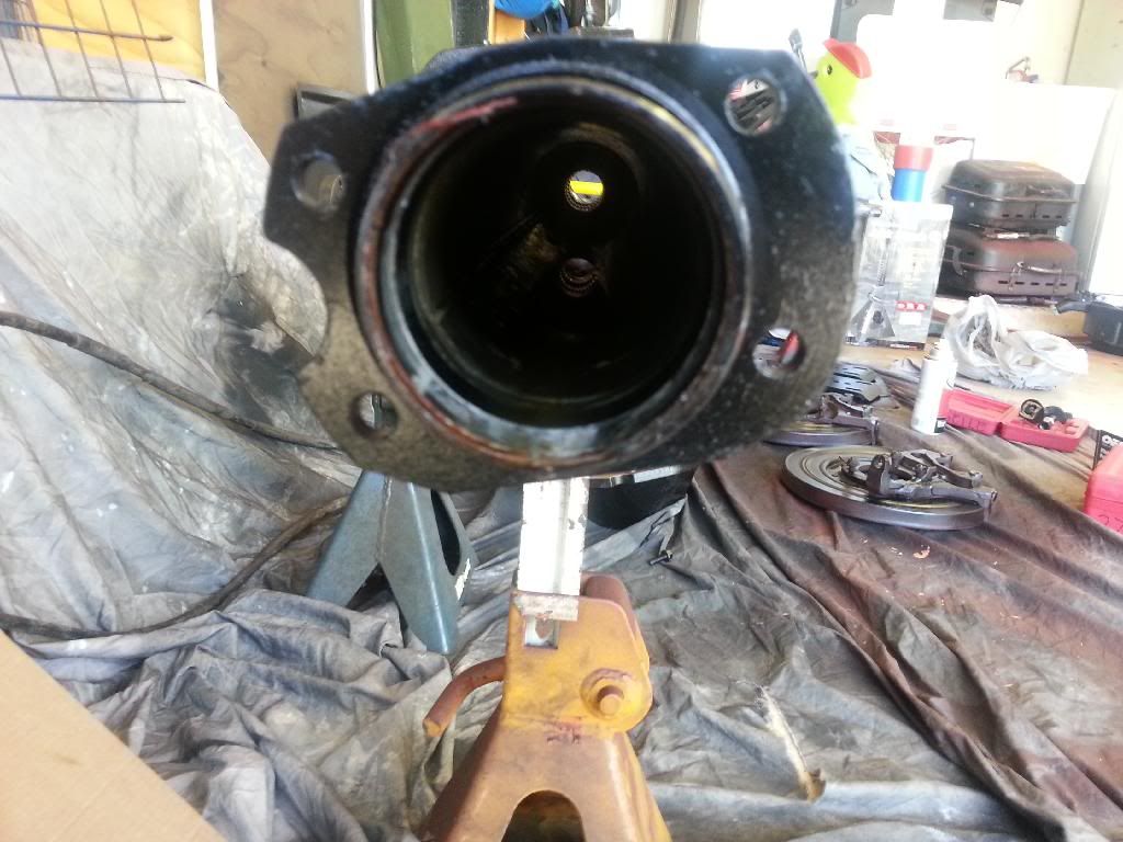

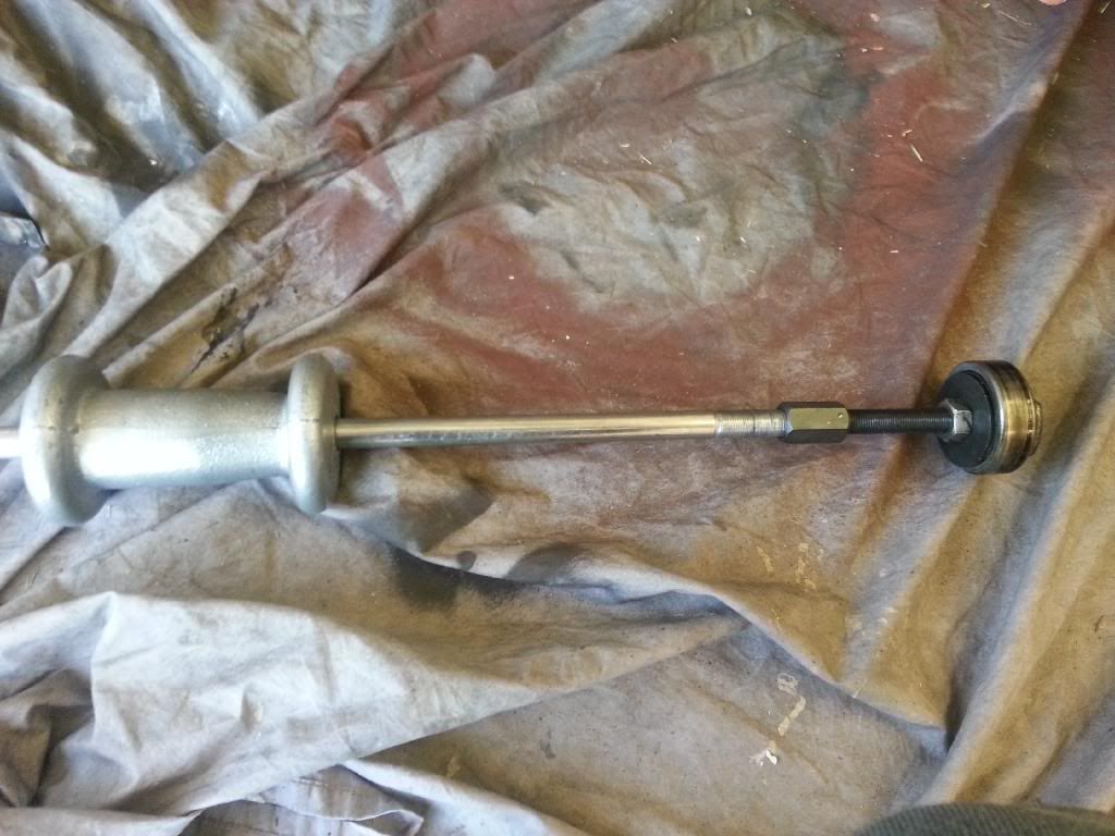

Used a slide hammer to remove the wheel bearings. Got to love autozone loaners.
Straight as an arrow.
Make sure to use a bearing/seal driver. Also throw some RTV around the seal before install

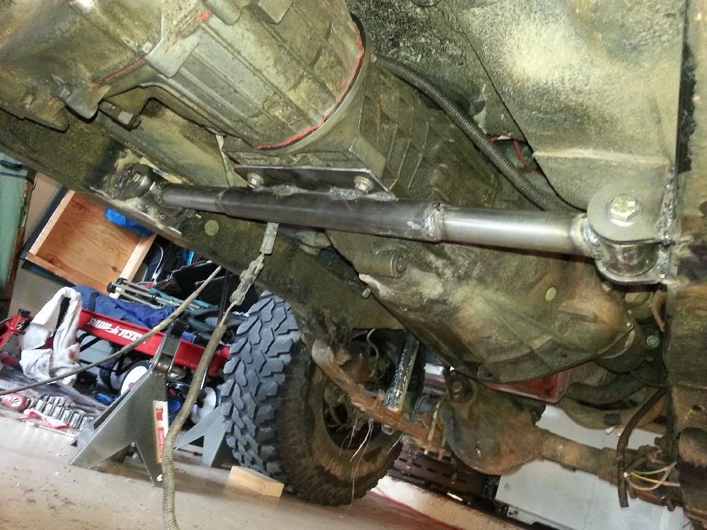

Did a little bit of work tonight after work. The crossmember is just about done. Once I trim and weld the driverside tabs on I can weld the tubes in place. I may also add a gusset on each side of the mounting flange for extra piece of mind. After that it will go to paint.
NEXT UP: 8.8 rear SOA swap. Oh yeah I got a little surprise today. You will find out next week. :twisted:

The crossmember is in and holding weight.
Dana 35 is no more!
Waiting on bushings and then the rear springs will go in and axle bolted up to get pinion angle... More to come.
