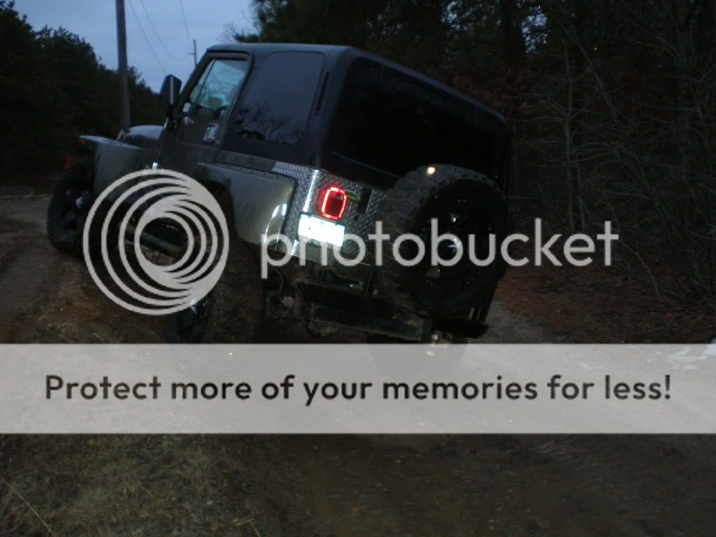

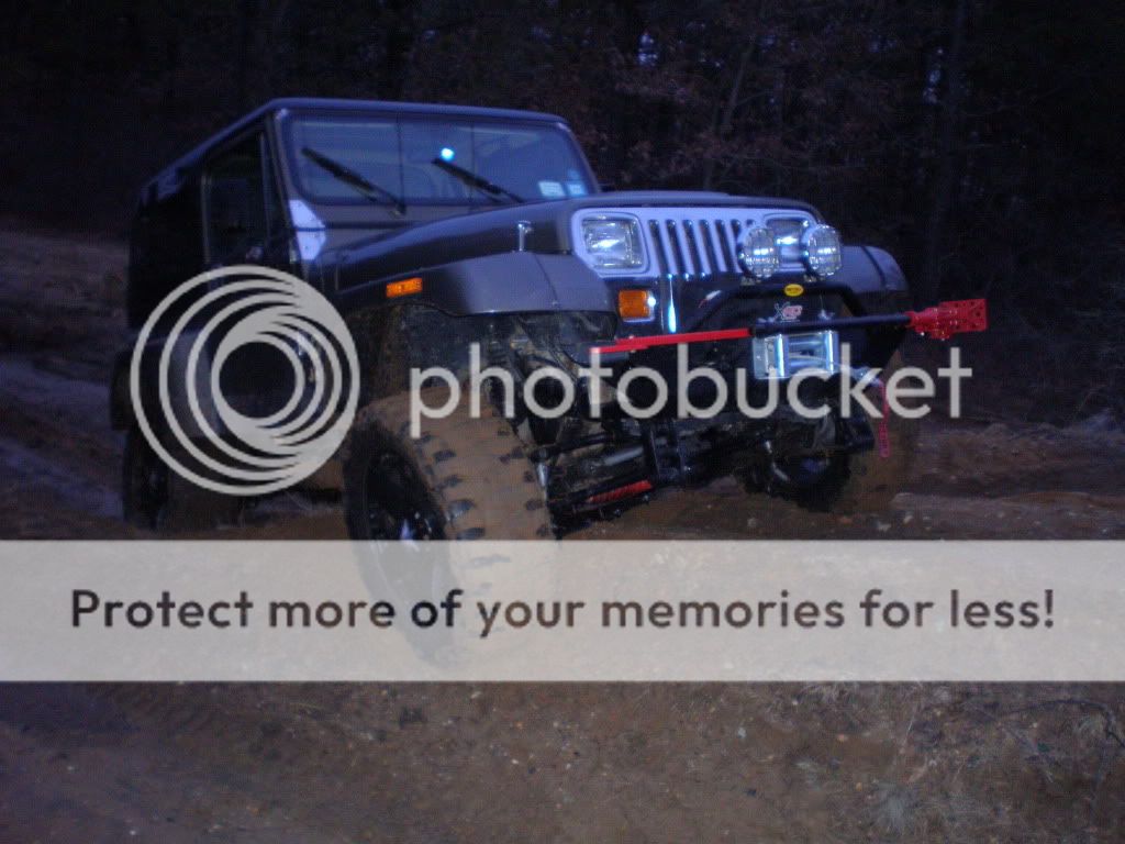

hello i have a 89yj sahara with 6.5 inch suspension lift 3 inch body and i feel like im not getting like any suspension travel most trucks they sway on / hills and i just turn on my side and get no travel i do not understand it sway bars are off and everything
i get ok travel in the back but just garbage in the front

it just like doesnt go past that in the front its rediculous i dont understand why maybe because i let mechanic make springs for me (dad made me) even know my front springs where better than these and i dont know if its the springs or something else that im not getting like any travel

Is your sway bar still connected? It kinda looks like it. Other than that, I would suggest retorquing the leaf bolts to 40-45 ft/lbs.

I agree it does look like the front sway bar is connected. If it is unbolt it and you will see a HUGE improvement in flex. If it is disconnected pull your shackle bushings and grease everything and re-torque the bolts with some good nylock nuts to 45 ft/lbs.

im sorry i was thinking of track bar not sway bars just realized what i said i designed them so offroad when truck is sitting level they slide back into eachother but when flexing they are able to pull out

like i see all these trucks getting crazy sway and the suspension keeping the truck straight but mine leans in what ever direction i go up the mountian at
