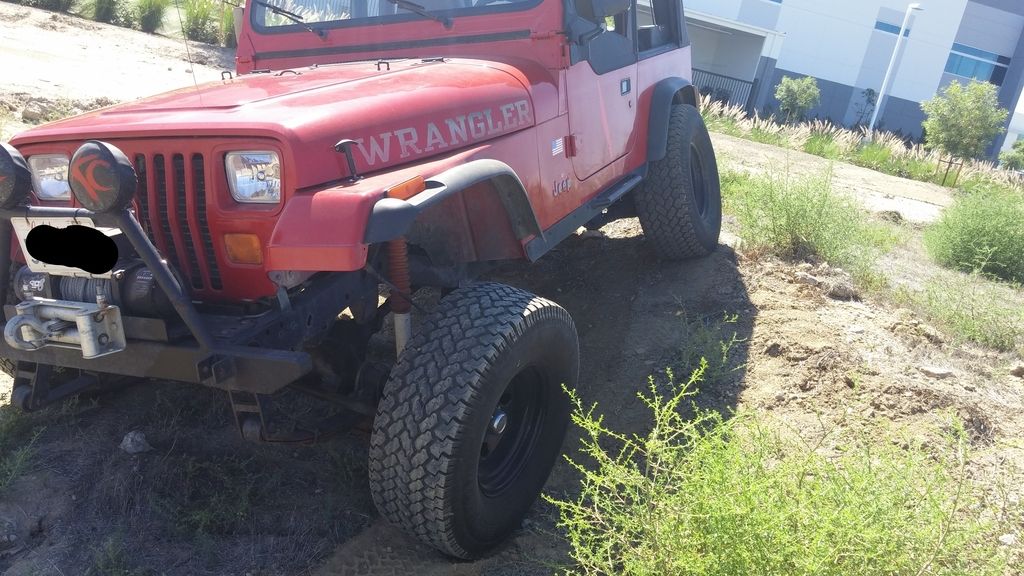

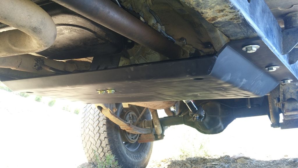

I installed the Barnes4WD 2" belly plate and I got the drive shaft in the mail and popped it on my jeep. Shoulda just got it with the sye as a deal but I was gonna do the XJ drive shaft thing but changed my mind. Anyhow hooked it up, took it for a spin to include 4x4 in a dirt lot and everything went well. The SYE worked, put in a poly trans mount which increased vibes a tad more on top of the polly motor mounts but it's ok I feel as one with the engine now
I know my pinon angle is off but even at 40 I barely notice an increase in vibes. Next move is dropping the 8.8 on there and this is not my DD.
I was concerned bout the front ds hitting the belly plate but it's ony a 1" difference and I'm only riding around 3" lift.
this is where it was sitting

Dont be afraid to notch the skid if you need to. Mine is cut to hell for my trans pan, exhaust, front driveshaft and rear of transfer case.

I had the cutter ready but yeah I tried to get the best droop possible and I still had almost 2" of clearance but I hear ya

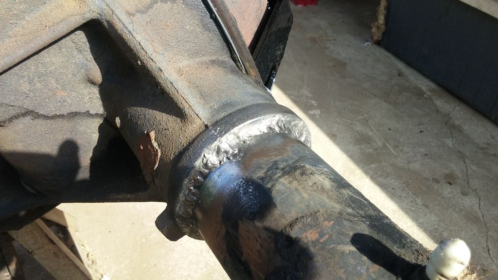

Booger welded the 8.8 today . I did opposite ends a little bit at a time then would let it cool.

Finished setting the pinion angle and welding the spring perches and shock mounts on the 8.8, filled the dif, had the rotors turned and installed new calipers and had my wifey help me bleed the lines. Doesn't sound like a lot but kicked my but all day. Didn't have time to test drive it and I have 2 full days of work so I can't wait. Next move is to throw the D30 in the front . BTW got some fancy u bolt plates from RuffStuff. I shoulda just got the whole set up but I had the u bolts already.
