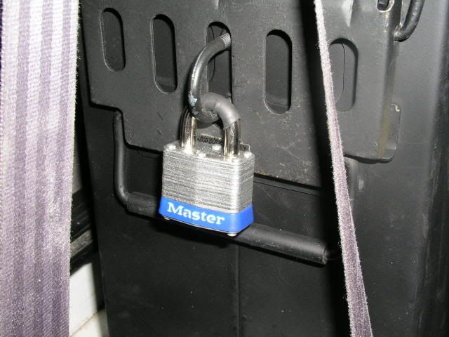

Originally Posted by jbolty
Also put one under the hood, on the old jack mount. Just used wingnuts here cuz I have a hood lock.
They will steal anything not nailed down in San Diego, so storage is a big deal. Not only did some low life steal the change out of my ashtray, they took the whole ashtray.
What ammo can did you use for that? I like that........
One step beyond................

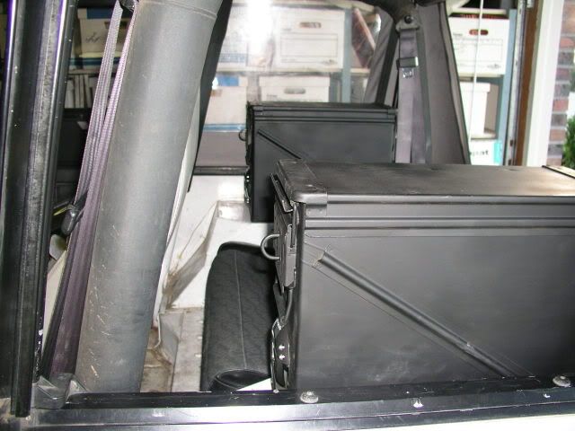

I think it's a 50cal. Measures about 6x6x12.
fyi. I stuck some velcro under the handle, so it would not rattle. And for the console box I squeezed a piece of heater hose under it for the same reason.
Those hood locks are not really secure but good enough for stashing my jumper cables and what not.
btw, left the jack mount in place but did saw off the tabs to make a flat surface.
jbolty is offline
The console one looks to be a 20mm the one under the hood looks more like....well never mind, just looked again, maybe it is a 50 cal.
console is 20mm for sure. perfect height.
The top has no hinge, so I cut off the back latch and welded the wire hoop to the back of the can for a hinge. The pop rivets in the picture are holding a strap that keeps the lid from going all the way back.

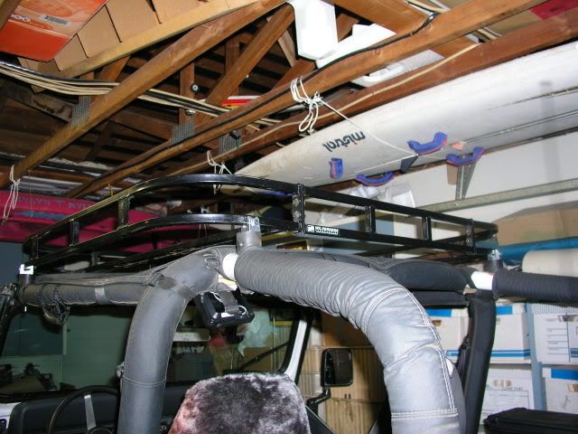

I made a LED dome light out of a cheapo Kragen light. It's so bright I need to wear a hat. About 32,000 MCD combined.
Used a Wilderness rack from a 4-Runner, and bolted it to the roll bars. I used some 2" BL mounts that I ground down to fit the roll bar, and some nifty clamps I found at Home Depot.
Also it fits under the garage door.

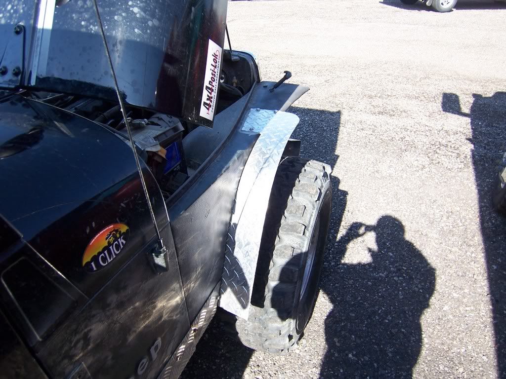

Homemade rocker guards for the YJ.
1/8" hot rolled, 2" wrap underneath the tub. $48 for the steel, about $6 or so for the hardware and silicone sealant.

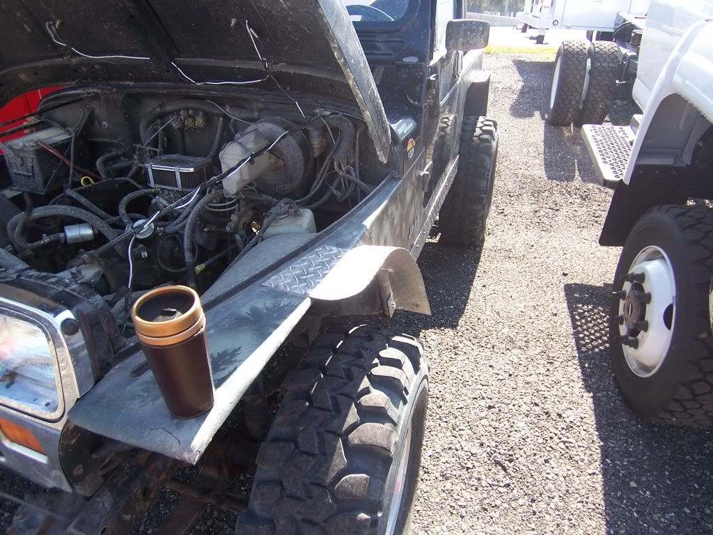

some fender flares, i made up..and the diamond plate rockers, I impressed how durable, they are rolled under in a complete square, and tuck under the lip of the body, quite strong.....
