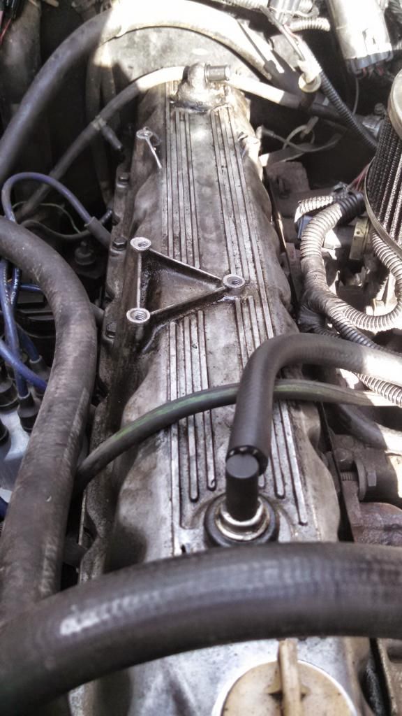

Update Most of the issues that remain with The TBI are due to the Injectors and fuel sending unit in the TBI. Also have a few exhaust leaks from removing all the vacuum, but that will be fixed later. It looks a lot less crazy without all the Pulsed air and Vacuum Lines. Removed all the actuators and anything unnecessary to the current setup of the jeep.

So a little Update. While I was working on the wiring harness I decided that I would clean things up a little. I have a few problems that remain with The TBI. One is that the fuel sending unit in the TBI needs to be replaced. I have a high pitched whistle indicating another issue and a low throaty gurgle from an exhaust leak I still have yet to cut and weld shut.
