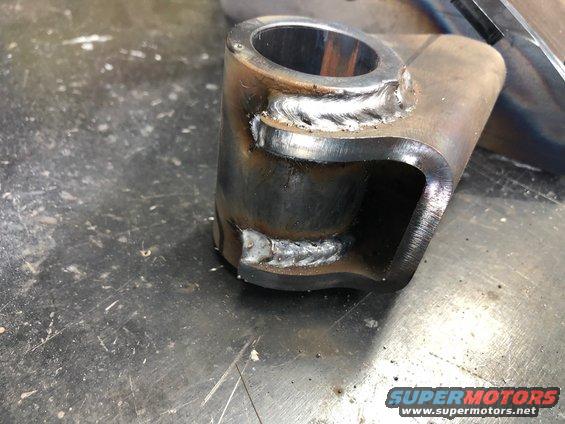

After a pretty fun wheeling trip, I took the YJ home and noticed my front-driver side shackle was a bit crooked. After taking a closer look, realized it was completely broken off. :frown2:
Here are some pics of the carnage:
I've never done like a repair like this before but I'm looking forward to taking it on. I could use help in planning it out. First off for a replacement part, should I just go for a straight replacement from Crown or aftermarket like MORE. Does any one have any experience with any of these or have any recommendations on which to go with?
Having never done this before, I'm guessing I cut off the old bracket and grind down till its about flush with the frame then weld on the new brackets?

Think you have the right idea. Cut the hanger off, grind up clean, measure, weld in.
The stock front shackle hangers aren't very strong, they were the easiest to cut off.

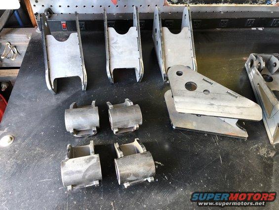

MORE, Barnes, RuffStuff bla bla bla, all will have a heavy duty upgrade.
I was going to suggest Motobilt. They make some super nice beefy replacement front shackle hangers pretty dang cheap. I'm using them front and rear on mine.
They also have some super nice heavy duty sprung hangers
...and the crown fit nice and are only like $25. Another cheapskate.
If you weld a small piece across the hanger between the bushing tube and the frame 'stock' hangers won't flex anymore and therefore become very unlikely to break. "Mass" of heavy duty hangers can cover oem sins but - like in this case - rigidity support works just as well.
Measure before you cut it off, then mark your measurement back 12" or so behind the hanger. Grind it smooth, check for cracks, put the new one up there, measure, clap, tack weld it, measure again then weld it solid. Done! I changed both of mine in under a hour using a high lift jack.

Obviously after the fact, but once upon a time Currie sold chrome moly YJ hangers. This is what I used way back when. But even if no one makes chromos any more I wouldn't sweat it. Most OEM hangers have lasted 20+ years and new replacements installed correctly should last longer. You're good. :smile2:

those frame end spring brackets are pretty cheap, I think I paid maybe $35 for a pair from amazon. I welded mine a couple times then eventually swapped on news ones just in time to stretch the frame an abandon them.
