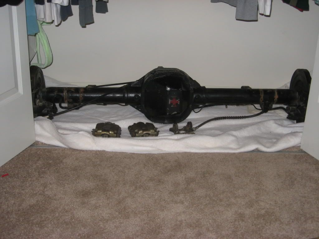

BamianYJ
Location: Ocala
Posts: 177
Good find!
I just got mine a few weeks back, it's going in when i do my spring-over. For the meantime it just sits in my closet in my room!
[IMG][/IMG]
93 YJ 2.5 AX5 NP231 33" BFG,8.8, 4.88s, SS SYE, SOA, OME 2.5", 1" BL, 5/8" Booms

i bet you carried it thru the garage to get it to the closet didn't ya???? j/k.... very unique axle storage there!!!

Posts: 177
Ha! I wish I even had a garage to carry it through. Being in an apartment doesn't leave me many choices as to where to keep a big 174lb axle!

i know how you feel!! at least tell me your on the first floor??? when i did my 8.8 swap, i had it on the deck of my 2nd floor apt..... swap day in the apt parking lot and nobody around to help me tote it down..... carried it thru the apt myself then drug it down the stairs.....
