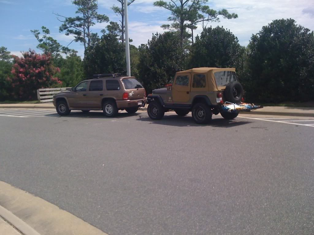

BTW, just got back from a week at OBX where I flat towed my YJ 6 hrs there and 5 hrs back with no probs at all.
Us at the rest stop near Manteo.
