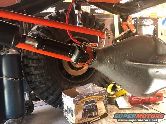

little by little. this weekend I welded the spring perches, torqued the u bolts, cut off the old shock towers and built new ones. Then cut off the back of the tub
gonna start on the rear shocks now. I guess there is a proper way to do it but I'm open to ideas. Meaning, lean forward or back and how much side tilt.
the fronts were pretty easy. straight up and down like the originals

Prob be the weekend before I get back to the rear shocks, in the meantime maybe I can get some thoughts.
the facts: I have a brand new set of bilsteins which I am using and had on the jeep last year with the 8..8. The rears are not that long because in the stock configuration they are on a pretty severe angle. They have about 10" total travel. I can have 6" up travel before the spring plate hits the frame, which is probably about the max I could expect with these springs anyway. According to my testing if i mount at about a 20 degree angle I can get my 6" up and about 5" down. I think this is good and should be enough. Also, I am going to mount inside the frame. Outboard can offer more travel, which I can't spare anyway and someday if I get new shocks I can swap it. Are there any flaws in this plan, keeping in mind I am not spending anything on this build. So far I have bought front calipers and a couple u joints. Everything else has come out of the scrap pile.
I got a set of fab tech shocks with the axles but they are blown , valved for the super duty weight and would cost about $400 to get set up, which is not happening. Maybe someone wants those.

I wouldn't sacrifice travel for anything short of tire/frame/body/axle interference. Is a couple hundred bucks in shocks worth hanging that tire in the air all of the time vs drooping far enough to get traction? Not to mention the stress that it will put on your shocks and mounts when that spring and axle want to keep moving. Do you plan to use limiting straps?
I used every bit of my 12" Bilsteins when I was SOA, about 5" up and 7" down, and now use all of my 14" ORIs, about 4.5" up and 9.5" down depending on where my ride height is set.
I don't disagree but the leaf springs only have so much travel. They only drop about 5" from ride height. I can be convinced to do it differently if there is really going to be a huge improvement but I probably need to drive it a little.

stock crown springs, zero lift. I forget the exact specifics but I think they are meant for a 1987 or older and have one extra leaf as those did back then originally. Only had them on for a couple trips but they flex surprisingly well and were cheap.
I could probably almost have no shocks at all for strictly crawling but there is always some overland getting to the trailhead.

but, got the drive shafts in. Using the original front for now, had to shorten a little.
Lucked out on the rear. Grabbed an extra Durango shaft from my parts pile and bolted it right in; exact correct length. Just had to swap on the flange for the axle end.

You definitely can’t run with no shocks at all. When I rolled mine out and took it down the street it was bouncy as all get out! No way would I want to hit a trail like that.

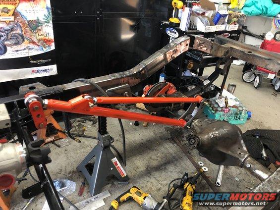

starting to think about the traction bar. planning to modify the one I had on the 8.8. I don't really know what the geometry is supposed to be on these tho. Originally it was angled about the same as the drive shaft but I don't know if that's by design or it was a coincidence. I'm going to look for some info on pirate but meantime feel free to chime in or post some pictures or ideas.
THX
jbolty is offline
post #75 of 98 Old 08-22-2020, 03:47 PM
92 Green YJ
92 Green YJ's Avatar
Join Date: Feb 2003
Location: Spring Valley, San Diego, CA
Posts: 4,422
Mine basically follows my driveshaft angle too.
