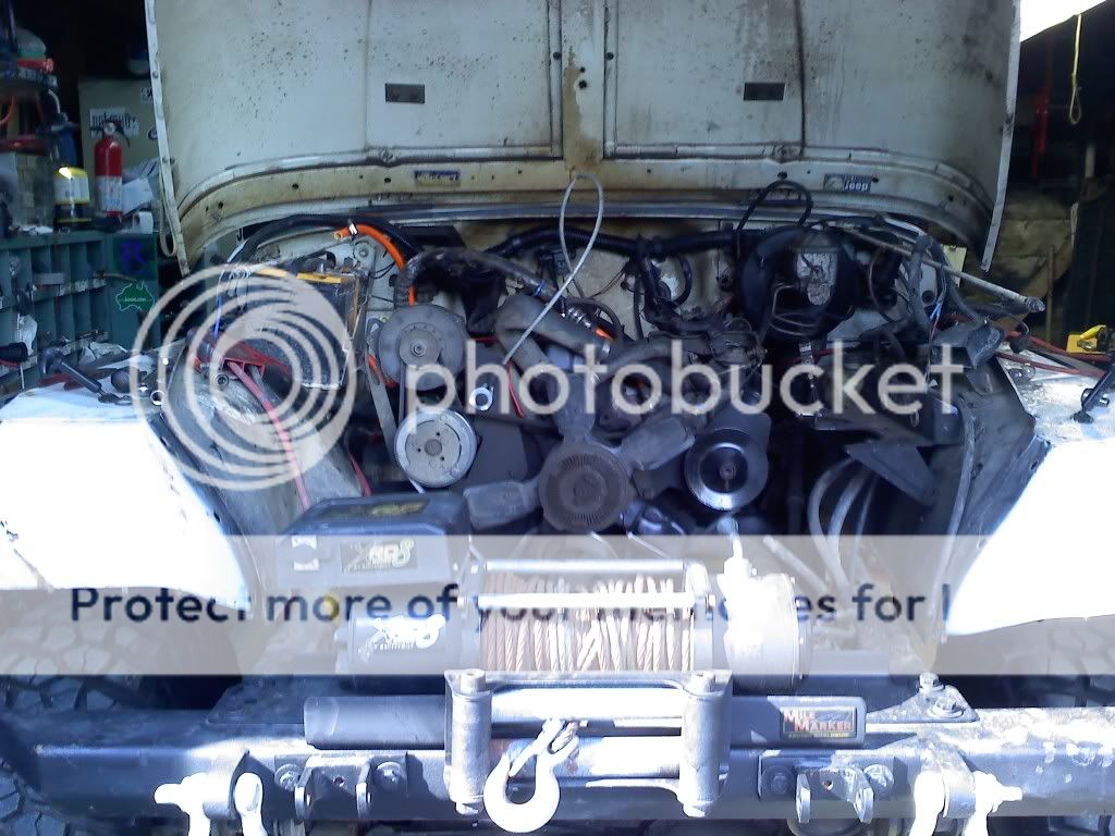

More progress today after work. Its nice that I get home at 4PM
Pulled the engine/trans and TC all as one.
Being SOA made it almost impossible. Good think I have a big hoist
Grill off and everything disconnected
Its up!
Its out !
Its Empty.

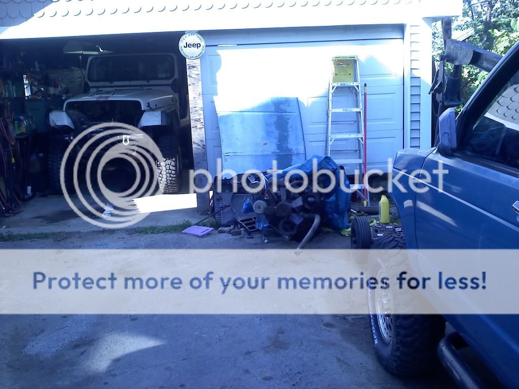

YJ is out of the garage.

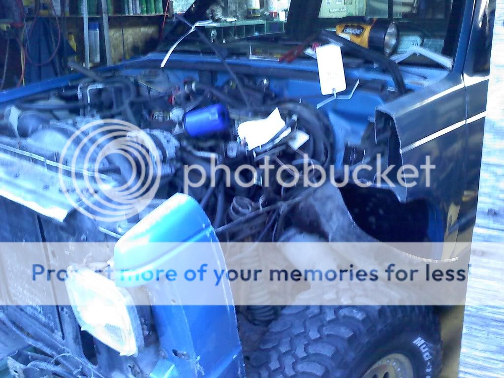

Drove the S10 again today to listen to the shift points. Parked it in the garage and took the hood off.
Crawled under the S10 and noticed the brand new looking exhaust system

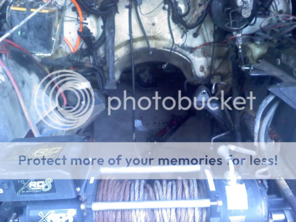

Wow !
The front body mounts fought me till the end !
I now have everything disconnected that should be and tagged as to where it goes. I left what I could on the motor and just disconnected what I had to from the fire wall

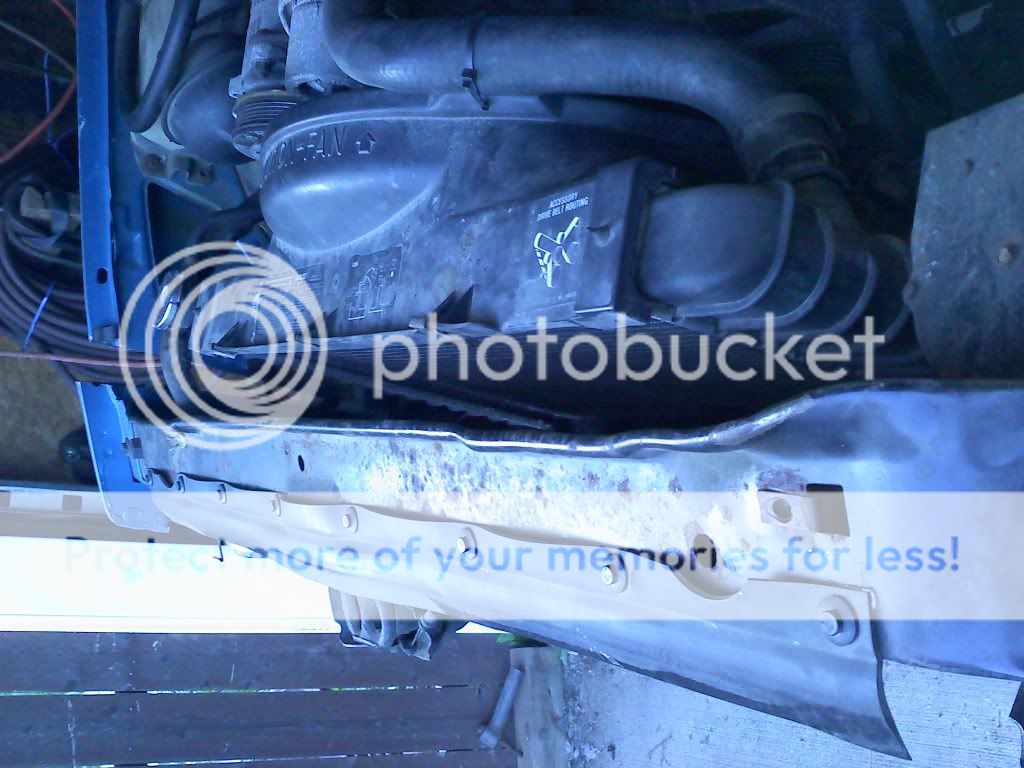

removing the radiator tomorrow. The front radiator ( it has AC ) is still on the grill. I plan on using the S10 rad in the jeep.
Tomorrow Im going to unbost the transfercase shifter. Now heres a problem, THe S10 is auto on the column. I somewho have to pull apart the steering column and get to the cable..
Where are the damn motor mounts???
I cant see them from above!
Tomorrow I will also pull the driveshafts and hopefully have everything out. Then the fuel pump.

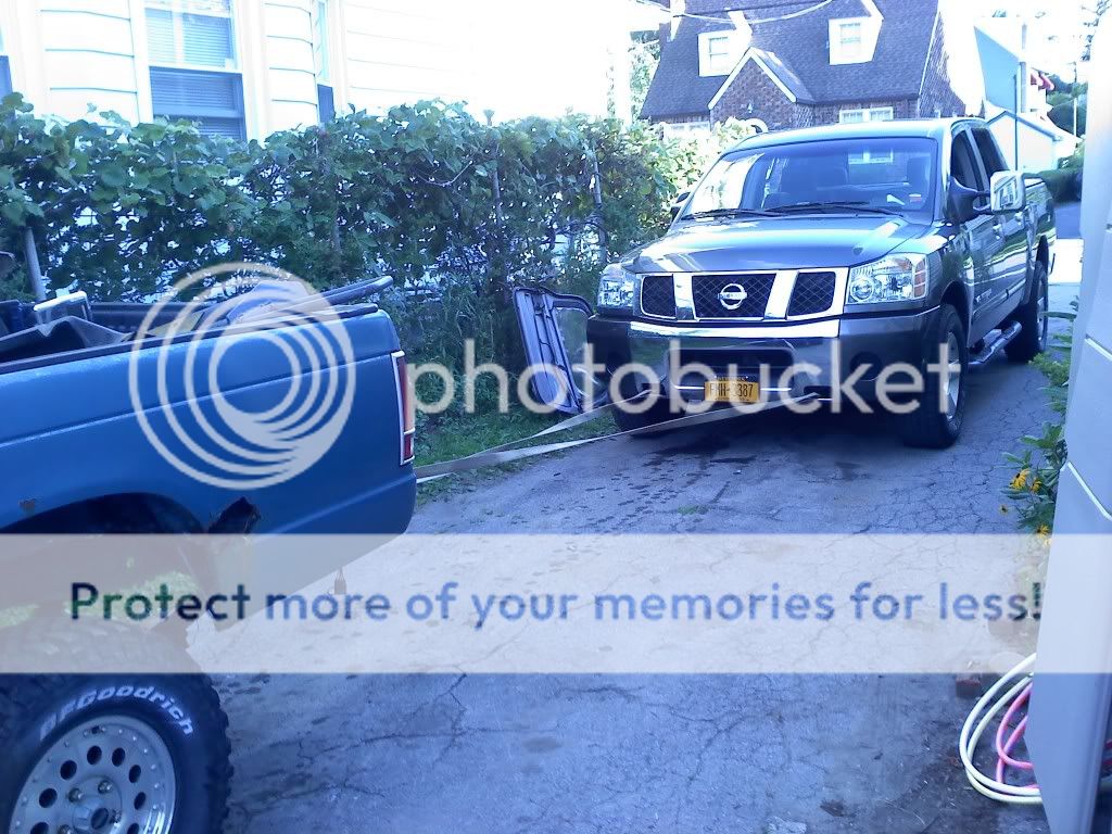

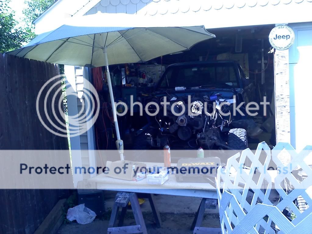

I guess I should have followed the advive of other S10 swap threads. I thought I could get by with out cutting the fire wall but it ended in failure.
I ended up cracking the dist cap. I also effed up the starter. I unbolted it to gain access to the motor mount but forgot to reinstall it, As I lifted the motor it got stuck and I had to undo the wireing. As I did that the connections got messed up on the starter.
As of now the motor is still stuck. Im trying to remove the engine,trans and TC together.
Camp
Pulling the S10 to pull the motor
Lots of stuff going on here
Tomorrow I am going to cut the S10 in half if I have to
My 2.5 to 4.3 swap thread
YJames90 is offline
post #14 of 1069 Old 07-15-2011, 09:14 PM
jonpin
Location: Melbourne
Posts: 33
Id like to see how this goes I know a guy with a similar truck and iv got a similar jeep....
jonpin is offline
post #15 of 1069 Old 07-16-2011, 03:39 AM Thread Starter
YJames90
YJames90's Avatar
Location: Dutchess County, NY
Posts: 7,025
Looks like I was over tired yesterday from doing the swap and not thinking everything through. I was laying in bed this morning at 5am and a thought came to me.
I forgot to disconnect the transfercase shifter!
I had to go outside and check. Sure enough its still connected.
This is why the motor was not moving!
Coffee then Im back out in the garage
