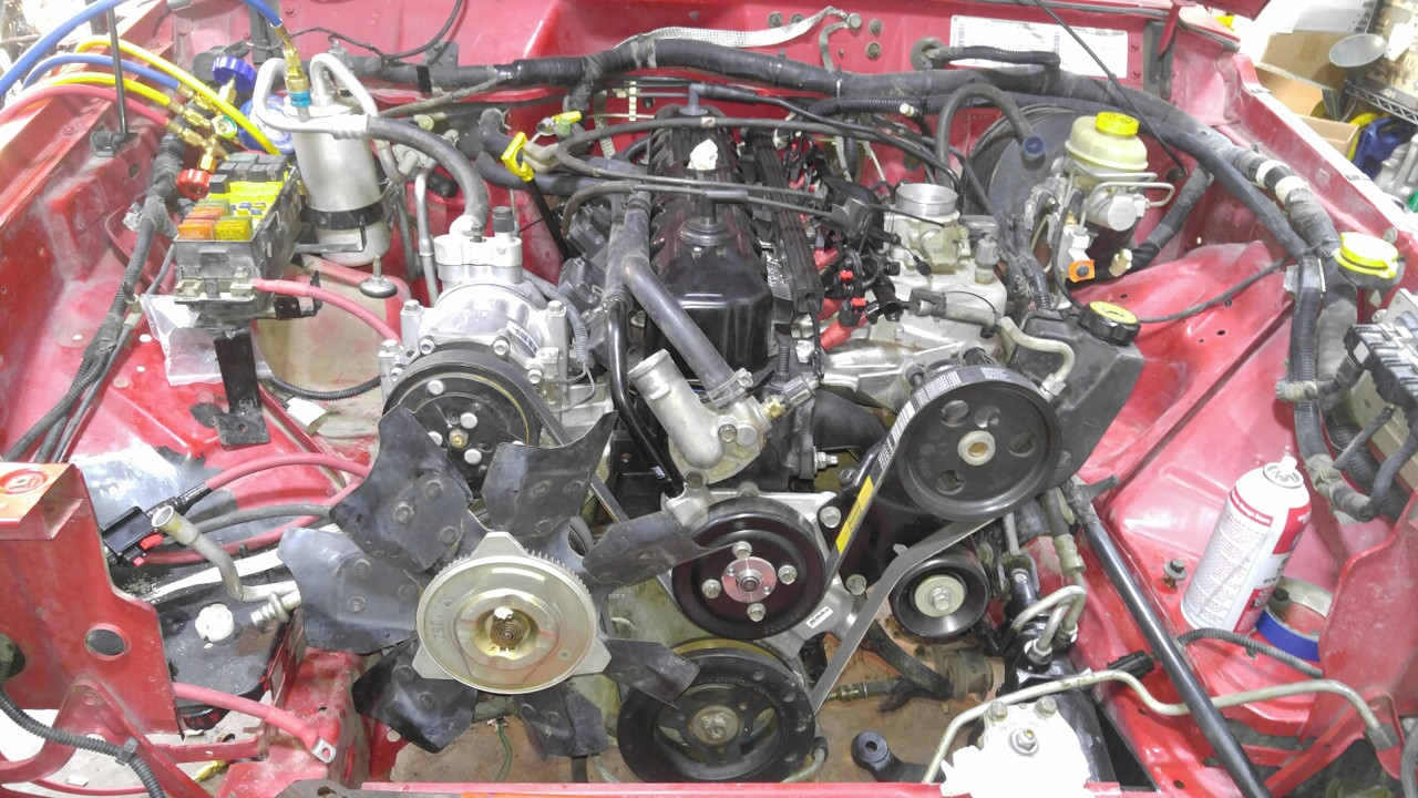

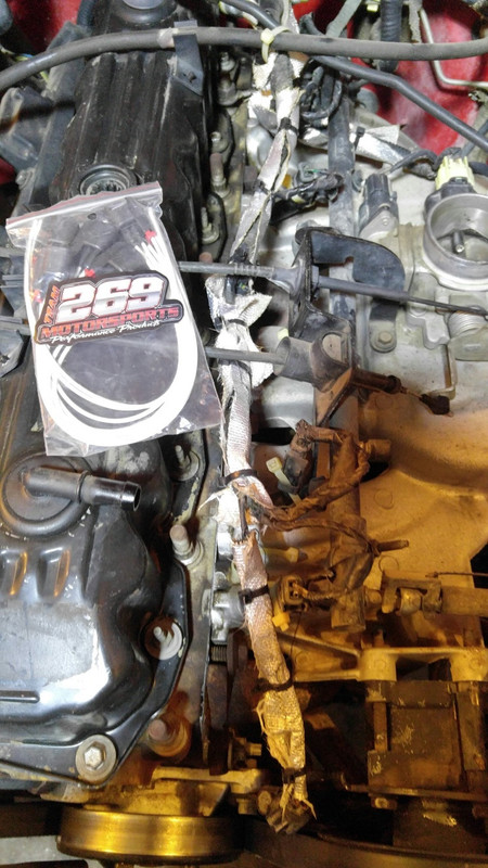

I bought 6 new connectors with pig tails for like 10 bucks for my idiot XJ
After install:
Wyo is offline

I see the price went up but this is what I bought.
I was impressed by the wire quality, that aircraft like teflon insulation and tinned wire.
https://www.amazon.com/gp/product/B0...?ie=UTF8&psc=1
Fuel Injector Connector Wiring Harness Kit Compatible with Wrangler JK TJ
Brand: 269 Motorsports
4.1 out of 5 stars 8 ratings
Price: $19.99
  • Fuel Injector Connector Wiring Harness Kit fits Wrangler JK TJ for Dodge/Jeep
See more product details
