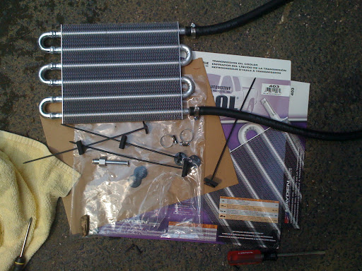

Alright, I got the cooler mounted and stuff, but I havn't hooked it up yet, I think I will get someone else to help, or find somebody that knows what they are doing. I also think I need an adapter kit for my jeep, as the instructions mentioned one for 1987+ jeeps.
It was really hot, for me atleast. I don't work well in 90* heat. I had a fan on me and no shirt, still dumping sweat.
What came in the box (I had already started before I took the picture, and the hose loops so that You don't cut until it is in place so you have enough)

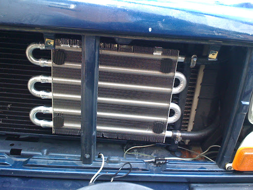

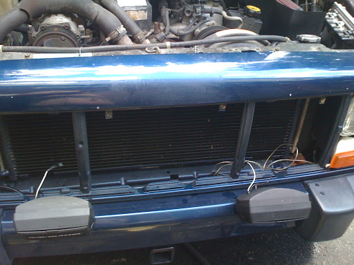

Grille Removed:
In position, I figured in front of the electric fan was as good as anyplace.
Clamp thingys, I had to trim them a bit more to get the fan back in.

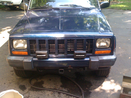

Together again.
The hoses are sitting next to the air intake right now. Sometime this week I will do it all. (the Logo is missing because I havn't put the new one on yet.. thats another thread)

i would think it'd be better closer to the primary fan? so it constantly is cooling? i could be wrong but wouldn't that be a better place for it?
wyojeep92 is offline
post #7 of 45 Old 06-17-2009, 05:26 PM
justanotherjpr
justanotherjpr's Avatar
Posts: 6,319
He has it in the stock position. It is cooled pretty well because it is the first thing the air hits.
